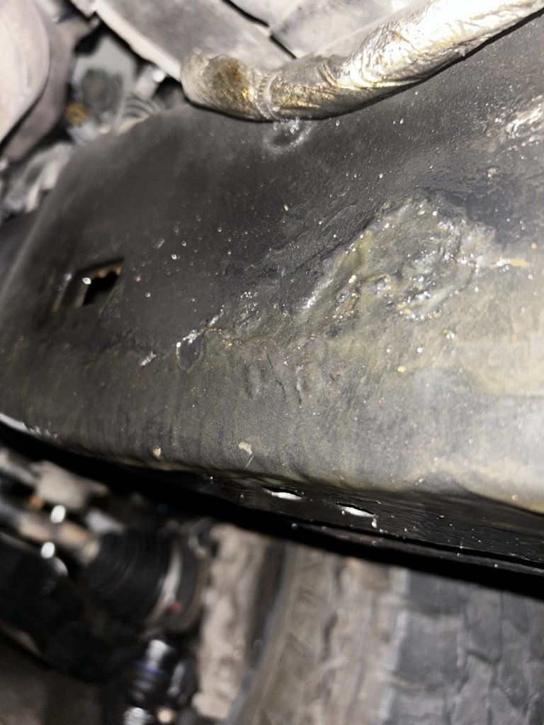

  18. Feb 7, 2025 at 8:30 PM
    #38
    Owenhall
    Owenhall [OP] Well-Known Member
    May 9, 2024
    #449480
    287
    Owen
    2009 Toyota Tacoma 4x4
    Lift 33s
    Anything I should do about this part ? Almost seems like it is cracking it’s solid if you hit it with a hammer
  19. Feb 8, 2025 at 11:02 AM
    #39
    Monkeybutt2000
    Monkeybutt2000 Well-Known Member
    Mar 5, 2015
    #150217
    795
    Take a heat gun,get that rubberized coating hot and scrape it off. Has this truck spent it's whole life in Aizona?
  20. Feb 8, 2025 at 11:03 AM
    #40
    Owenhall
    May 9, 2024
    #449480
    287
    Owen
    Lift 33s
    No came from Montana/ Idaho
