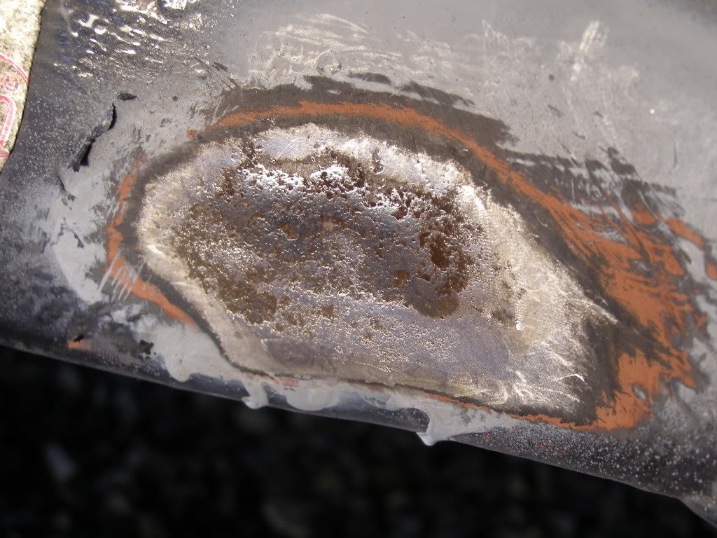

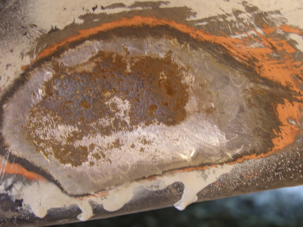

    Well I investigated bubble that I found doing wheel bearing last week. Turns out its not simple surface rust. Its frame rusting through inside. Picture says all. Its not official hole yet but it will be soon.
    On the pic you can see area where rust is coming out, surrounding metal is nice and even, rusted metal is all pitted. I painted that spot few times and cleaned but its just keeps coming out. Now short of taking grinder I can not remove rust because its rusted through. I took pictures and will be calling Toyota corp on Monday. But my 2gen officialy had joined my 1gen in crap frame fest.. :mad:

    Don't forget where you live man... a little 5 dollar can of undercoating probably would have kept this from ever happening. Can't blame it on all Toyota if you ask me. I'd hope they'll take care of you though. Rust cannot happen if it doesn't have oxygen.

    No offense but $5 can of undercoating is only good as substitute for KY ..:rolleyes:
    Look at my frame I have multiple coats of paint. Look at metal surrounding it, it does not even have surface rust, so what I painted works excellent. However this is rusting from within the metal. Maybe due to some different metal embedded into the frame. Who knows but this is nto surface rust hence no amount of undercoating or painting is going to help here. The only way to fix it is to grind the thing and fill the hole with new metal. But then Toyota is going to wash their hands.
    Not sure what to do, should I paint it or leave it like that and go to dealer. :confused:

    I'd at least take it to the dealer and have it documented for future

    You can ONLY BLAME TOYOTA.that rust is coming from underneath the paint so undercoating isn't going to help.It is only an 07 not a1940. Why didn't they fix this problem with the 2nd gens when they knew it from 1st gens? My 08 was really really bad.

    Rust cannot exist without oxygen. FACT. Iron Oxide, its in the name.
    So if you are to blame it on toyota, then you are saying the stock paint is not good enough. It is your responsibility to maintain the truck. Blast, sand, rough it up, whatever, then prep and paint. I've been doing it on mine every year now. Takes very little time utilizing the rattle can method. I always get a little rust around the seams at the end of a year, but certainly nothing major! Its periodic maintenance. Rust happens.
    You can't stand around, watching your truck rust before your eyes then blame it on someone else. I'm not trying to get in a pissing match here but shit like this bugs me, especially the New Englanders, look where the hell you live. Its worse than me driving on the beach EVERYDAY.

    The stock frame paint is NOT good enough - FACT
    My 09's frame was covered in rust after one winter , chunks of paint falling off after 2

    kinda looks like the paint you've been applying might be holding water. get some POR-15 and be done with it

    He owns an 07, thats nearly 5 years old now. If I had a nickel for everytime I heard a rant about 'toyotas shit paint job' or 'fords paint peeling' or any other company for that matter I'd be rich by now. I do not dispute that the paint on the frames sucks, but any monkey with a wrench can look under his truck the next time he changes his oil and inspect for any spots that may need preventative maintenance. I do it EVERY TIME I do an oil change.
    A bubble in the paint of that magnitude could have been caught probably a year before, and it would have never been a serious issue.
