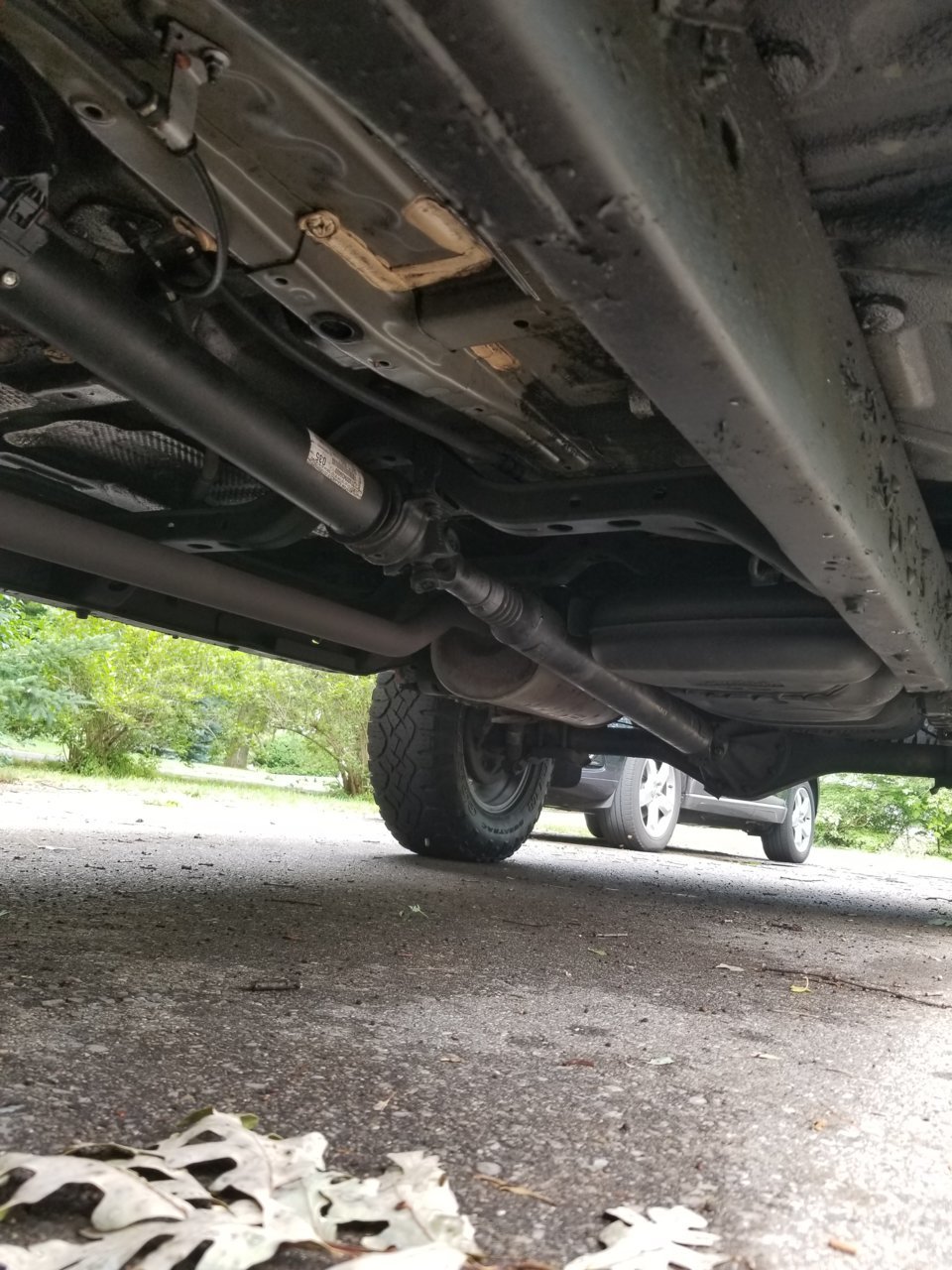

    Here’s what mine looked like when they were done. If you don’t get it done and your frame rusts through within 12 years of the in service date then Toyota won’t replace it.D8FDA02B-8FE6-4C1B-8675-1CA6DD951CAA.jpg31214F13-E1F9-4098-93C3-C494B0DF8B54.jpg 757C0BE8-1177-4257-B714-CC4F6DAFD159.jpg

    Had mine done a couple of weeks ago, they kept it overnight as they cleaned around where they put the treatment and had to let it dry. Drilled a couple of holes in the frame and put some plastic guards and plugs in it too. Put me in a 70 grand tundra for a rental. Now just have to fluid film the rest of the frame before winter.

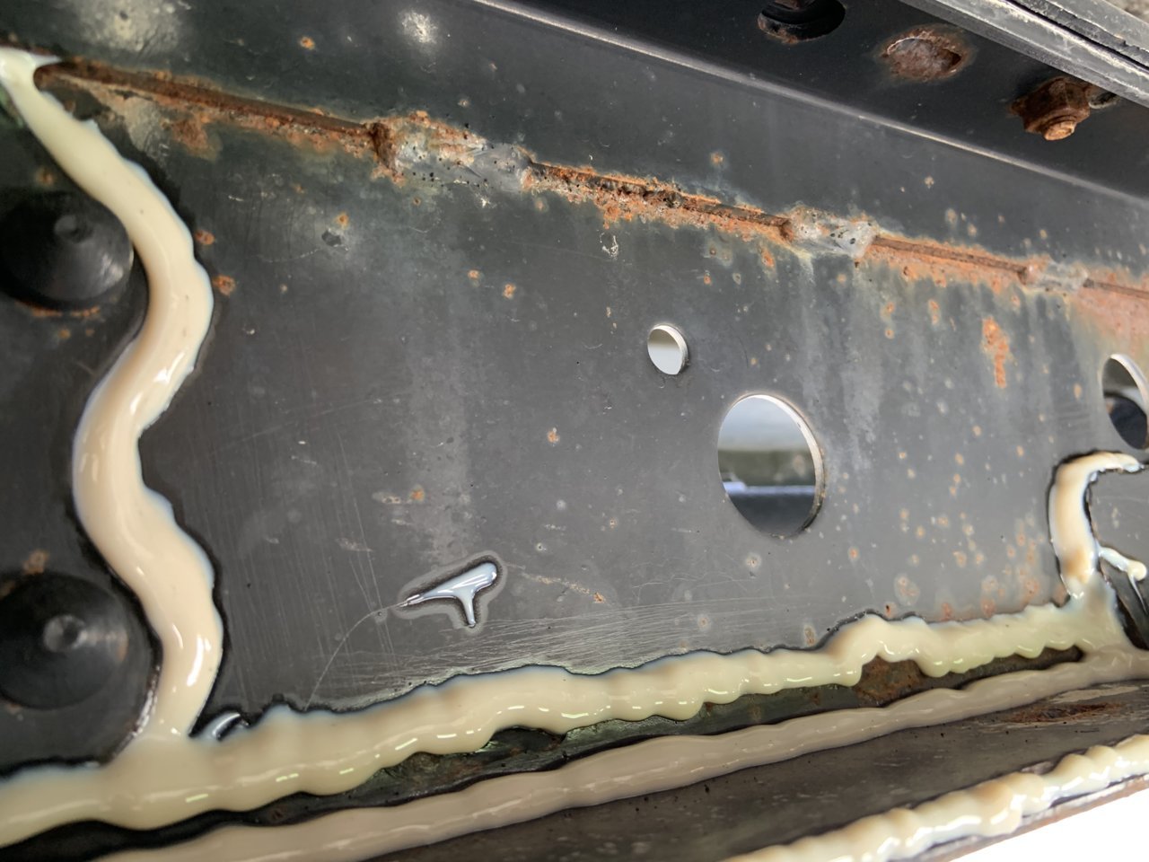

    Wow...that's way different than what they did to mine in MA.
    Before
    AFTER
    And now it's back to the "BEFORE" look ;)

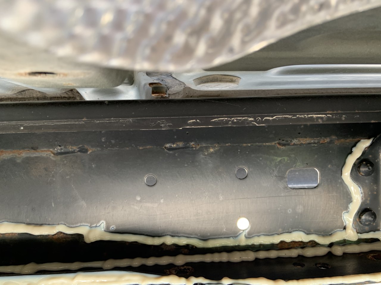

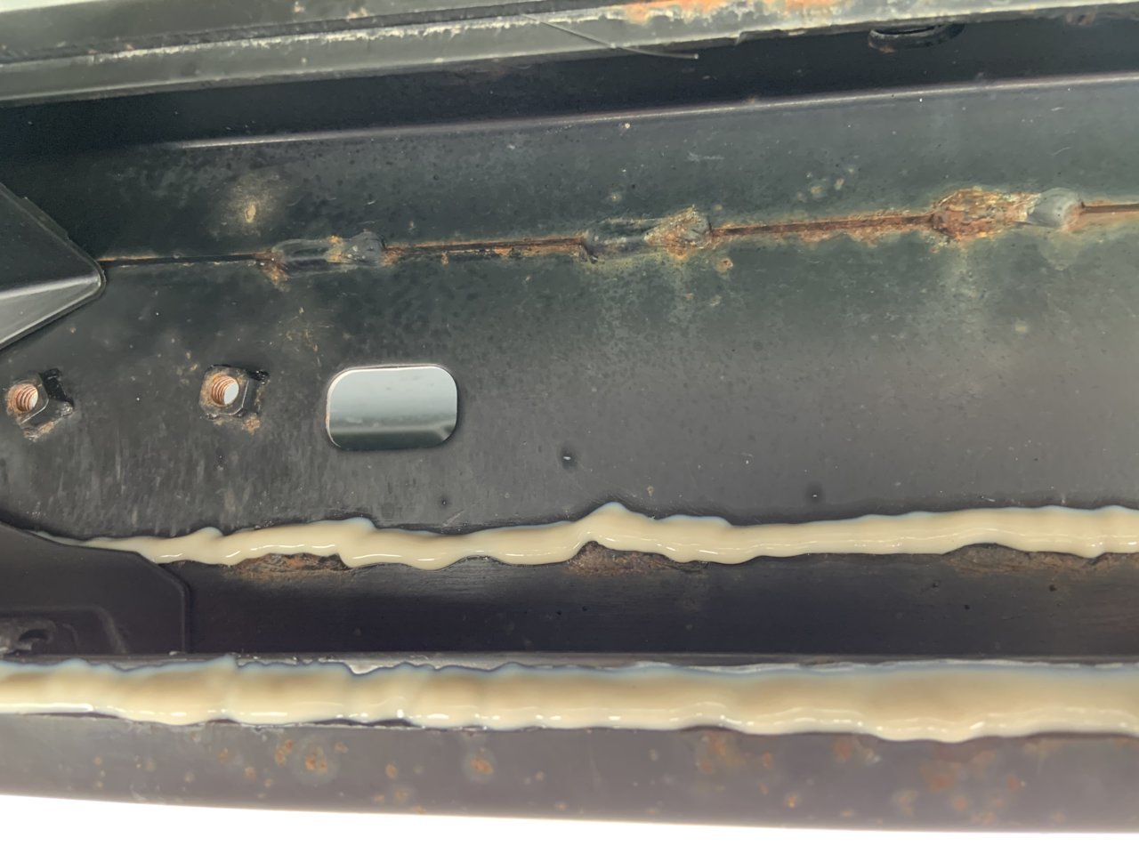

    Had mine done in MA a few weeks back.
    Looked like this only WAY MORE GOOP inside frame and evidence of pre-cleaner. They had my truck for 2 weeks but gave me a brand new fully loaded $55K Highlander hybrid loaner (tried sticking me with a camry but wasnt happening).
    Tech I dealt with was great and explained everything to me, then gave me some pointers on doing the brake job myself with all OE parts and I REALLY appreciated that a few days later.
    Said they clean frame w/ one product, then do an inspection after it dries. If it passes inspection they do a 2 step process that includes a pre-treatment then that goop in the known trouble spots.
