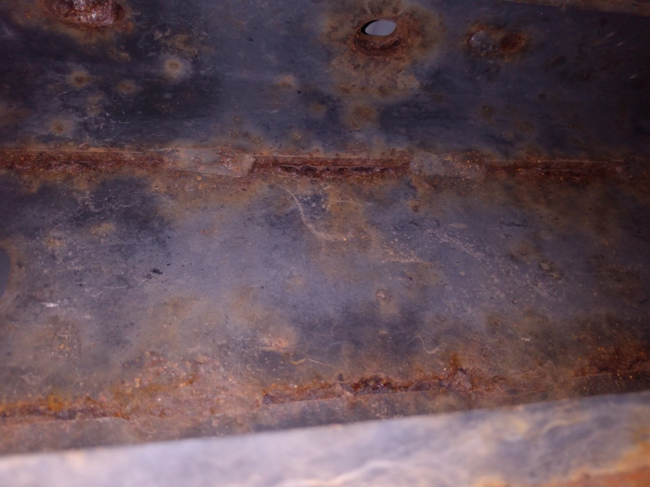

    Anyone with a 2007 Taco had their frame replaced under warranty recently?
    According to article it listed 2005-2010 models have 12-15 years for coverage but does not state which model years are 12 or 15 years.

    2007 is no longer within warranty coverage. It is 12 years.
    Your options are patch plates, buy a frame out of pocket, or get rid of the truck.

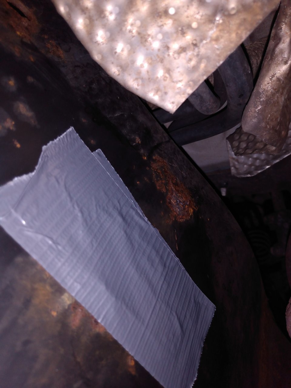

    I tried to cover it with some duck tape where it was bad. Also the holes that are built into frame around where upper CATs are taped over those to try to not allow water to get in.
    Around the upper CATs where frame bends down is where it is usually the worst right?

    Personally, I would've went with the stronger gorilla duct tape.

    Well you know still going through some R&D first.
    I know the seam welds that run the length will still get water in between.
    But really guys if I tape up the bottom how can water get in around the weird bend area near upper CATs.
    Or couldn't i just use that foam stuff they sell at hardware store that expands to fill up empty space?

    None of those "fixes" are going to add back the strength that was lost as the metal corroded. Taping over the rust so you can't see it doesn't fix anything nor does it stop rust from continuing. Filling the box sections with spray foam will not stop rust that has already started. Remember, as the frame continues to corrode, it continues to lose strength. Sooner or later you will have a major safety issue on your hands. And you may not find out how serious it is until you have an accident - and your truck folds up like a piece of paper.

    Ok but will taping over holes that were already there (those not formed by rust) keep more water from getting up in the section by the Upper CATs?
    Im trying to at least slow it down and prevent more water from getting up in there.
    From the factory the thing has at least 2 holes directly to across from tranny and also a hole in the bottom.
    Why someone would design frame this way is beyond me.

    Unfortunately, the only thing that can slow down (not stop) corrosion that has already started is the total elimination of oxygen. As you might guess, that's pretty much impossible to do. Plugging off holes in the frame might actually accelerate corrosion since it will trap moisture in there. Remember, it's not just water splashing up in there that causes problems. Condensation is also an issue.
    The best thing you can do is Fluid Film the living crap out of the areas.
