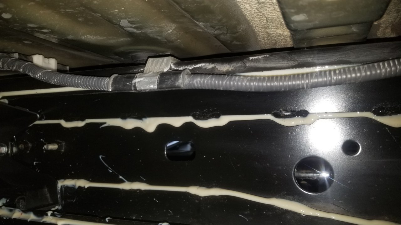

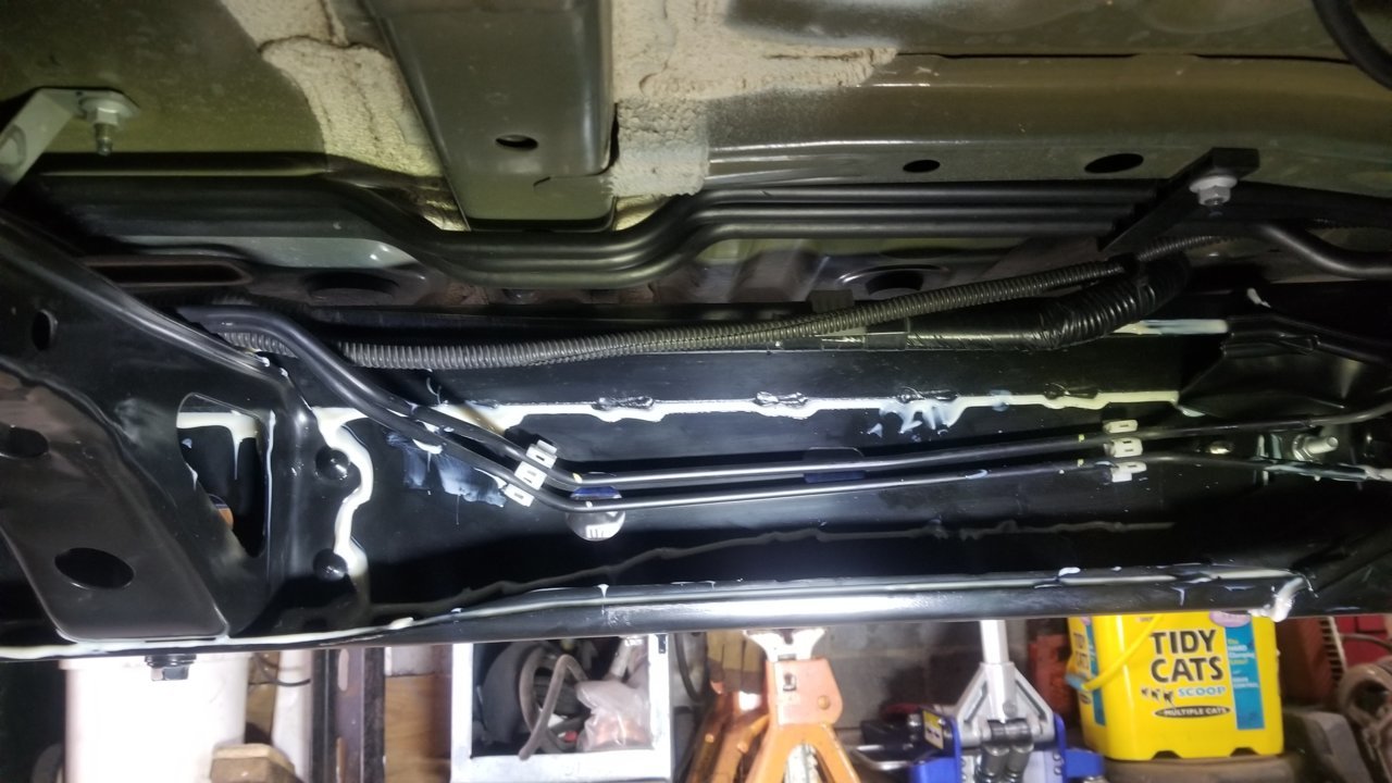

    14 DBLC / Sport / Blue Ribbon Metalic
    Weathertech mats and wind deflectors, Bak Flip cover, CB Radio,Clazzio seat covers,Scan gauge,Uni filter,LED interior lights, Redline hood struts
    Picked up truck this morning, preliminary inspection it looks like they did a good / neat job. Will try to find time tomorrow and do a thorough inspection and take some pics. I dropped it off Thursday morning at 9:45 and they called Friday around 4pm and said it was ready. I was given a 2020 Corolla to drive.

    Stuff is still really wet, was sprayed 3 days ago. Tempted to wipe off the excess wax.

    Wow your frame/undercarriage looks clean. Do you drive that thing? Mine looks ancient in comparison.

    Not much, 33,000 and never seen a snowy or salted road. Garage queen most of the time.
