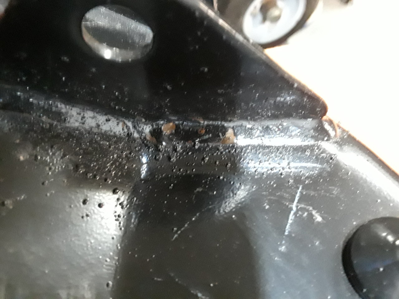

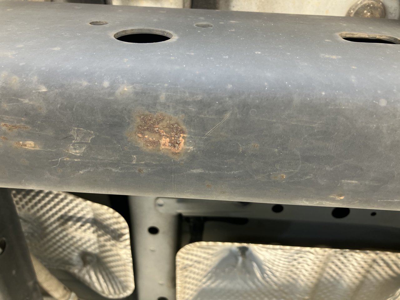

    Here are some representative examples of the areas I wanted to treat:
    5DB39CB5-E6D0-425C-849A-EB74F49D6D4C.jpg D0F8C4C8-8FA3-4D6E-ACBA-3DDC926CC982.jpg 0DFE0CF8-C079-45A2-A8BD-6607F7DF0DB9.jpg BA05EE16-72CD-4EFC-ACD9-ED5141A8677E.jpg

    Regardless off the amount of rust ( yours is minor) you should protect the frame. Lube up the bare metal with some wool wax. Nothing else needed.

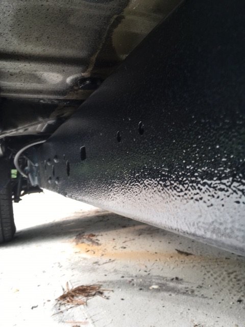

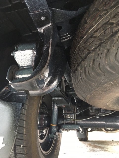

    Here’s a 2015 always maintained with woolwax in a salt state.

    Thanks, I started do this the day I brought in home from the dealer with 12 miles on the clock. I won’t lie it was hard to spray a brand new frame with some wet stuff I never used before. But now I can honestly say is the best thing I could have ever done to prevent corrosion. I also live 1/2 mile form the ocean and a marine environment along with salt roads in the winter is a short life for most Toyota’s.

    Pretty incredible, speaks volumes about these products (fluid film, woolwax, surface shield)... Hope more people considering undercoating see that instead of the rubber ziebart crap.

    Other than the frame what did you spray? Looks like everything. Nicely done!
  10. Apr 15, 2023 at 12:43 PM
    #30
    spitdog
    spitdog Well-Known Member
    Sep 2, 2014
    #137440
    4,003
    2015 Access Cab V6 4x4 SR5 MGM
    I lowered the spare and sprayed that area real good. I also sprayed inside the frame rails up where the cab mounts are. I sprayed everything except the exhaust system, even though some did get on the exhaust, it will just burn off. I use a compressor set at 100 psi and undercoating gun. You can also buy spray cans if you don’t have a compressor.

    I recommend the WoolWax kit that comes with 4 (reusable) jars and the gun with the correct nozzle already on it. I've done my frame twice, another Taco and a 4runner and still have 2 jars left. When they run out, I'll start buying by the gallon.
    Put the jar in a pot of hot water for 5-10 minutes before you spray, it thins just a little and gets into crevices a little better, such as the sandwiched portions of the frame and where cross members meet the long sections.
    As for that small surface rust, wire wheel it, rattlecan it, then WoolWax the whole frame.
