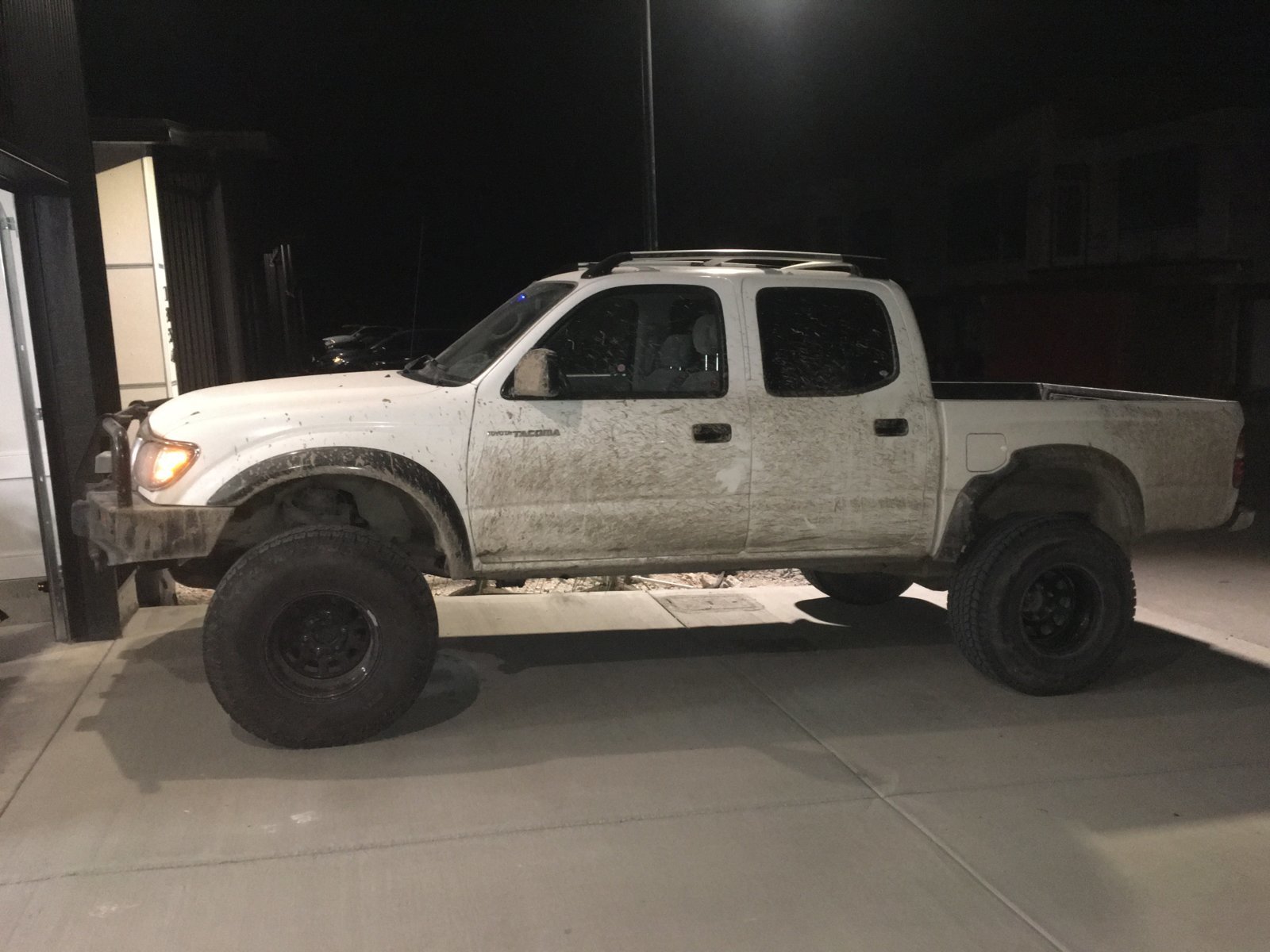

    Hi all. So the opportunity has come up for me to swap my tacoma onto a different frame as mine is rusting out (you know how it goes). I have been scouring the internet for the past while now and haven't found any real tips or experiences on other people doing this. I've seen a few compilations of people doing speed swaps but I am looking to do it myself and not really sure if this is a stupid idea or if I am just ignorant. I have seen people do the cab lift and leave the engine on the frame and just swap them that way, however I can't find any "how to's" for that method.
    Just looking for some people with tips and tricks and experience really to share.
    (I know you're all curious so heres my rig, its the white one)

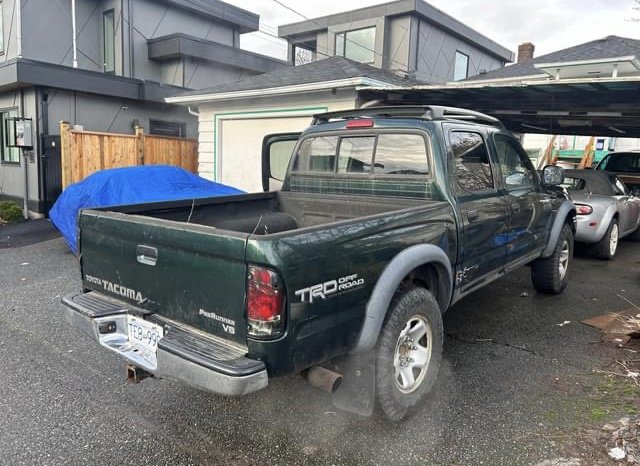

    P.S: I included a picture of the parts truck (Green TRD) just so you could know that it is a salvage title with a slight crunch in the drivers side door/floor panel. The owner did say that the frame is untouched however.

    You have inspected the donor truck ?? Might it just be less work to fix and put the green Truck on the road?

    Unfortunately, I did not end up getting the truck as the frame was worse condition than mine. Apologies.
