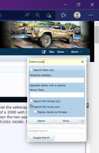

    Can you post some pics of the underbody?
    You can use the search at the top right. There are several other 1st gen members doing swaps right now and posting updates. There are many threads from others doing the same.

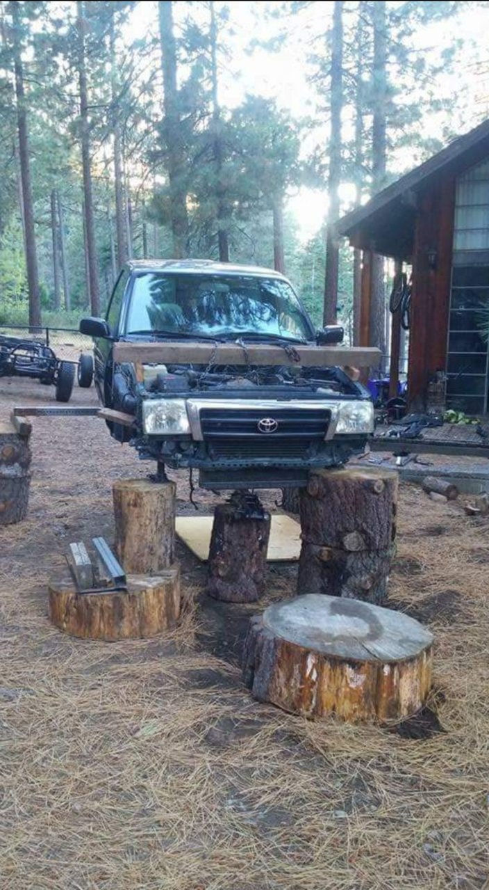

    Any year frame will work. The 95.5 to 97s have shorter rear springs. The 98 to 2000 frames have a 2ish inch longer frame horns (not a big deal)
    If you go with a automatic transmission frame you will need to move the trans cross member or make fabricate your own. If it's a v6 frame you will have to move the motor mounts. Other than that you should be good to go.
    I also highly recommend lifting the cab and motor together. There is a lot less work to do that way. This is how I did mine.

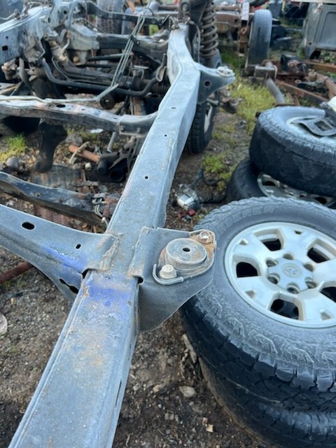

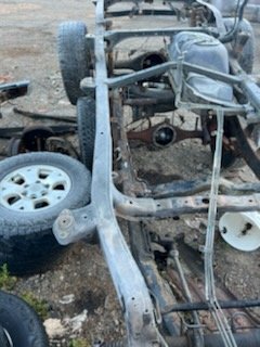

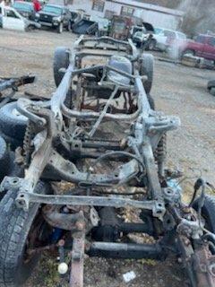

    Got a line on a 98 frame for 1000, he said he'd keep the control arms on for me. Pretty much no rust. Only problem is there is a bend in the frame between the transmission mount and the gas tank crossmember on passenger side. I have no experience straightening frames, what are your guys thoughts?

    How expensive to get to your location?
    Does the owner of the frame know how it was twisted ?? Was it done in the process of removing the rest of the vehicle?
    This is one of those things it is very hard to tell till it sits on an alignment rack.
    Proper measurements can be done.

    He said he wasn't sure how it happened. I wonder if it was involved in accident earlier in its life and maybe it was straightened? Although I would think it would be completely straight if that were the case. I took the level out to mine and that section of frame appears to be perfectly square. I was thinking I could just heat it up and use a jack sideways to push it out. Is that an over simplification?

    There is a good chance it was an accident.
    What do you plan on pushing the jack against? If you're thinking the other frame rail, that's not a good idea. You need something else more stable and less moveable than the frame rail you're trying to bend. Even if you were to do that, the frame might not be square elsewhere.
    Id just get the frame to a shop that specializes in doing those types of repairs. They are going to know what to do more than just trying to heat it up and bend it. And you want it done right. Would be an awful lot of work to swap a frame only to find out it's a write off frame.
