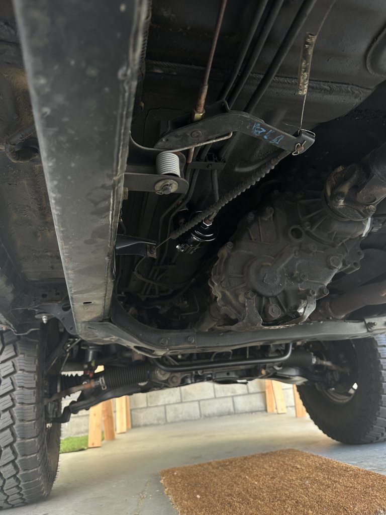

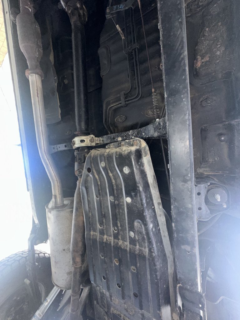

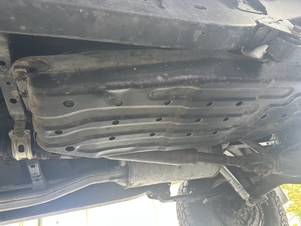

    My last post left off with throwing together the rear. The original gas tank was rusted out and leaking so I junked the whole thing. Tracked down a parts guy who had a tank from a 2000 prerunner. Came with the filler neck, fuel pump assembly, a solid skid and tank strap. I decided to use the pump assembly from my truck (with new fuel pump, filter, and gaskets), but unfortunately the fuel level sensing float gets caught inside the tank somewhere so the fuel needle doesn't go very far past empty. At least the light turns on when its really low.. good enough for me and no more EVAP codes. Someday I'll swap in the correct one.

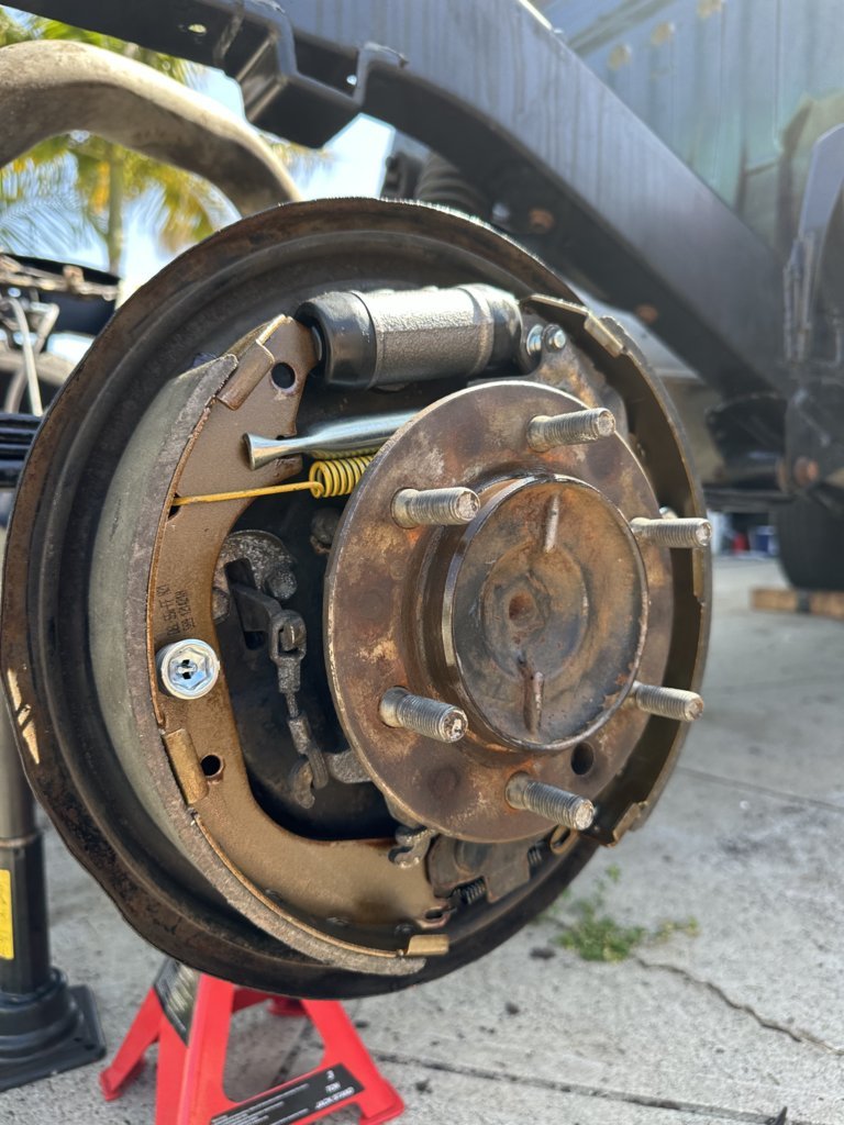

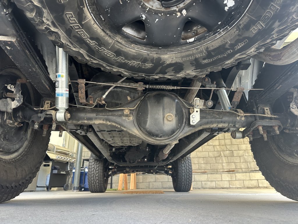

    Other than that, I cleaned up the E-brake cable and LSPV both of which were still in pretty good shape on my truck. Hooked up all the brake lines, rebuilt the drum brakes (new wheel cylinder, shoes, springs, etc), connected and adjusted the E-brake...

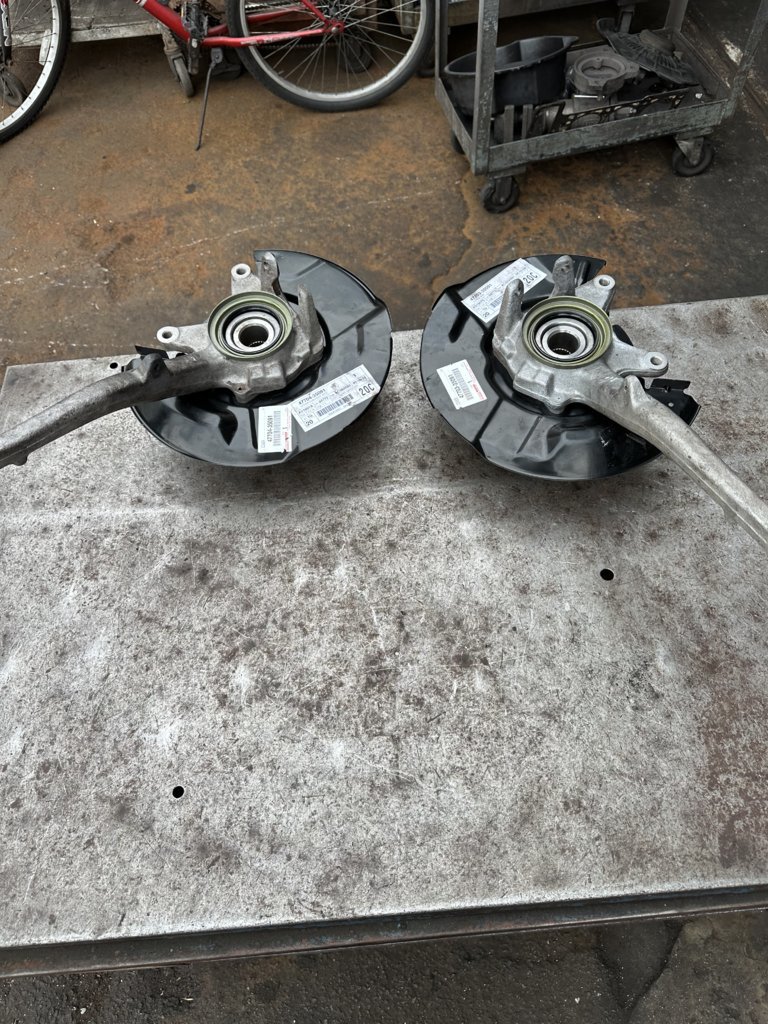

    Oh yeah, new wheel bearings of course. Found a great local machine shop guy that would do any job for 25 bucks flat (which is insane), and a damn good job at that. Sergio from Ted's Auto on MLK blvd if anyone in the LA area is looking for a guy. I'd just drop off the parts and he'd have it done by the end of the day. He pressed new bearings for the rear axles, sandblasted and pressed bearings for the spindles, assembled coilovers, and restored calipers.

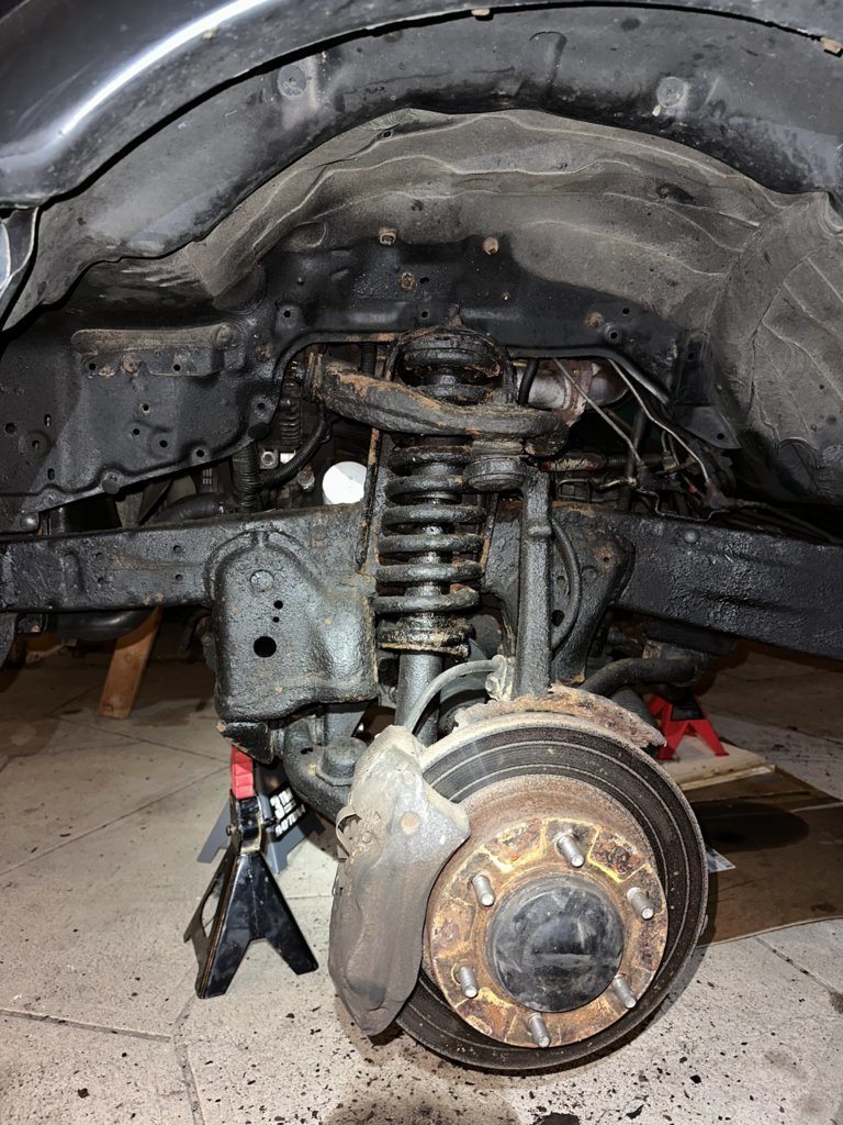

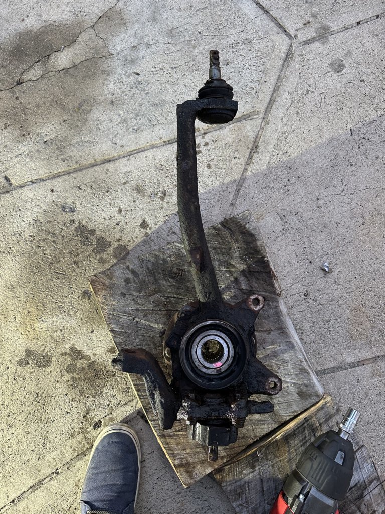

    1. Spindles. These were a major PITA because I busted a few of the LBJ bolts and had to drill them out of the spindles. Took me multiple days and many drillbits..... one of the worst parts of the project rivaling the seized body mount bolt. But hey, looking fresh now. All new bearings, seals, and dust covers. Painted them up black with the chassis saver paint before reinstalling them. With new LBJs of course.

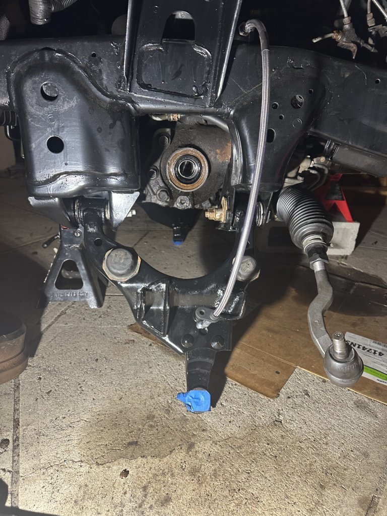

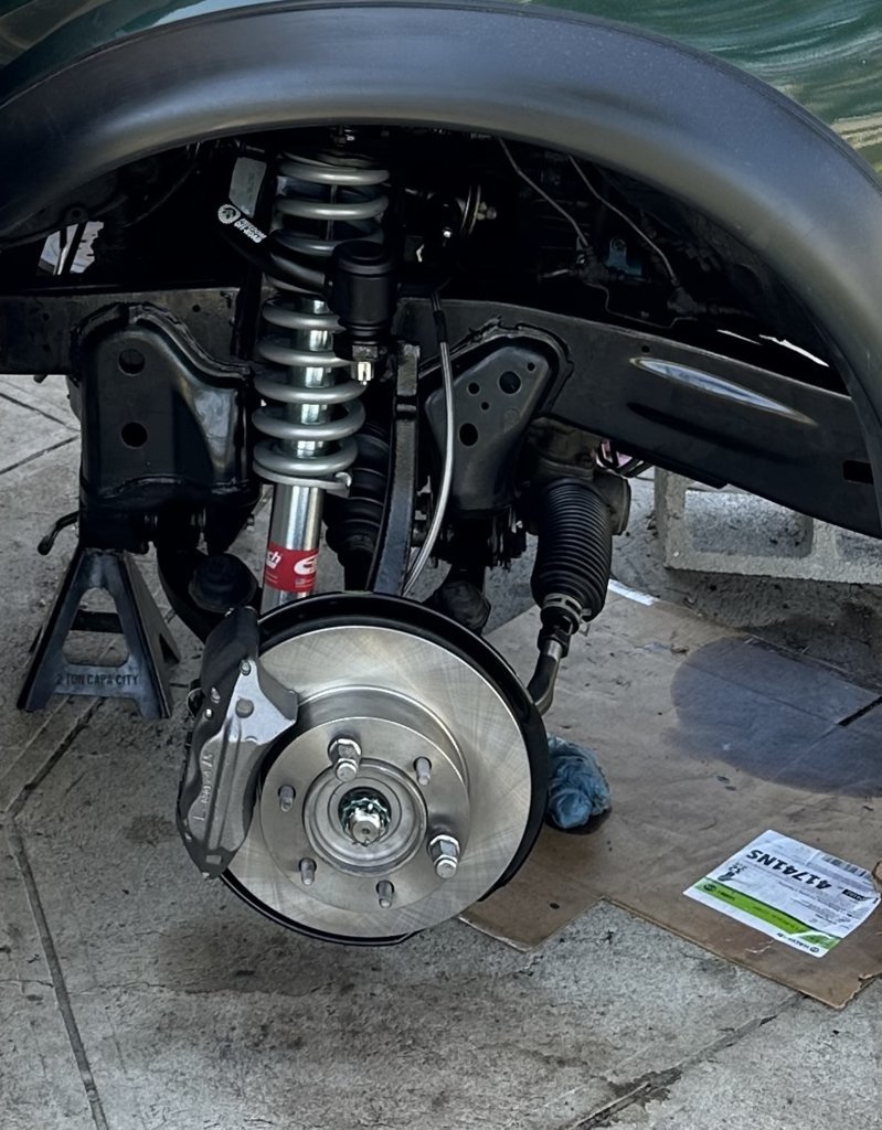

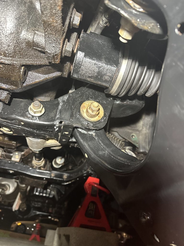

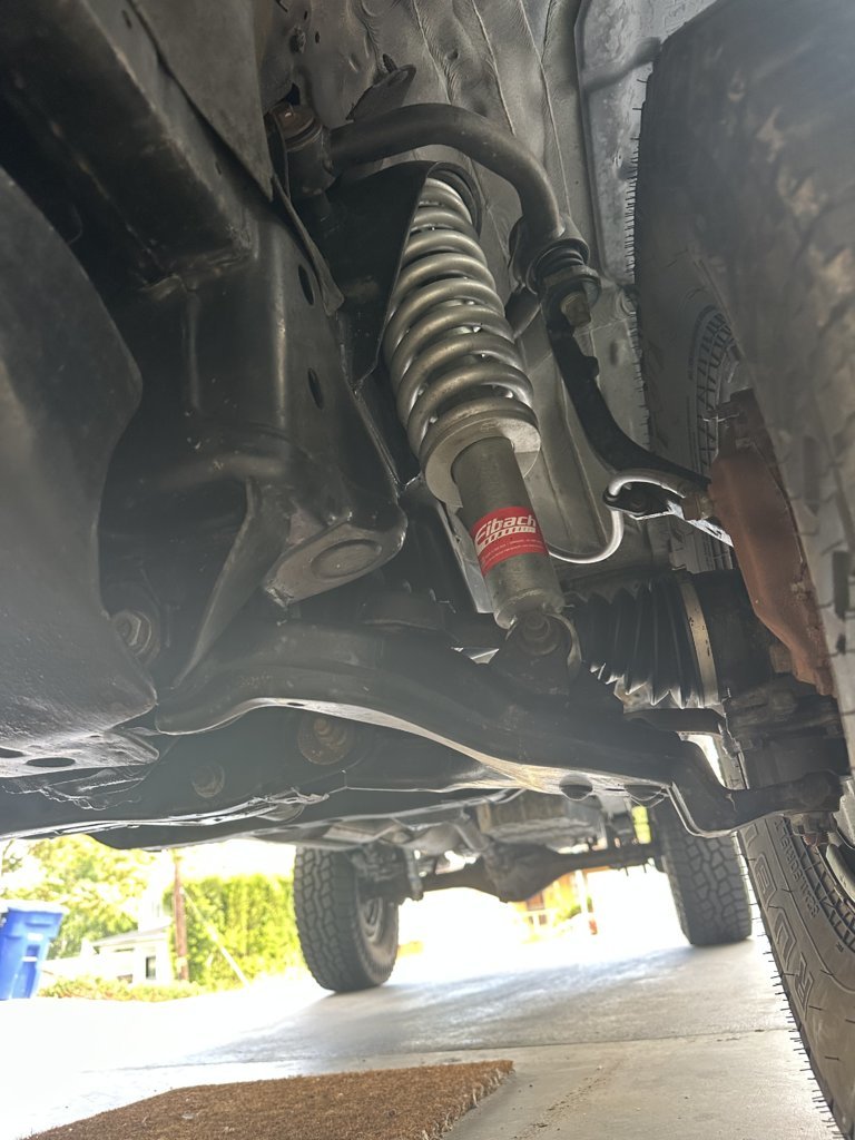

    2. new Coils, UCAs, rotors, brake pads, inner & outer tie-rods, marlin brake lines... donor LCAs, steering rack (HUGE thanks again to @Broke Okie Ty), restored CV axles and calipers...
    Some close-ups...
    Was gonna throw new seals in my front diff but they looked totally fine. Good trick for getting the CV axles back in is to get it started in the hole with the clip facing down, hold them straight out and tap the end firmly with the palm of your hand. This took some time but got them in there eventually.

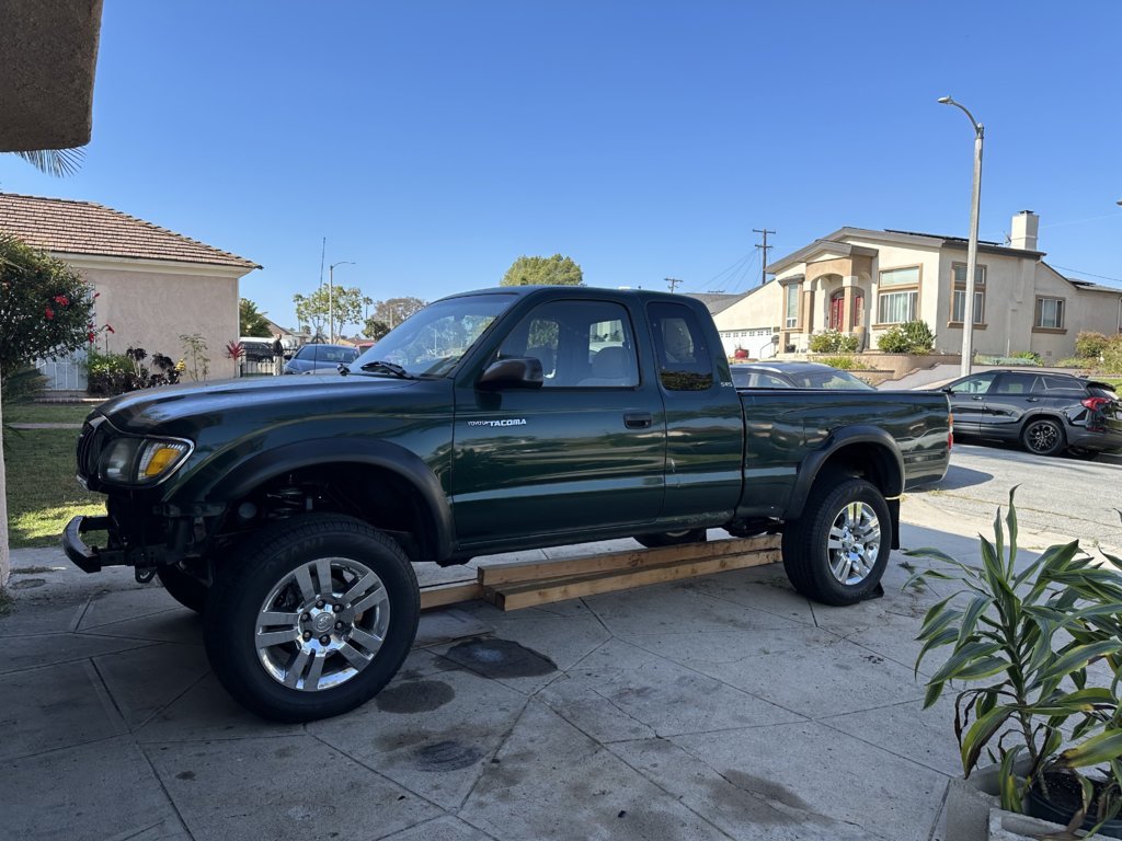

    And then for the finale. Everything was back together except I didn't bleed the brakes yet. In a rush to get out of town for a couple weeks I wanted to move my rig to one side of the driveway so my roomates could use the other half. Sure enough I accidentally fired it right into the garage, crashed it into my old frame which luckily stopped it from knocking the house down but poked a couple nice holes in the drywall.
    Something had to go wrong... haha but could have been way worse.
    Anyway, got the box back on it. Almost done! Just need to put on the bumpers & bleed the brakes and repair my drywall, then I could use the truck to move all my stuff to a new place. Neighbors were probably pretty happy to see the project coming to a close. ha.
