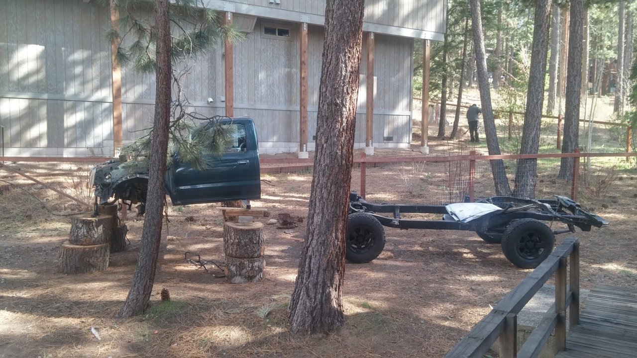

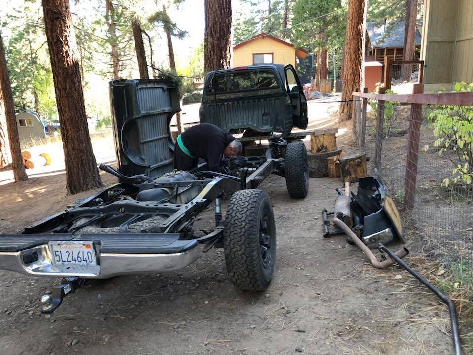

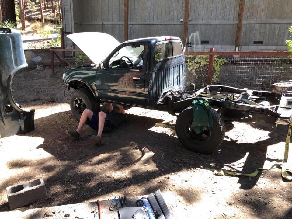

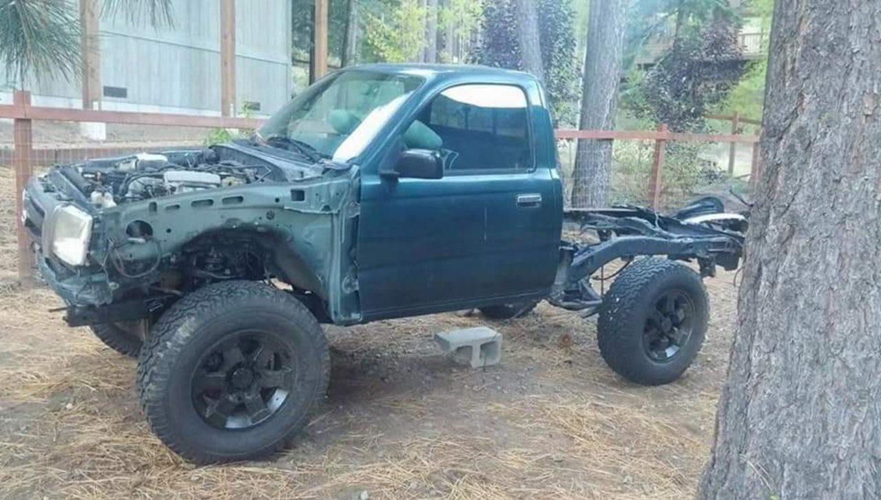

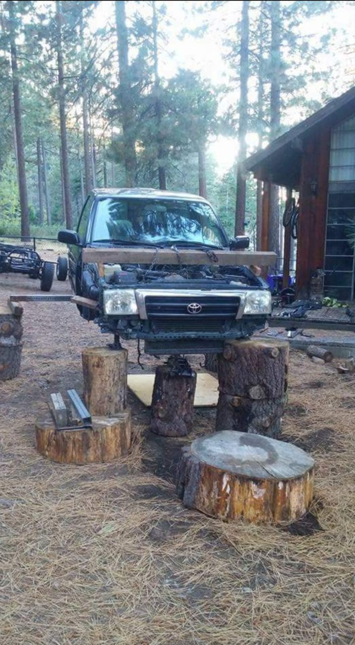

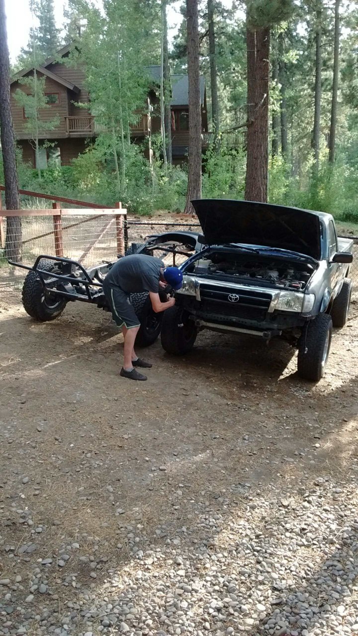

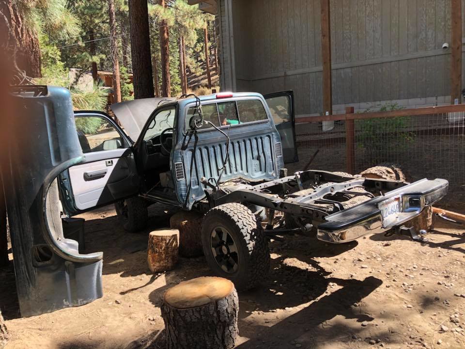

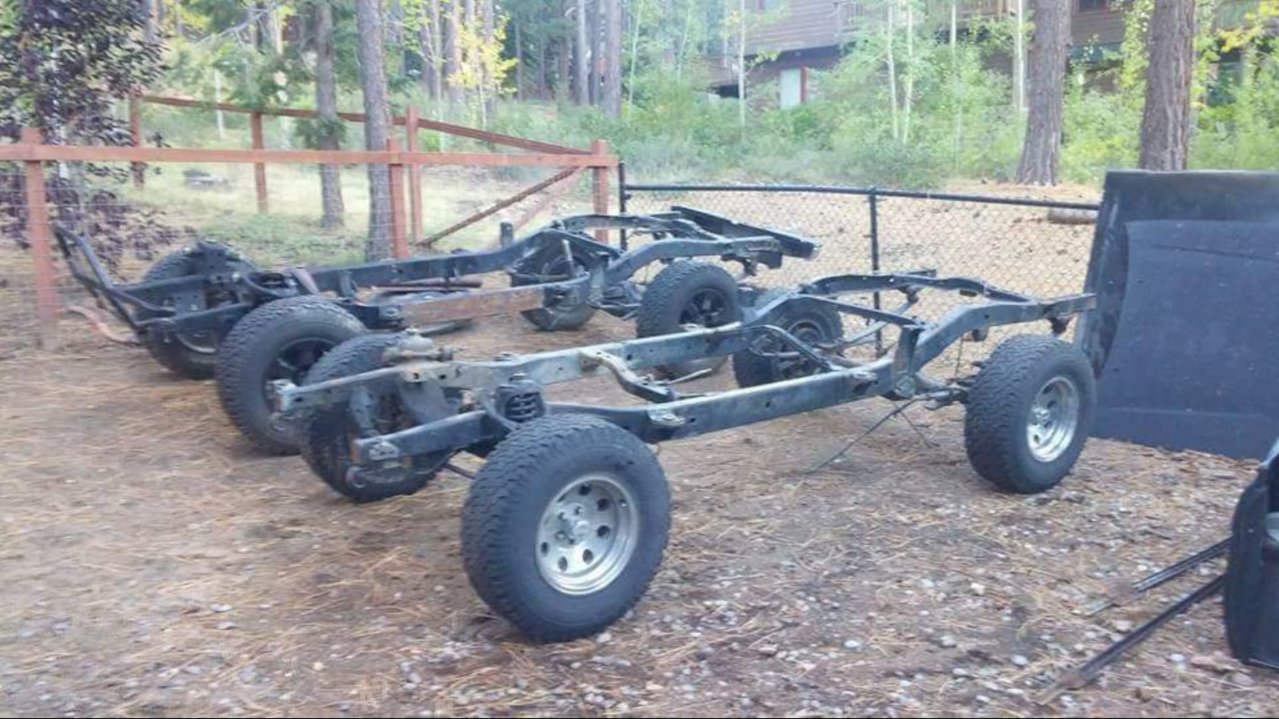

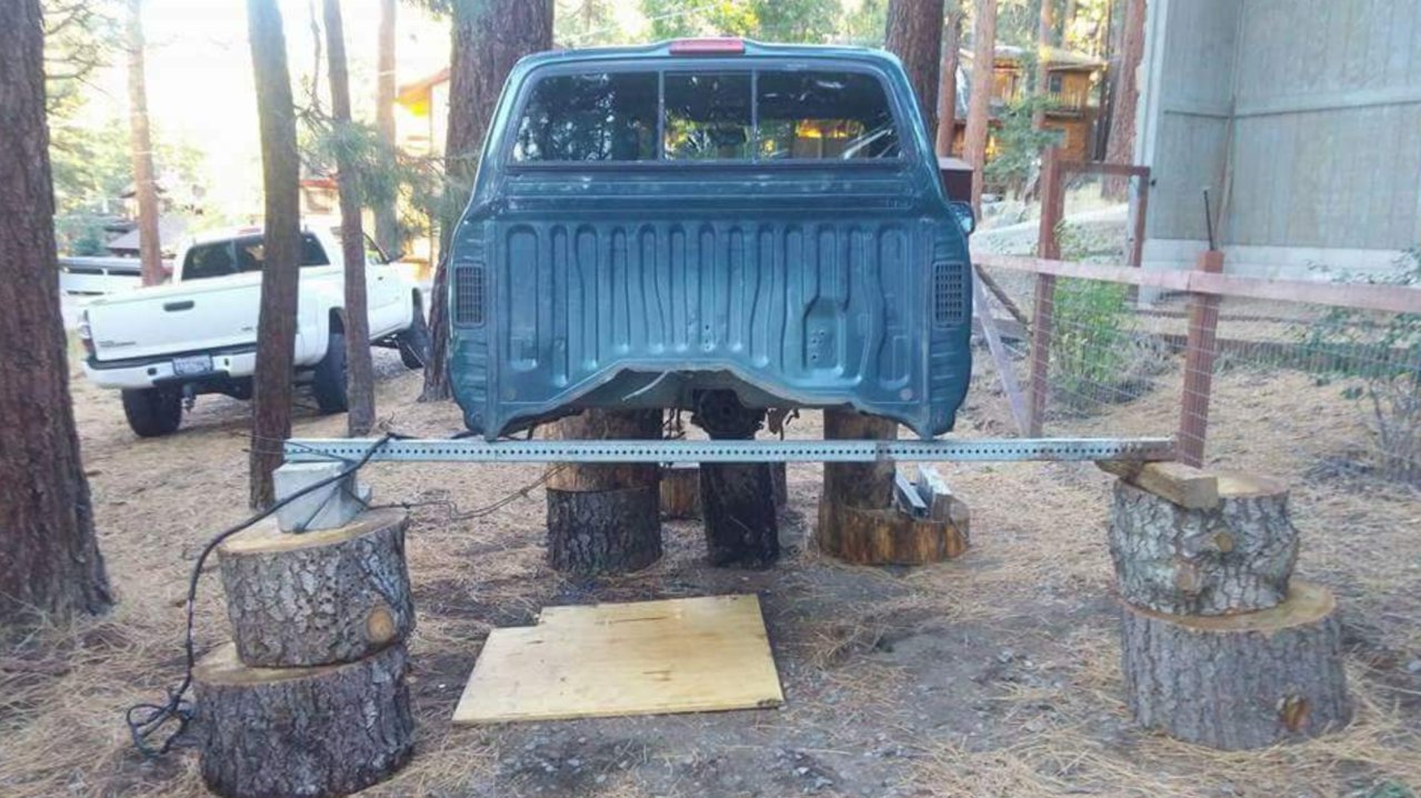

    This is the method I used. I did it in my yard, almost all by myself and it took me 3 days. I have a lot of pictures I'll upload them in a little bit

    2017 Frame swap and Bilstein 5100 lift.
