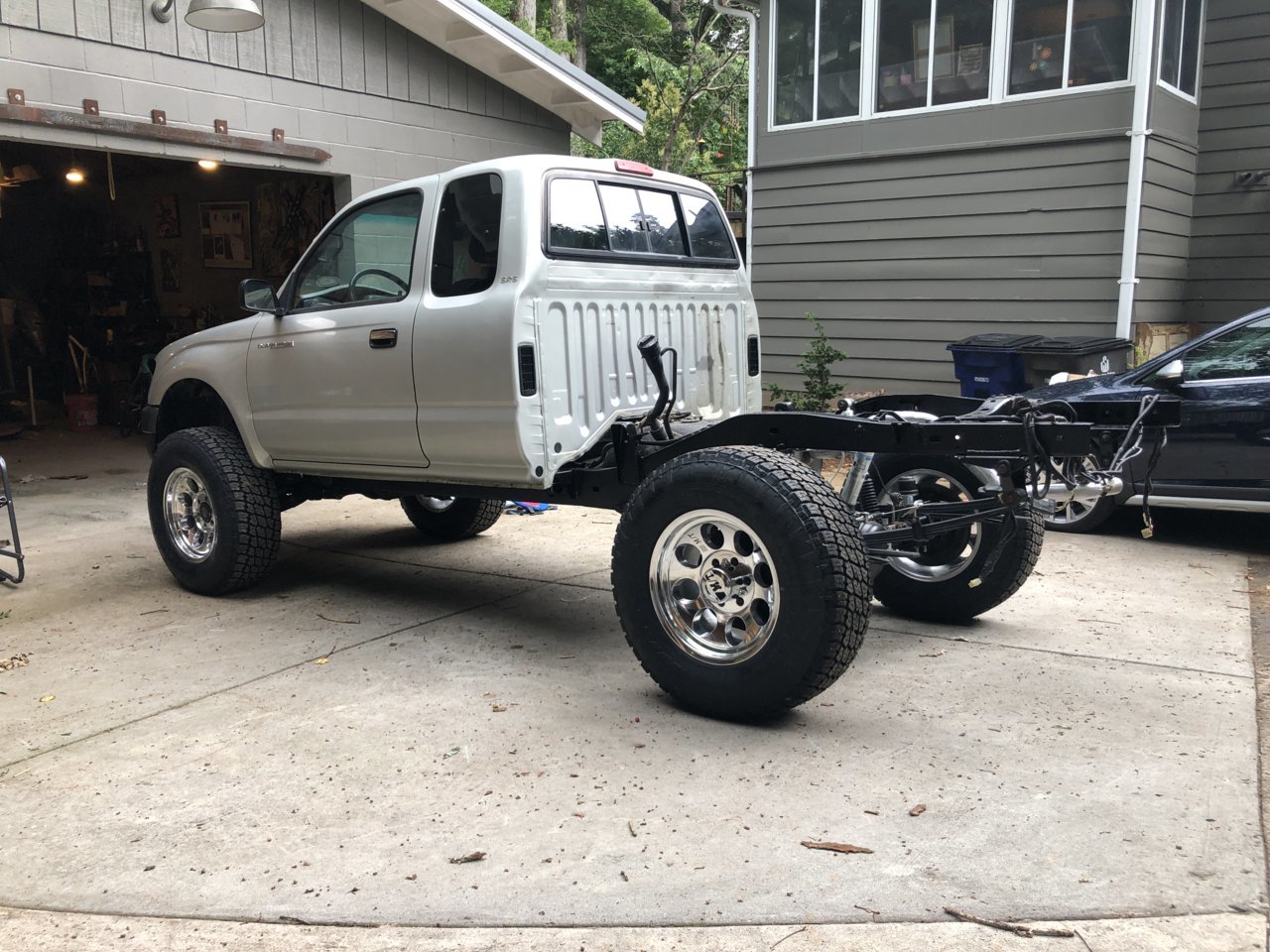

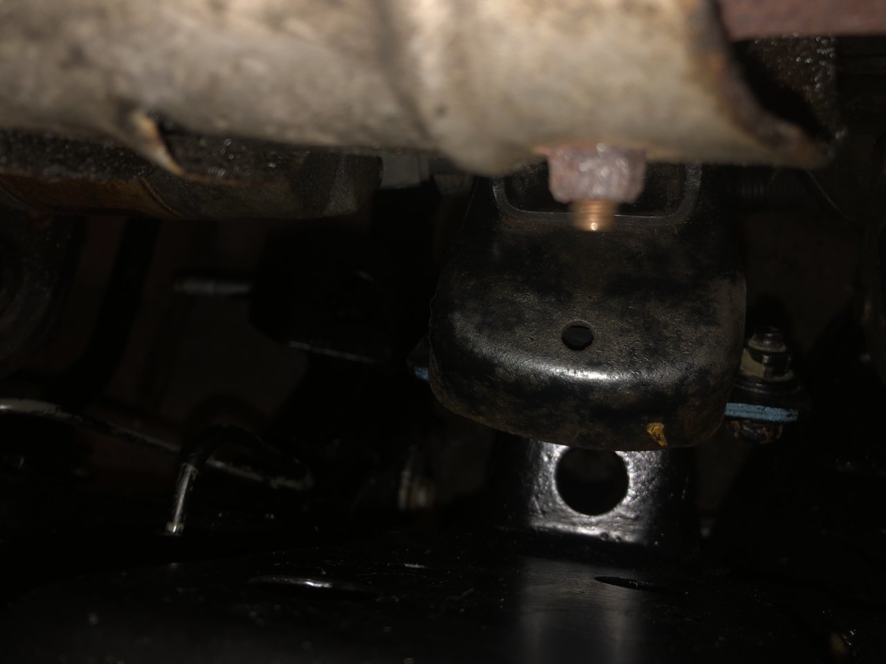

    I’ve been working on the project still a little bit each day. I slid the new frame under over the weekend, lifted it up under the cab, and aligned everything.
    If you recall, I had to replace and move the frame motor mount brackets. There’s not much room for an error in any direction here when it comes time to bolt your motor up to the frame... I was a little anxious for sure about this. Didn’t want to have to move them a second time.
    I’m happy to report that they aligned perfectly and the new OEM motor mounts bolted up nicely. Everything is now sitting on the frame.

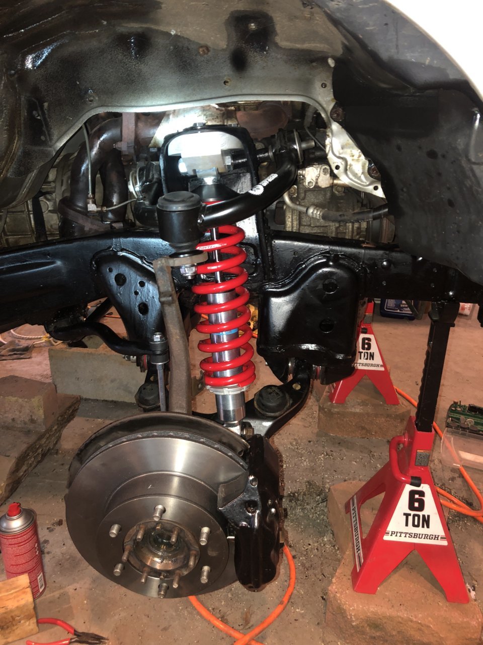

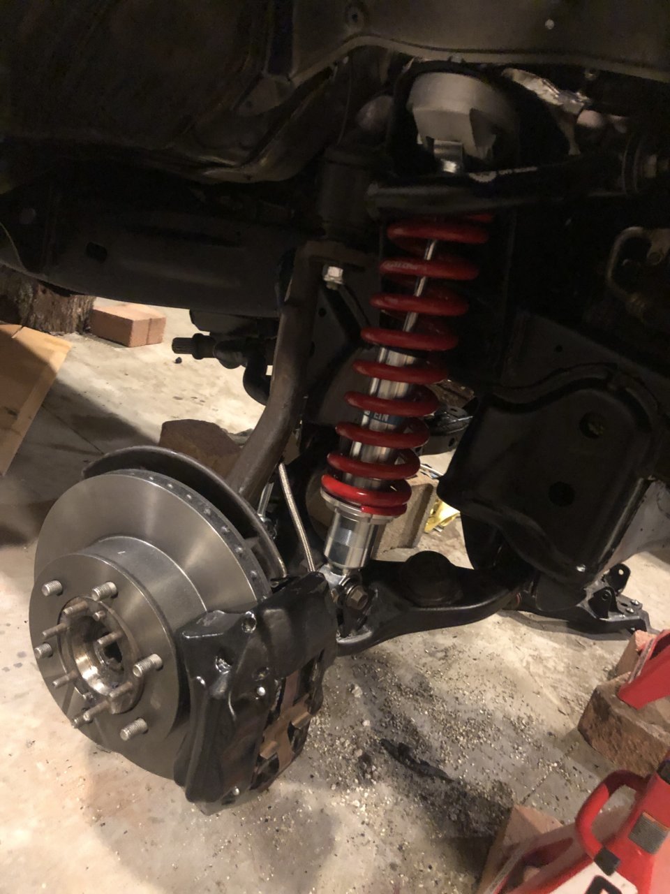

    This evening I was able to have a little fun and hang some pretty new parts. For those taking notes, we have stock LCA with new energy suspension bushings, OEM lower ball joints. Brembo rotors, original calipers rebuilt with OEM seals pads and parts. SS brake lines. Bilstein/eibach coilovers by Toytec. Freedom off-road UCA and upper ball joints. Extended swaybar link from Napa.

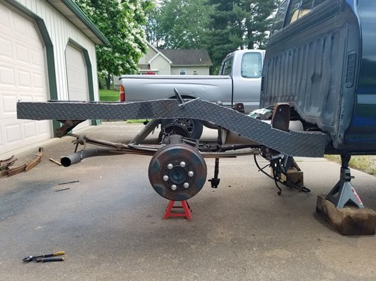

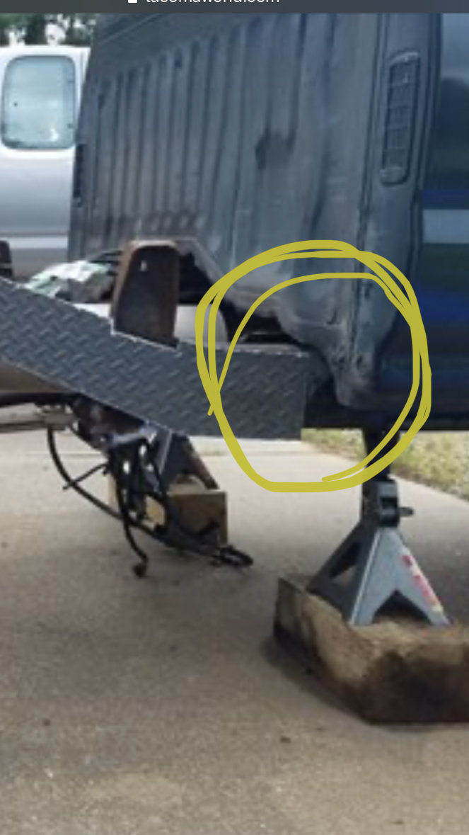

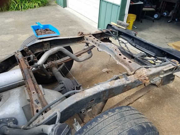

    No losing battle. Just need some Midwestern TLC. Frames never come available in this area. I can make what I need.
    That's 6mm thick (about twice original). I'll make top and bottom as needed from 3mm. Gonna be stronger than original. Got both sides rough cut this evening. The replacement leafs are the big cost at about $375 for some General Springs. The rest about $250 should cover it.

    That looks good my man! I applaud your hard work and grit. I did not mean to sound like a Debbie downer sir, just trying to give my honest dos Lincolns.
    that is super strong looking! Way beefier than stock. Just remember to pay attention to your mounts and stuff and remember these rot from the inside out! Keep an eye on the area where the old frame meets the new, I circled it. The whole frame is only as strong as this connection and the welds. Could you run some plate along the bottom side up under the cab about 16” and spot weld every 3” or so on both sides? That would make the “joint” stronger. Keep up the good work my friend!
    also, have some stock leaf springs you can have if you want to pay for shipping. They do not appear to be that worn out. Came with my donor frame. :thumbsup:

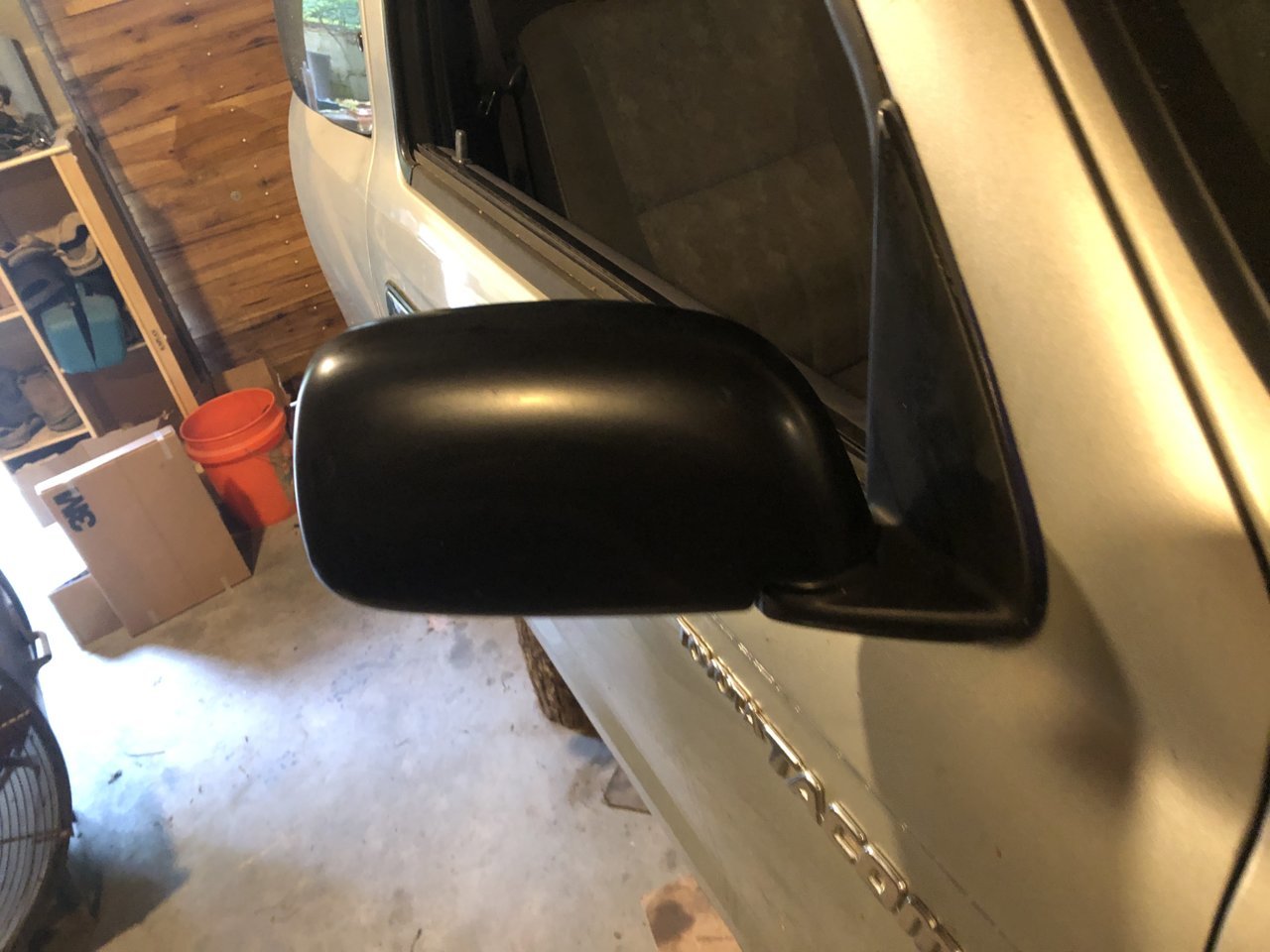

    New/old mirrors. The warning seems so appropriate right now. Stay safe out there my friends.

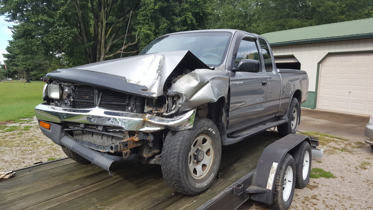

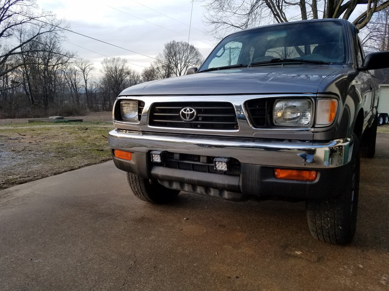

    No problem on offering your warnings. This truck is a hobby, and as I said in another thread, likely a hand me down (sacrifice) to my nephew just reaching driving age. I have another 95 from SE Tennessee that has a really nice frame. I bought it from a local salvage yard and rebuilt (clean title though) after a front end collision. See below. It's my long term 1st gen.
    Thanks for the offer on the leafs, but I already have some on the way from General Spring.
    I understand the yellow circle area. I've already done some repairs from there forward and plan to bridge the two sections.

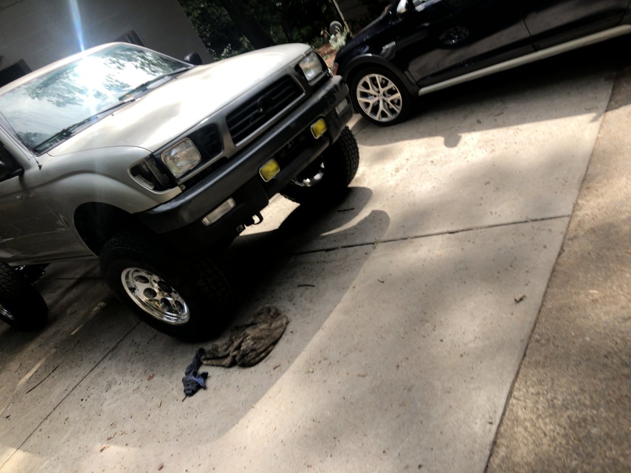

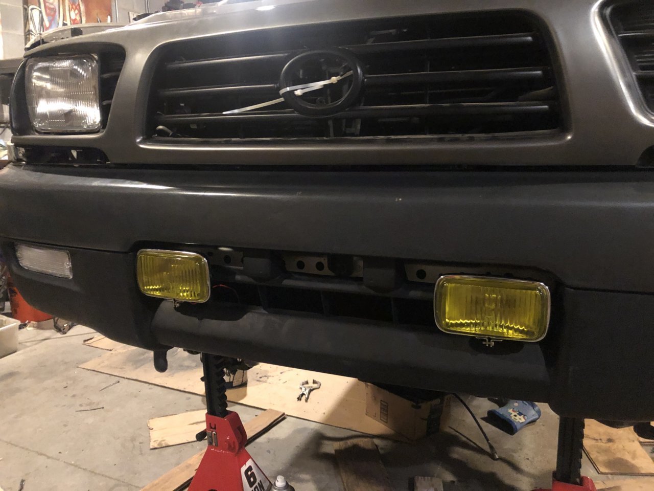

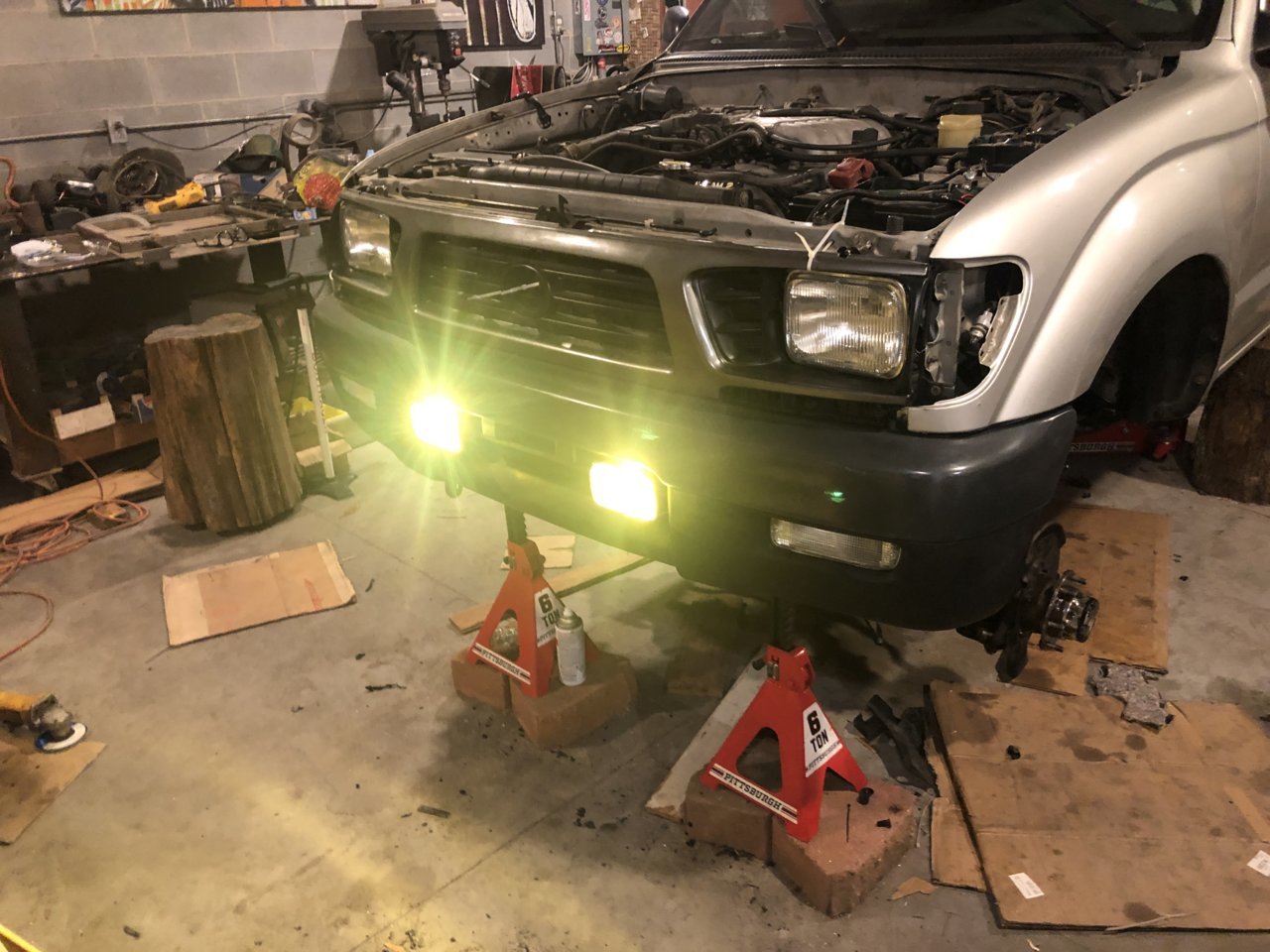

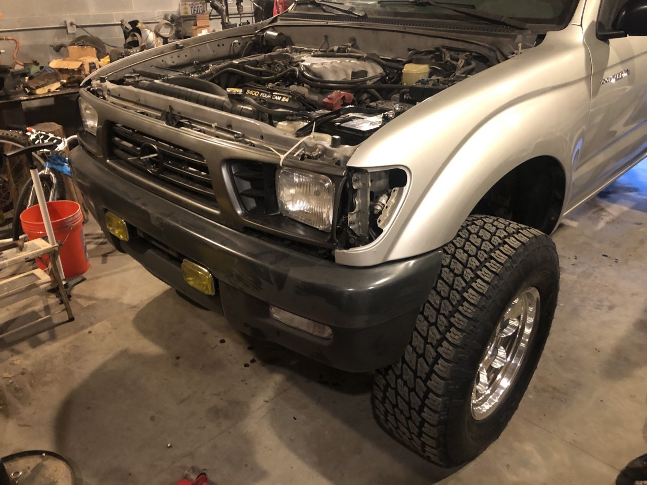

    Work continues although I’ve slowed down a bit. This crazy world has got me a bit flustered. Finished swapping the front end to a 96. I really love the blunt nose look. Had to fab my own bumper brackets. Need to paint Bumper and skirt, going with a semigloss black Installed my sweet vintage K-mart glass halogens as well. The tuck in to the lower bumper skirt nicely and are very bright.

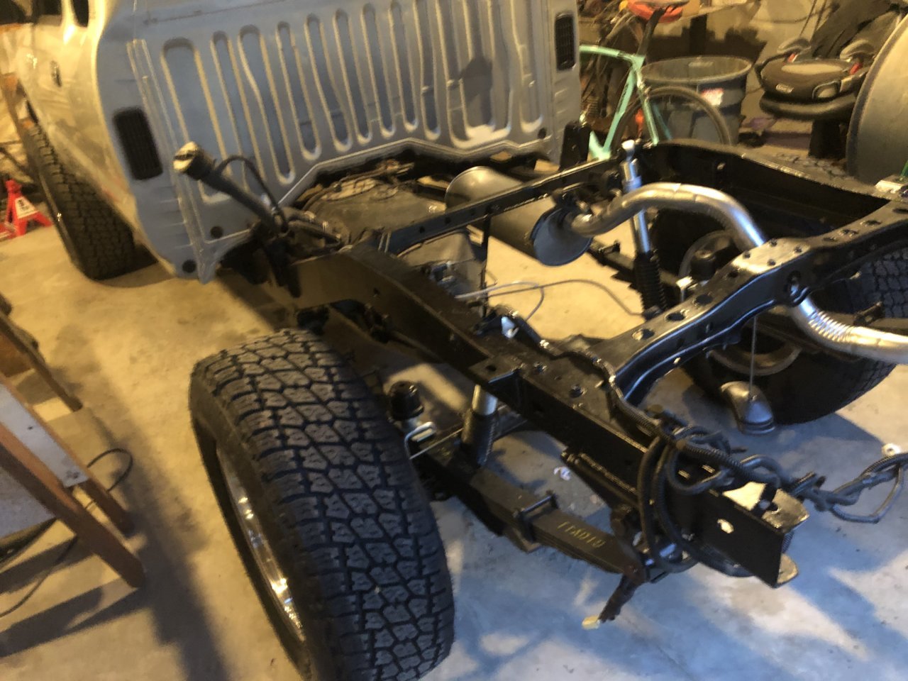

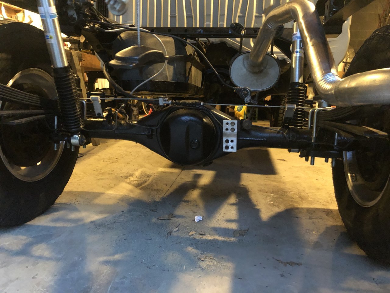

    Ladies a Gents. We have a roller! I brought the donor frame home April 9th, so about 3 moths exactly by the time I button up a few loose ends. Still need to have bed, flares, grille and bumpers painted, figure out a skid plate and I think she deserves some new component speakers as a reward to myself! Aside from my 6yr old helping me bleed the brakes, this was 100% diy.

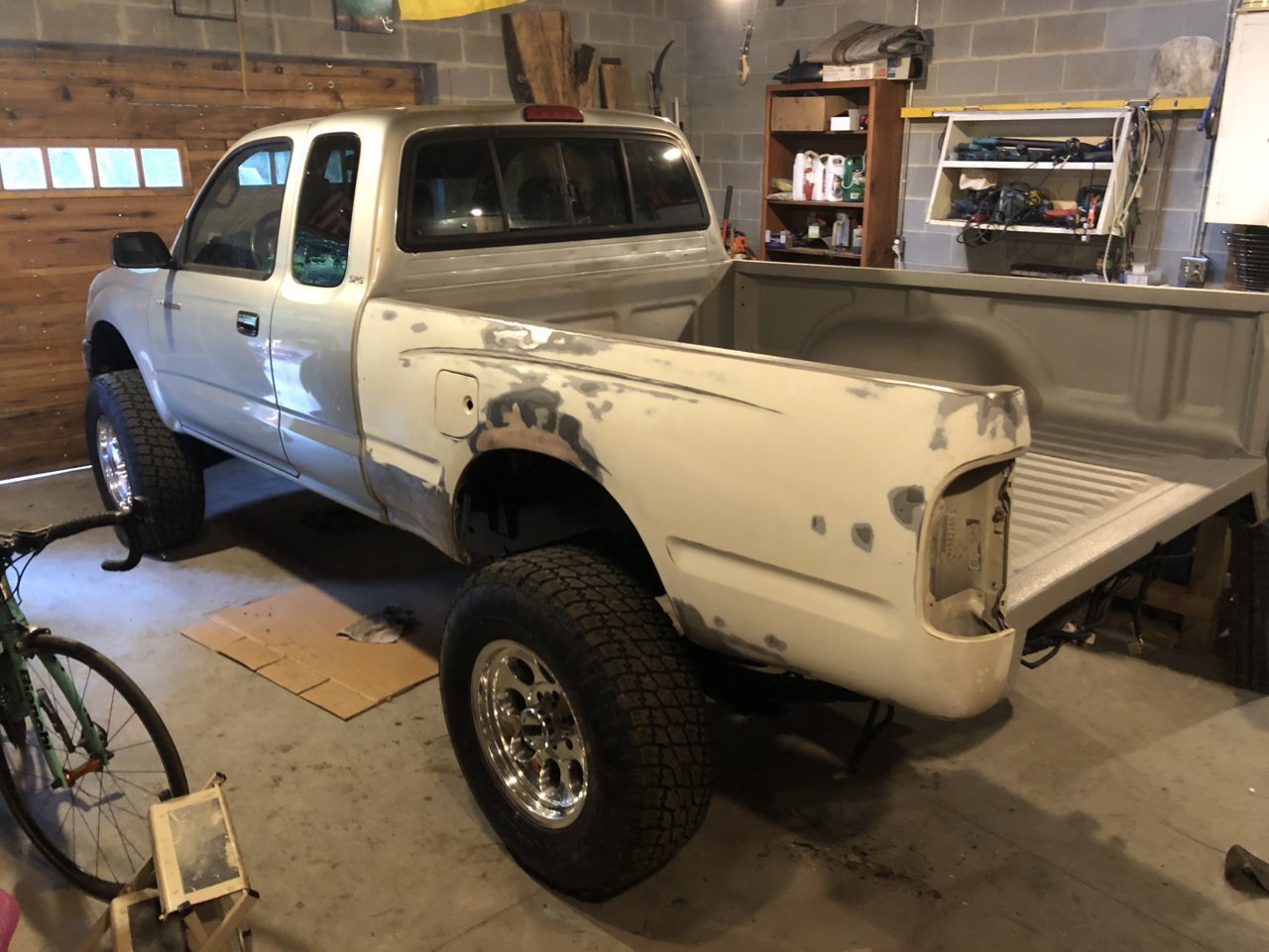

    thanks brother. Sat the bed on tonight. Gonna head to the body shop for paint next week.
