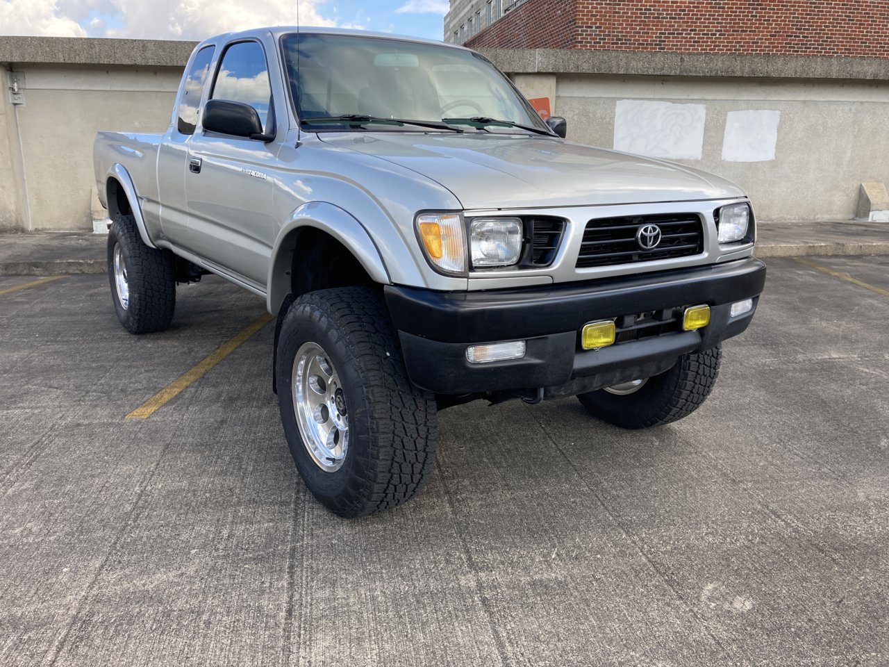

    Wow this truck looks amazing! I really like the color matched grille.

    Awesome. :DThat makes me want to do my grille with a color match. I wonder what my paradise blue would look like

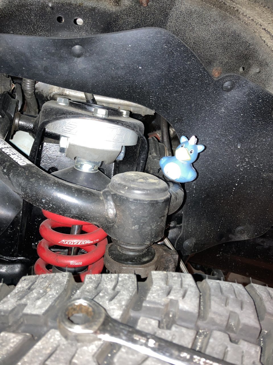

    Thanks... I cant seem to find the C-clip anywheres... any chance you know a part number?

    @Loctite77, i believe it is PN# 90520-27023
    also worth noting, from the diagram there appears to be a washer behind the snap ring too PN# 90560-27005

    Thank you man. I got the parts, new hub gaskets as well and all installed last night. I’ll get a test drive in tomorrow.

    Your Truck really did turn out great looking. Post us some pics of the Interior to see if it matches the exterior.

    the manual hubs cvs shouldnt have a bolt to hold the cv on. There is a c-clip for the hub cv part and then a c-clip for the inner cv part in the diff. Our first gens with the manual locking hubs dont have cv axle nuts.

    well I was able to find a part number and a bolt and now have them installed. I guess they could be run either way. ✌️

    If TW ever does a calendar this Truck deserves a spot.
