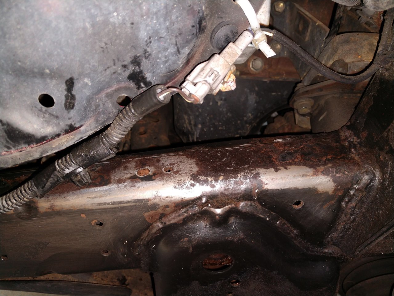

    My warning about CRC that I posted in another thread:
    I see their doing the same thing they did for the later 1st gens. No crc=no new frame.
    If you get the CRC, make absolutely certain that its not being applied overtop of existing rust. Sand, prime, paint etc before you take it in. It will work to prevent future rust, but existing rust will continue to fester underneath.
    Most of my 2004's frame is shiny black metal under the CRC, but there are a few spots where it was applied over existing rust. Fixed one of those spots this week. Not fun. This is behind the engine skirt in the fender well. I would remove those before taking it in to ensure that area gets sprayed well. [​IMG]
    Fluid filming on top of it works great. It will keep the CRC from drying out, which is how rust will continue to develop underneath if left alone. All in all, CRC does work as it should if applied to a new frame. Imo, it is not the best solution to use on a frame with pre-existing rust.
    Also, the stuff is worse than anti sieze if you get it on you. Go to turn one bolt under your truck and youre gonna look like a coal miner by the time the bolt comes out lol.

    this is the correct answer !!this guy is on point!!! use this info if your getting it done !!!!!!!!!!!
