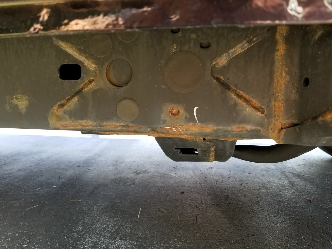

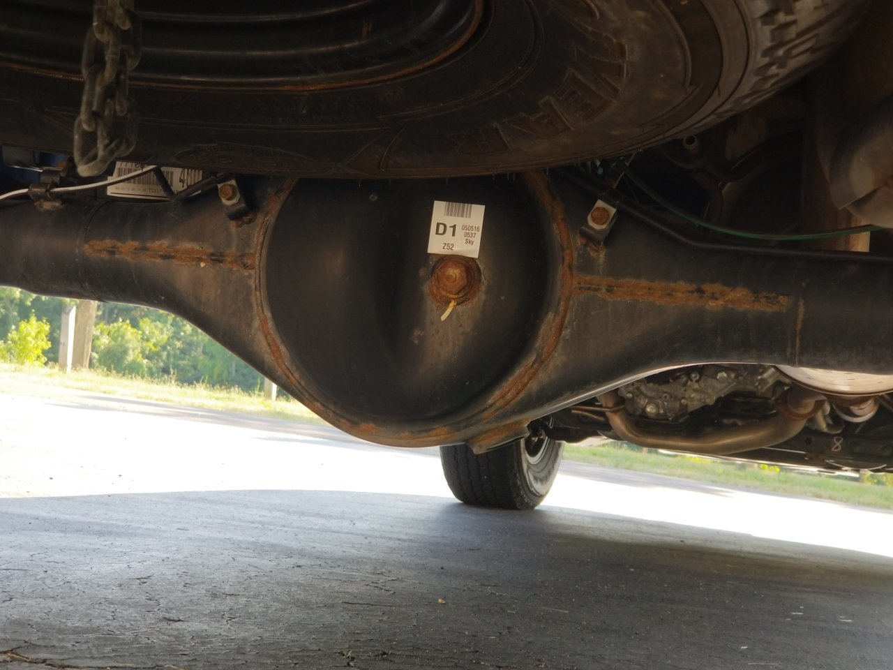

    20180715_164036.jpg 20180715_164056.jpg 20180715_164009.jpgThis was my 2016 after 2 normal winters and about 20,000 miles of living in central NY where they salt the shit out of the roads. Ut sucks because your truck is literally rusting away at a crazy fast pace.This was with out anything applied to the frame. If you plan on keeping her for the long haul I'd start the day you bring her home and start rust proofing

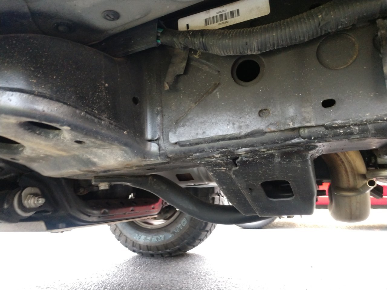

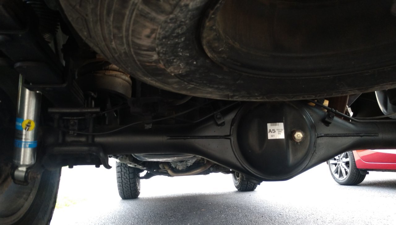

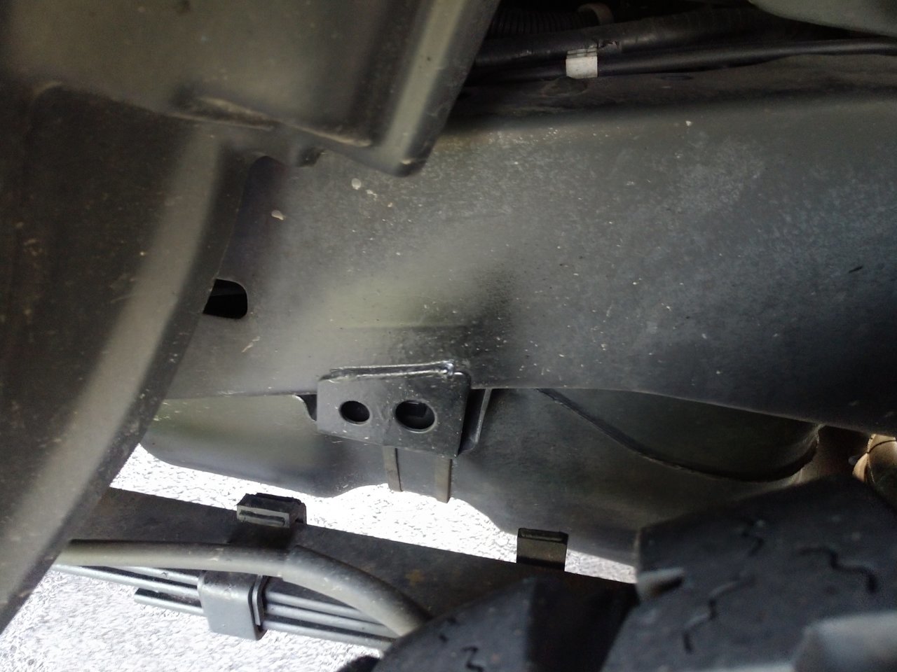

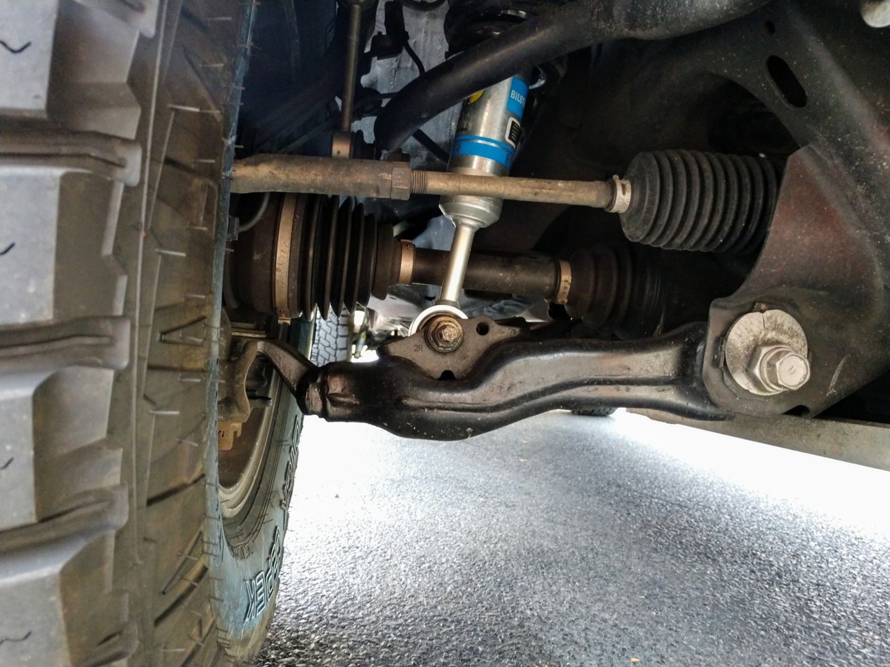

    This is my 2016 after 4 years and 72,000 miles of Pa/MD salted roads. Knowing the prior issues with Tacoma frames I spend a little maintenance time on the undercarriage. Once a year Fluid Film and regular cleaning.IMG_20190916_174942941.jpg IMG_20190916_174909239.jpg IMG_20190916_175016402.jpg IMG_20190916_174959191.jpg
