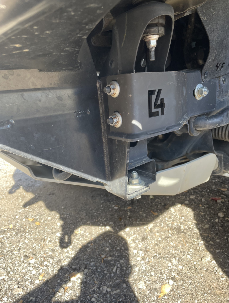

    Example of C4 Fab's reinforcement bracket:
    Note it will interfere with remote reservoir mounts for most popular coilovers, so some custom cutting/clearancing will be required.

    An example: 19D866B8-93E2-49E5-A319-48FCC86024E2.jpg
