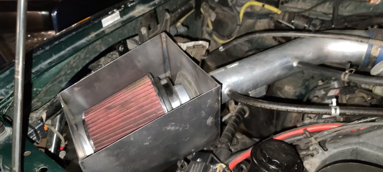

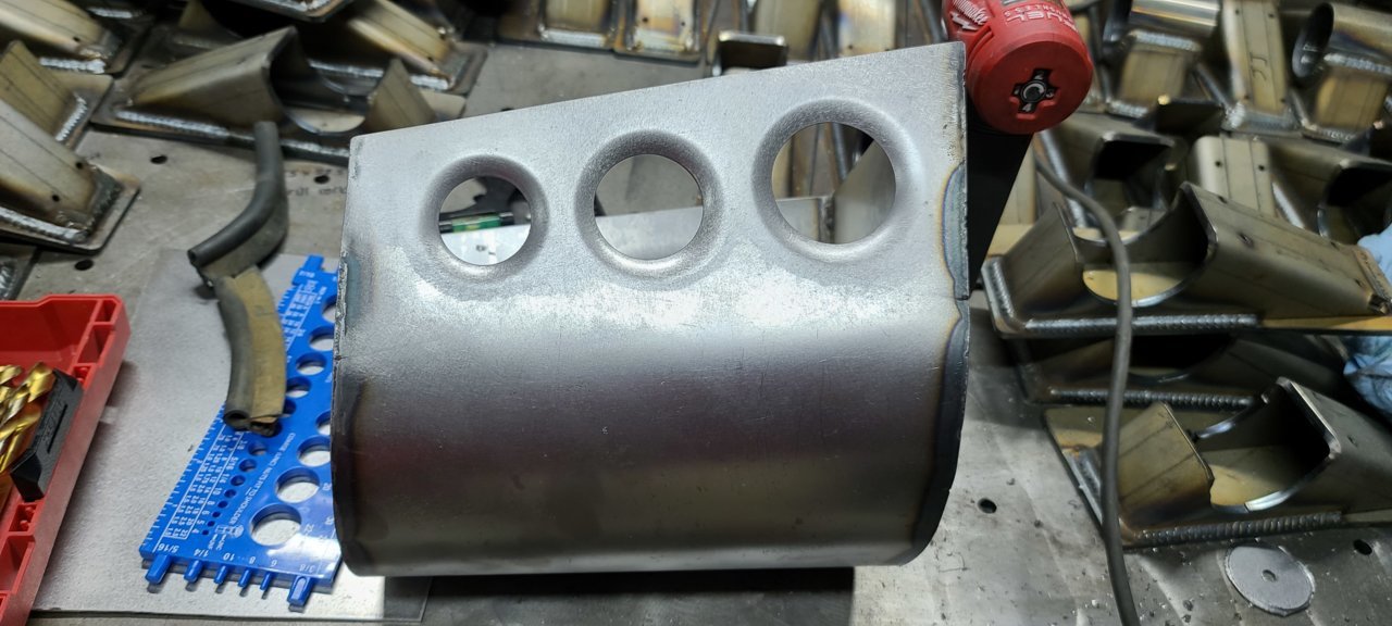

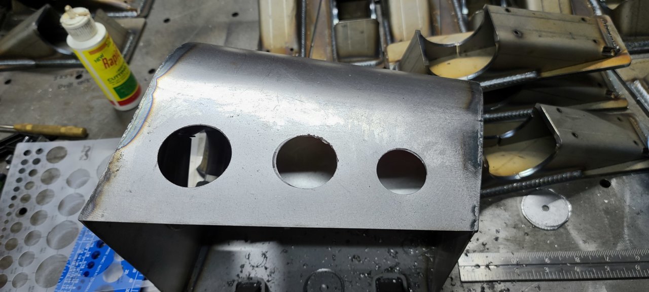

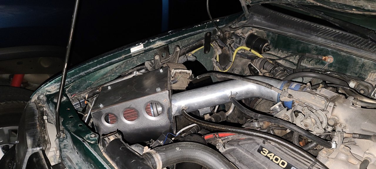

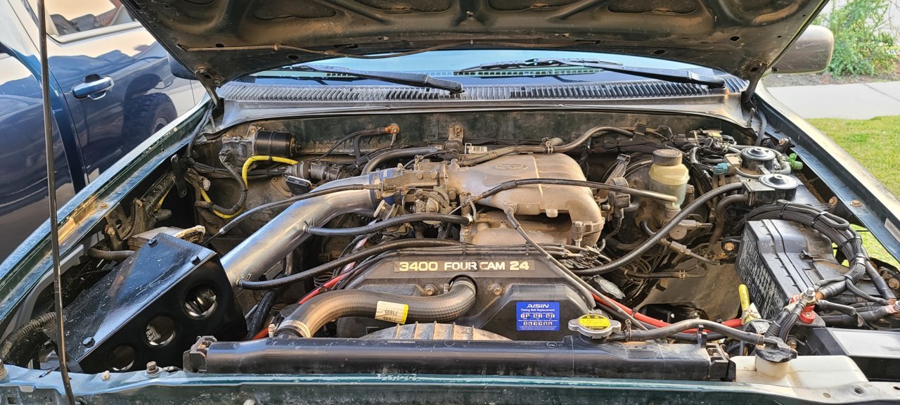

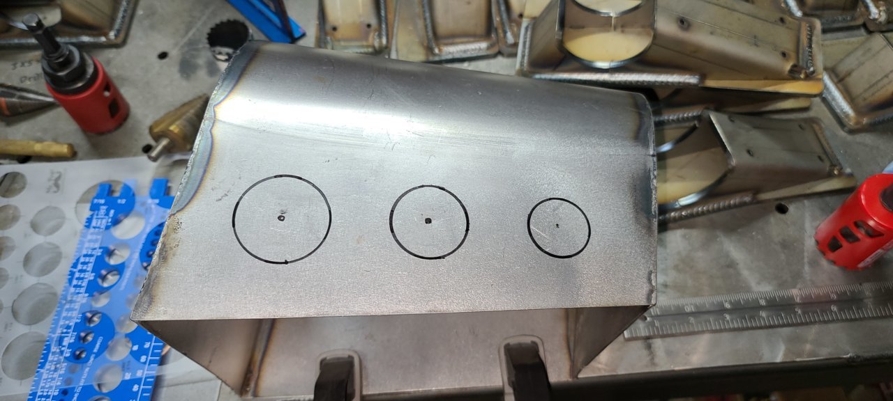

    I finally decided to do something about my intake. I tried finding a pre made intake but nothing fit properly. So I decided to make my own.
    Started by mocking it up with CardboardAD. I created a design I liked, cut it out of 18 and 22 gauge sheet metal, and welded it up:
    Obviously it needed some air holes so I went to my buddies to use his dimple die set:
    And a final test fit. I made some mounts off my tube to hold it solid:
    So far it seems to work pretty good! It sounds like a Honda when I rev it up for some reason and I didn't think about it before but yes, it will be sucking in all the hot air from the motor. Oh well... What do you guys think? I think I want to make the top look a little less flat but I think it'll work! I painted it all black so I'll post more pics when I get it 100% installed.
    Yota X, Dan8906, Dalandser and 3 others like this.

    Turned out rad! Definitely going to wip up something similar whenever I ditch the dorkel :anonymous:

    Thanks! I'll go send it through some water soon and let everyone know how it performs. Hopefully no more hydro-locked motors!

    I was thinking about something like that. Then I could plug up the side holes and move em to the top. Right now it seems ok, the real test will be when it's 100 degrees out. Right now its a nice 70-75 out so intake temps appear to be in the normal range.

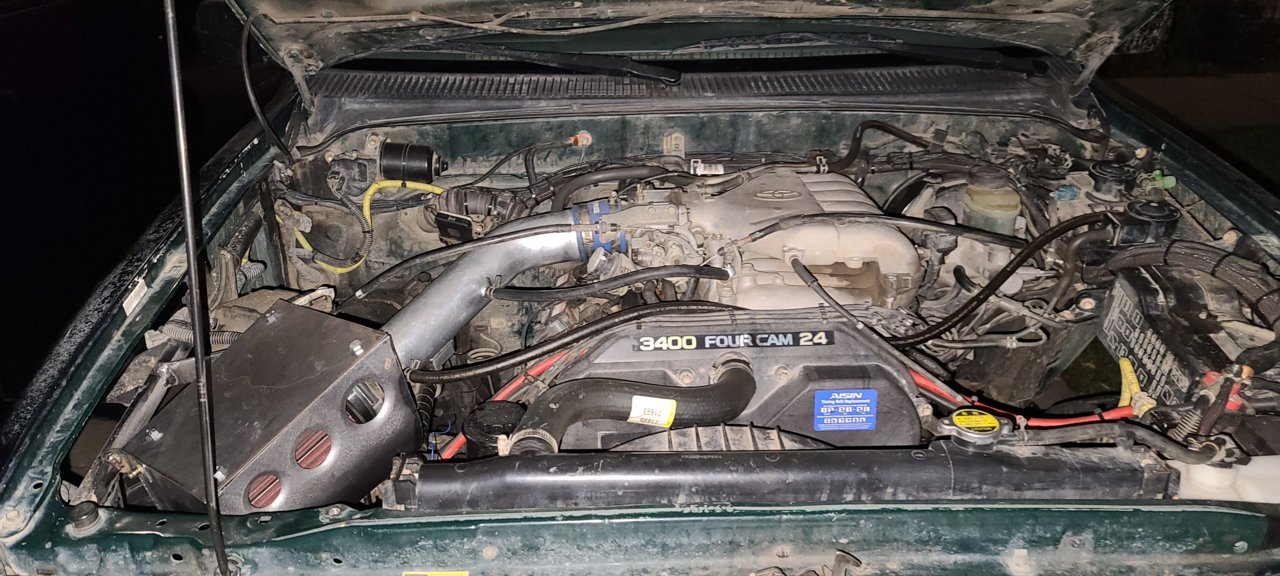

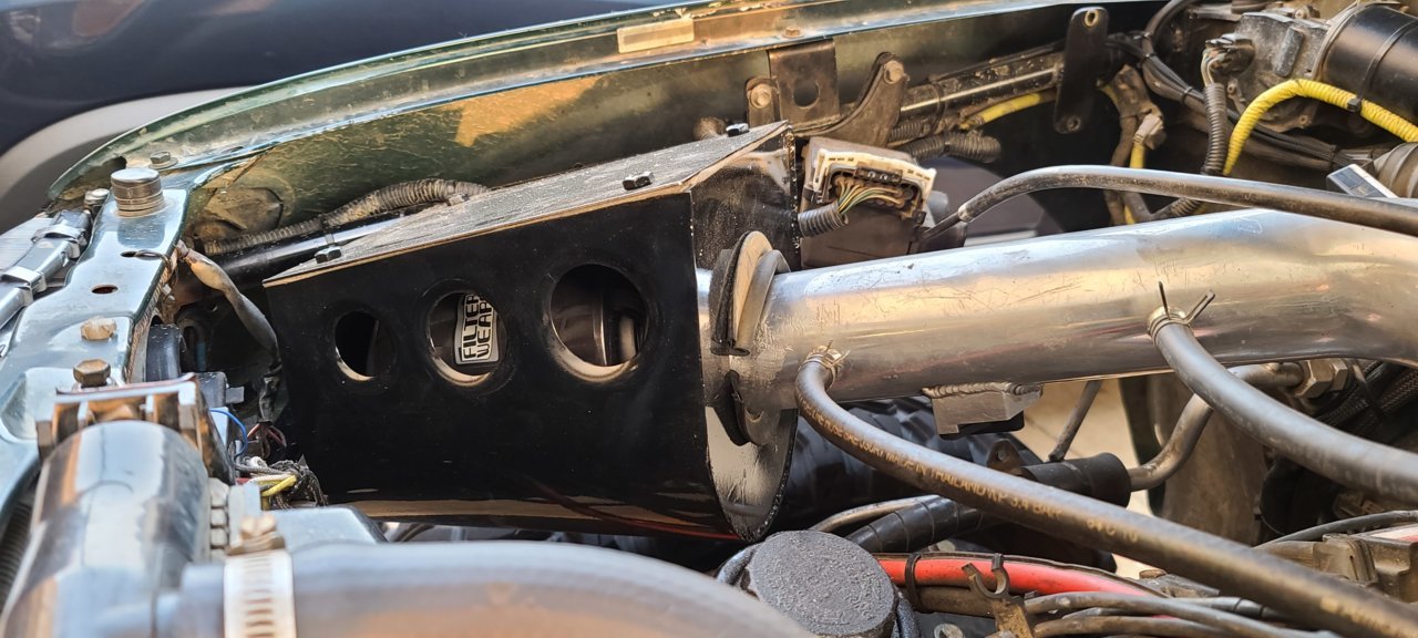

    Got my new intake painted and installed! So far it's working great. Still haven't gone through any water, I gotta work my way up to that!
    I also added a seal in it which helps with the Honda noise. All I have left is getting the proper bolts for the top and finding a better intake tube seal!

    Interested to see how this works! I have the same problem you do (no hydrolock here) but don't know what to do with the intake. Either ricer special, or I don't know what else. Definitely no dorkle as I would rip that off the truck within minutes of hitting the trails around here.

    So far so good! I haven't done any deep water crossings but I have hit the wet snow and can see a ton of mud/water splashes on the box. It's crazy how much junk I was splashing on my filter.

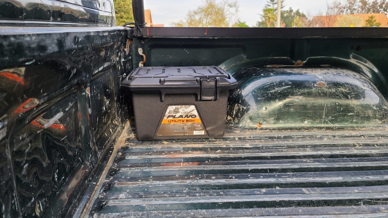

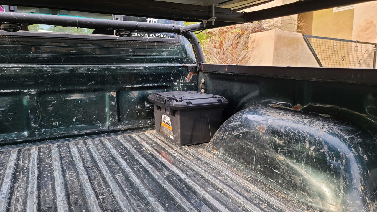

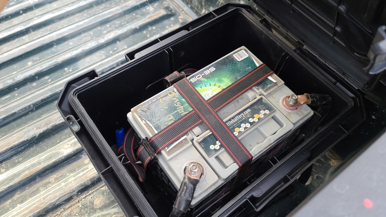

    Finally got around to doing something about my exposed battery!
    When I tubbed the front we moved the battery to the back. It has just been sitting in the elements for the last year or so. I was getting pretty tired of watching my expensive battery degrade in the elements and I have been trying to find a good box to put it in. I was browsing Home Depot the other day and this box caught my eye. It looked to be the PERFECT size for my battery! Not only that but it has a rubber seal in it and the lid can be locked!
    I purchased the box and got to work. The battery box was slightly too tall so i had to mount it with straps instead of the metal plate but it still feels pretty solid.
    So far so good! The only issue is that now I need an Allen key to disconnect my power, but I just threw an old one in the box. I think this should work pretty good for a while!

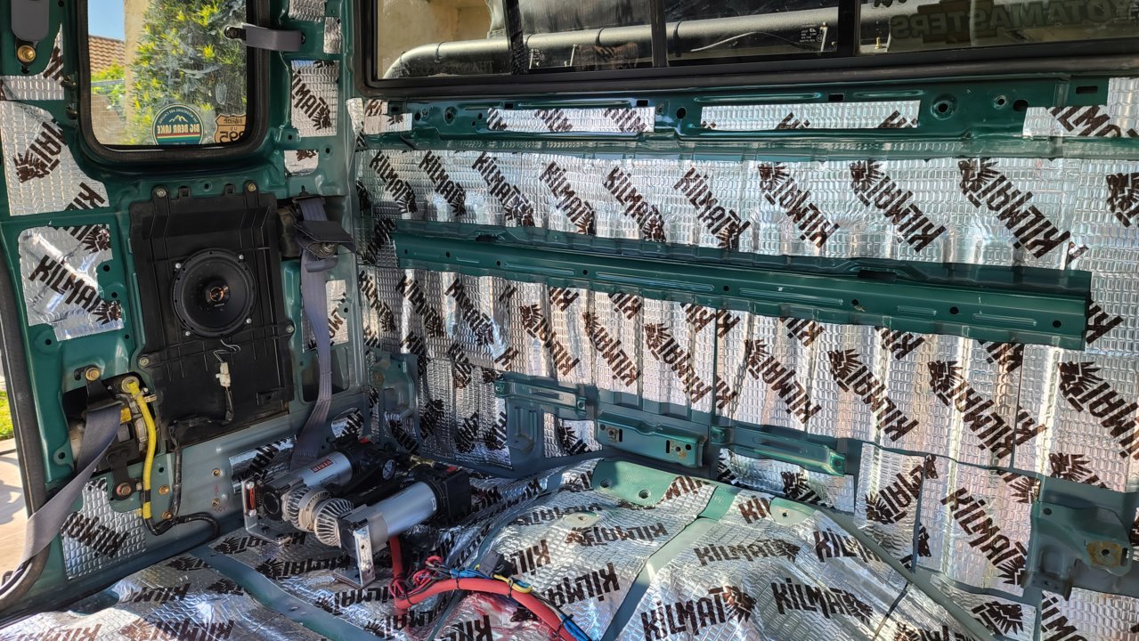

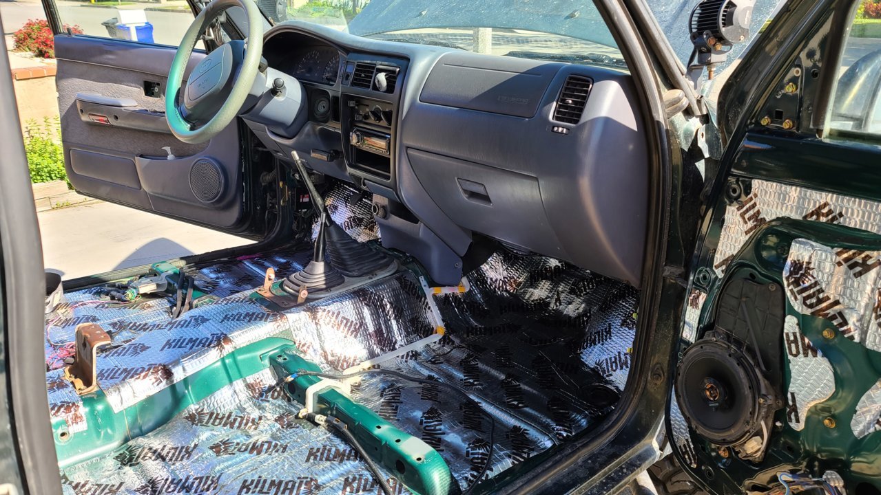

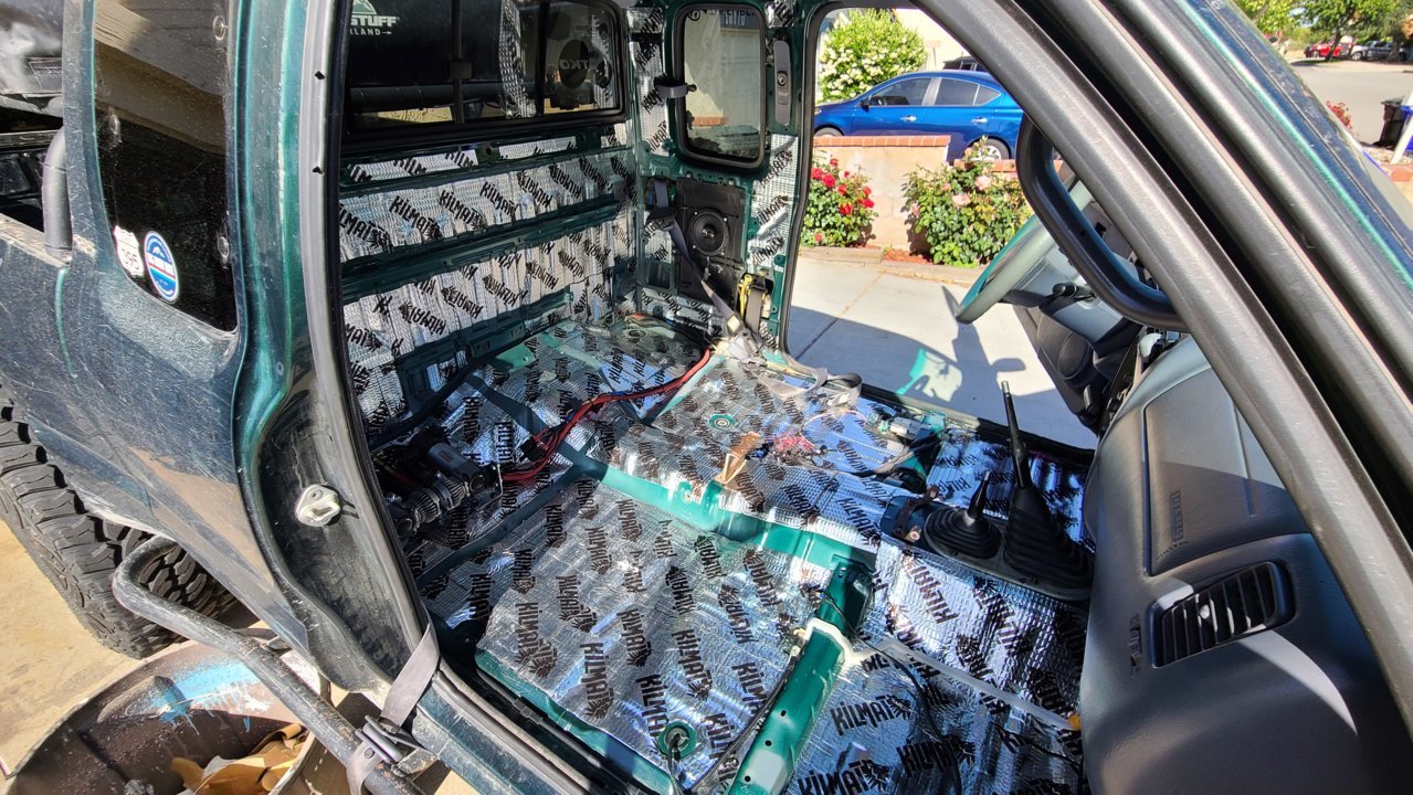

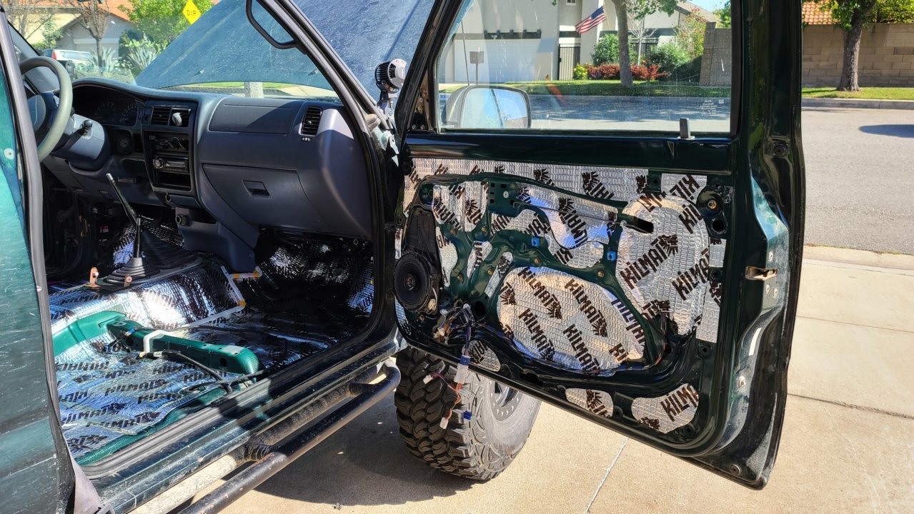

    Been a while since I updated this thread, and that's cause not much has gone on with the truck. I think the biggest upgrade in the last few months has been some sound deadening.
    I bought a pack of KilMat from Amazon and went to town. 1 Box was just about perfect for the extended cab. I'll get another box and do the roof when I cage it but for now the doors and floors will do.
    I wouldn't say the difference is night and day, but you definitely notice it. I find the biggest difference is less rattling on dirt roads and a more solid thud when shutting doors. I got a little carried away cutting full sheets in to small pieces so towards the end I was working with scraps. I'd recommend using as much as you can per sheet before grabbing a new one.
    OH and in the last pic you can see I finally hard mounted my air pumps. I cut out all the OEM tire changing tool holders which freed up a lot of space in those compartments.

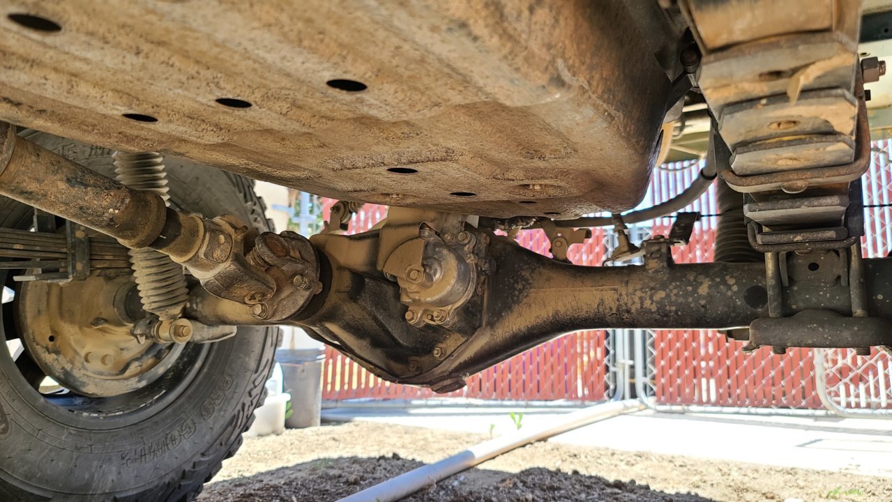

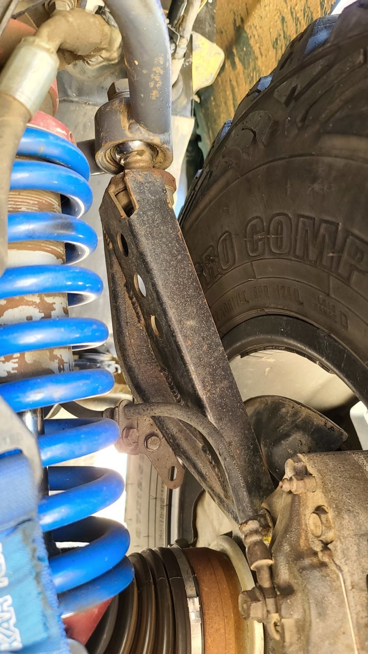

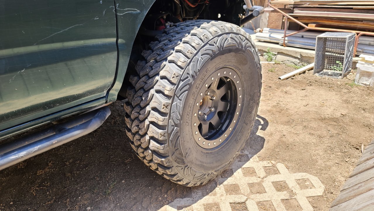

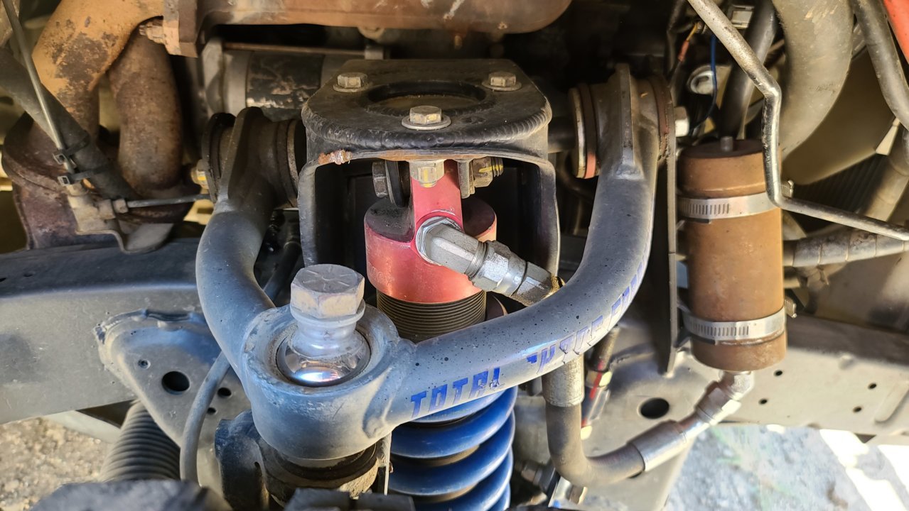

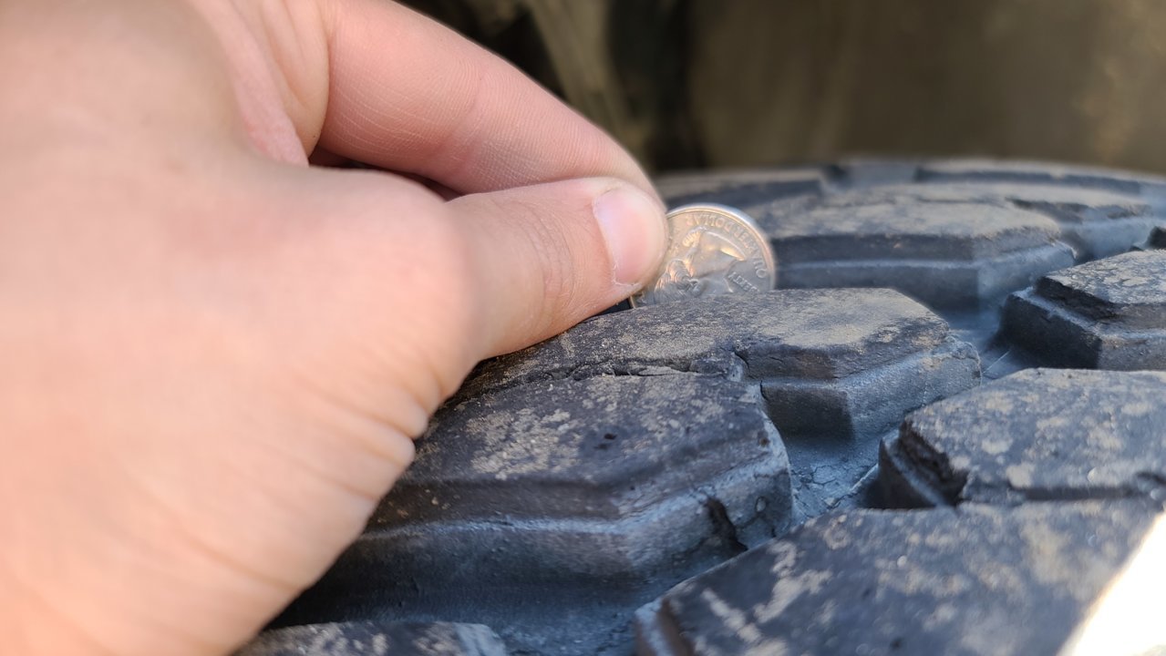

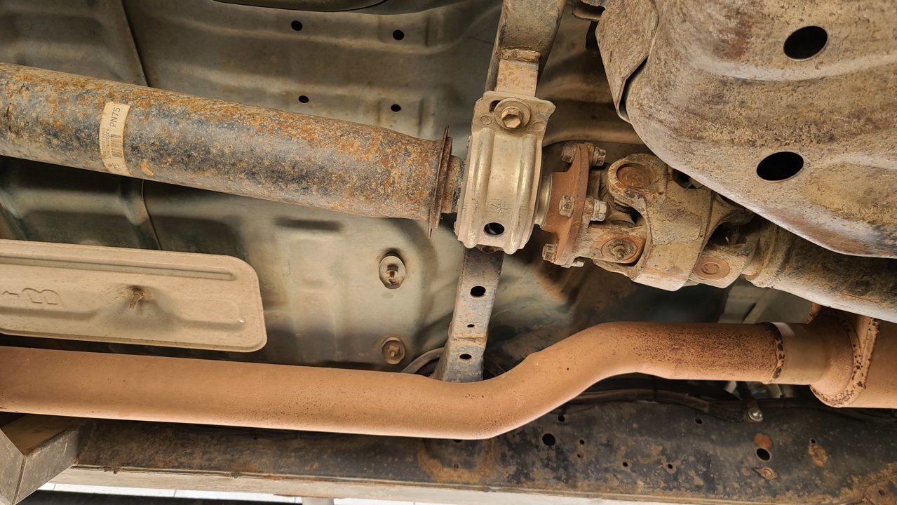

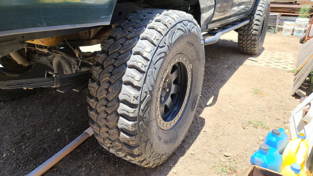

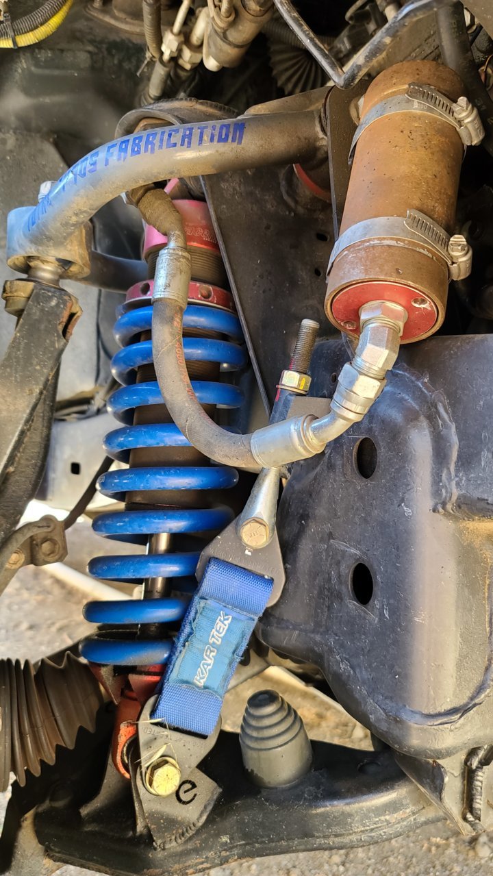

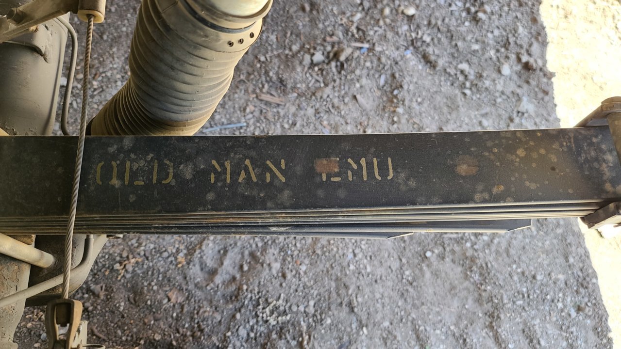

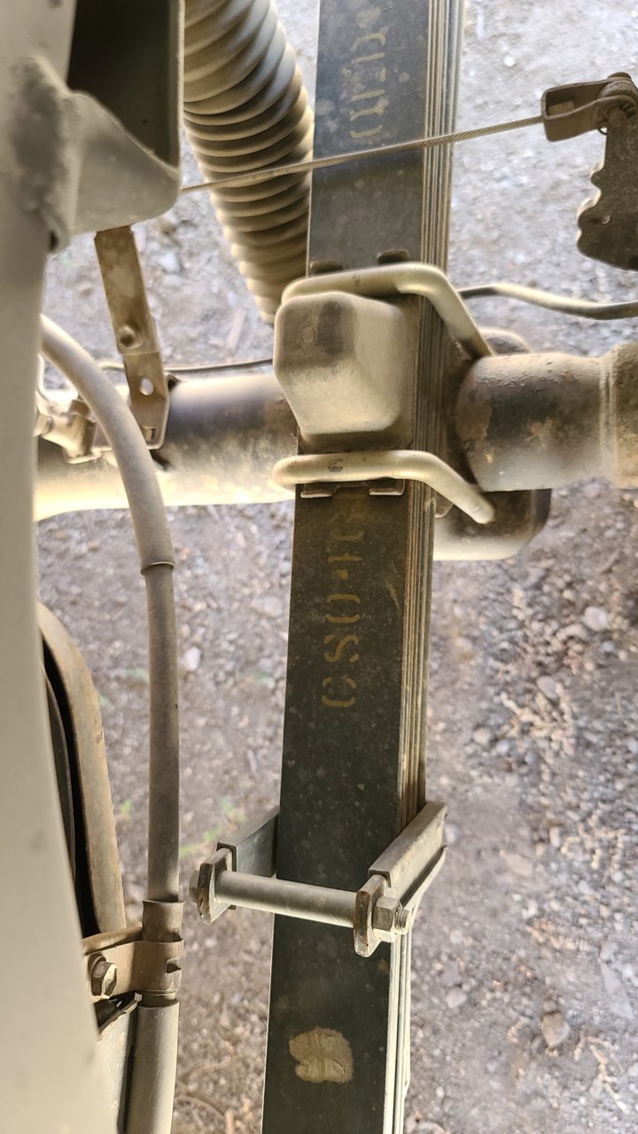

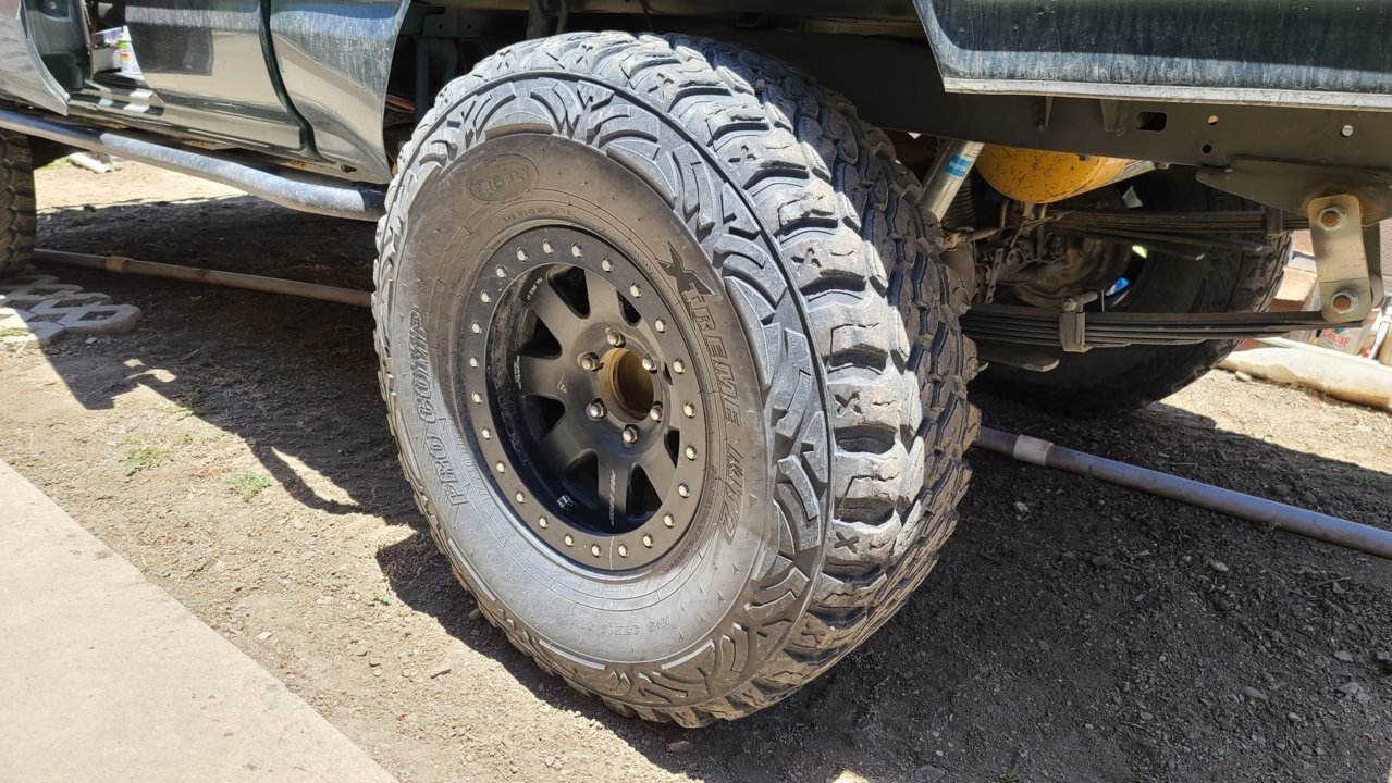

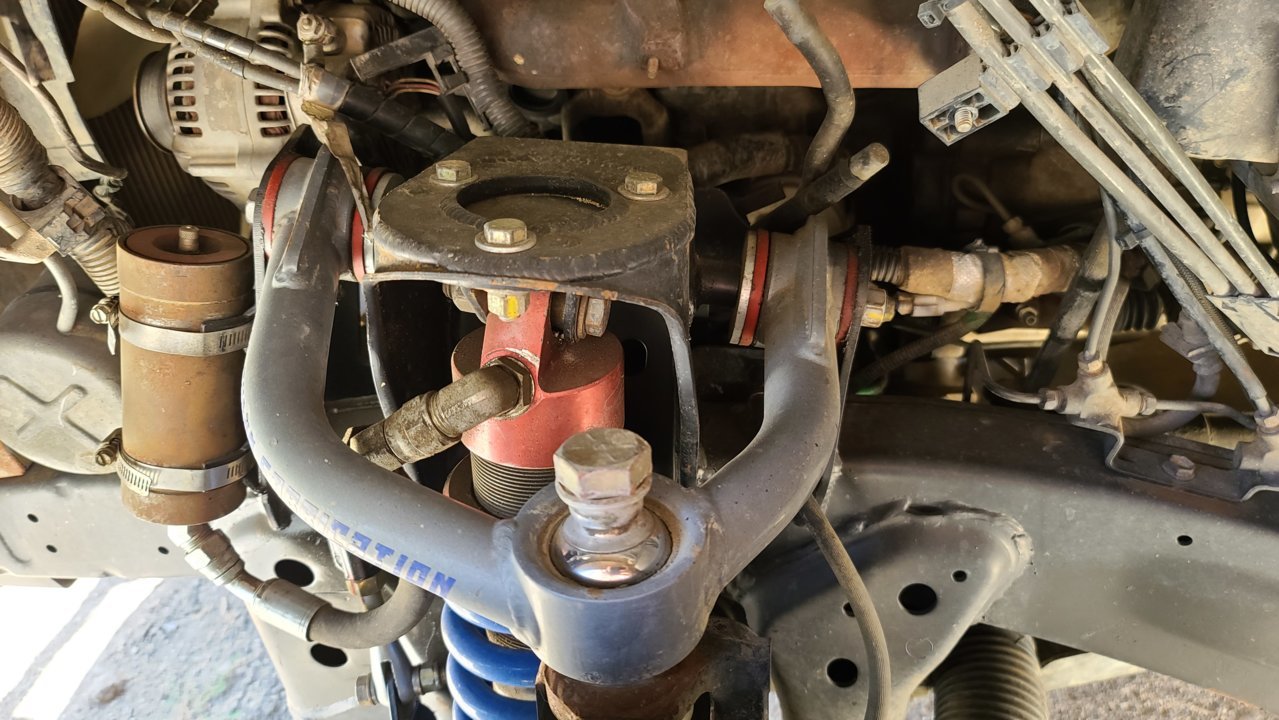

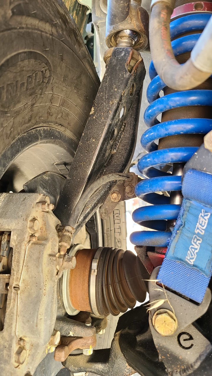

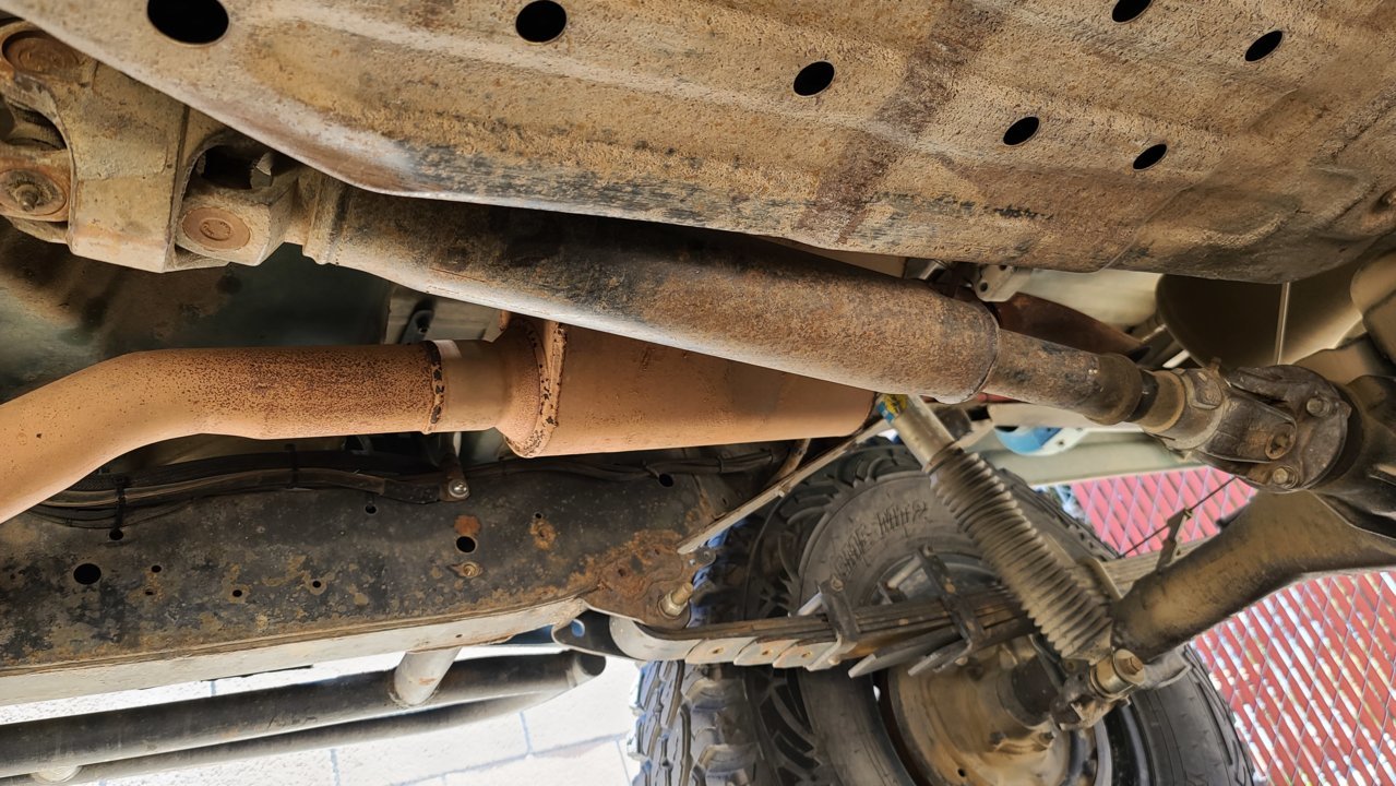

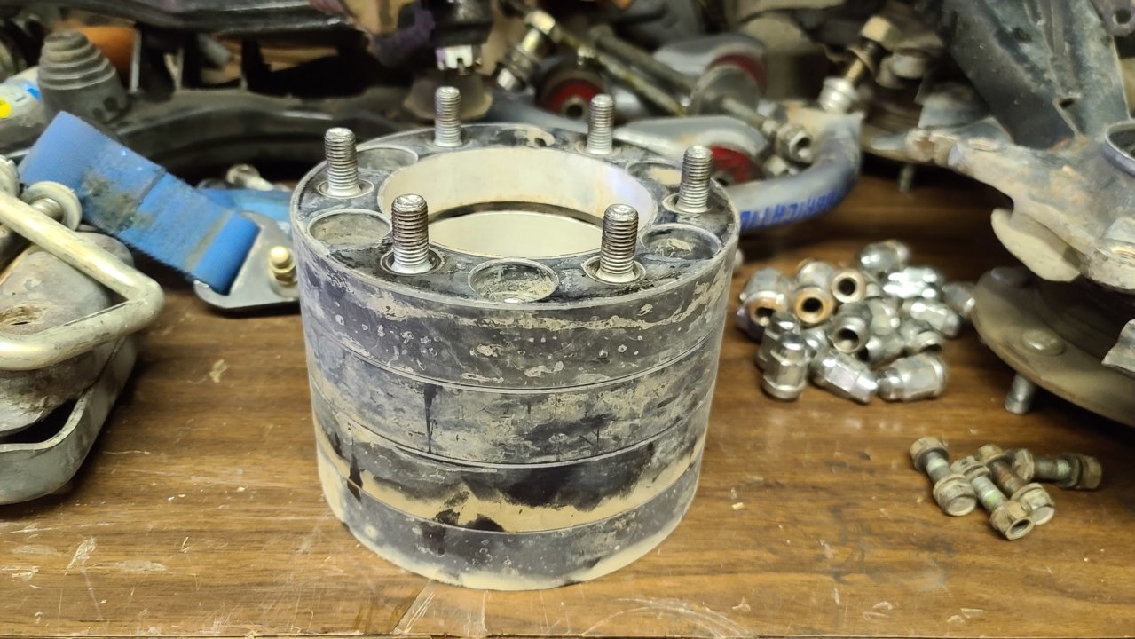

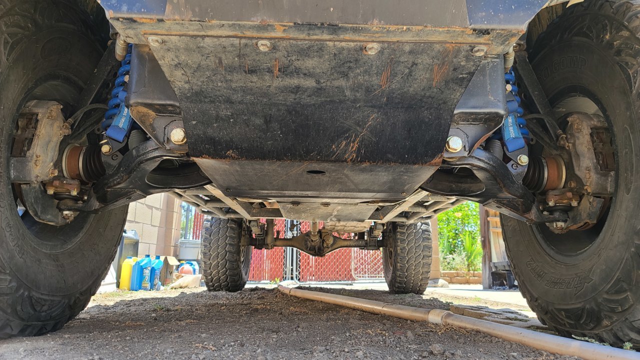

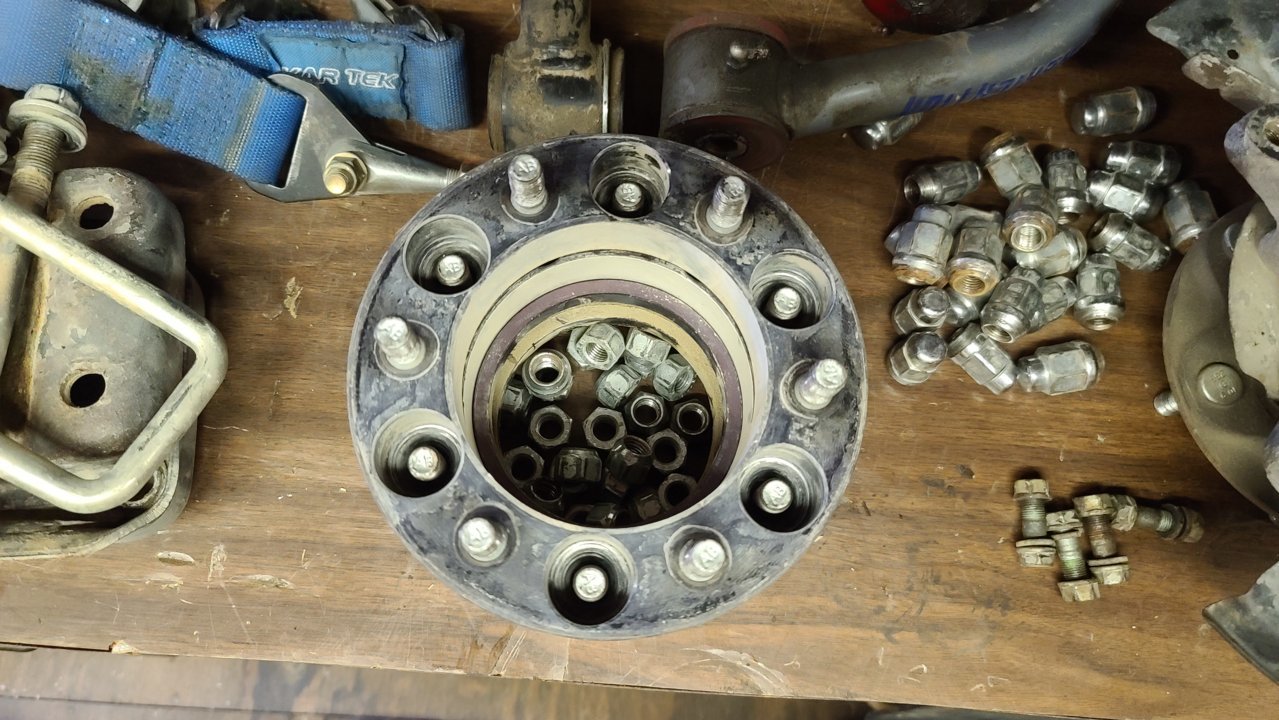

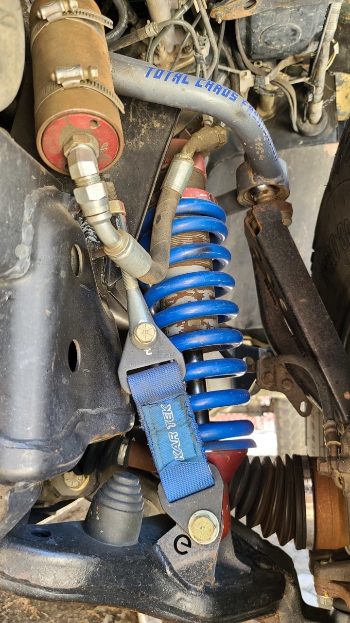

    Truck is parked, and so begins the great part out! I will be posting these parts in the FS forums, Instagram, and OfferUp, so if you see something you want just send me a message!
    I've kept track of all the dates & mileage parts were installed. Truck is currently at 272,101 miles.
    Here's what's available:

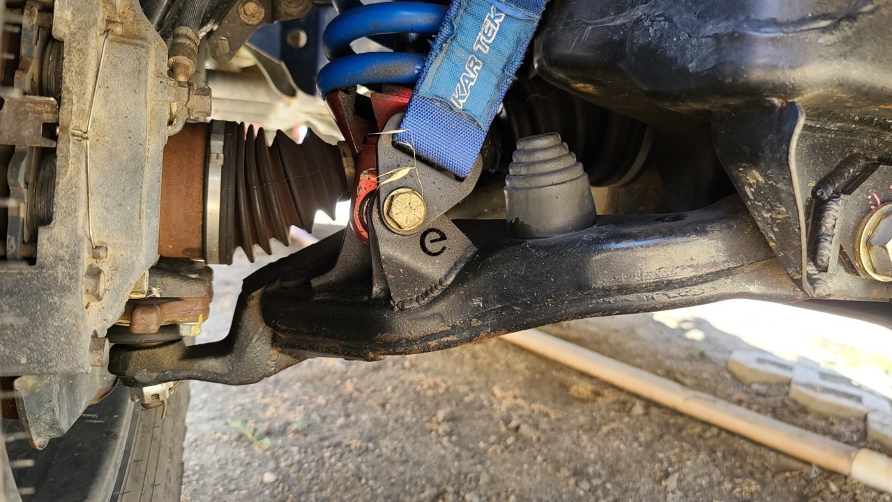

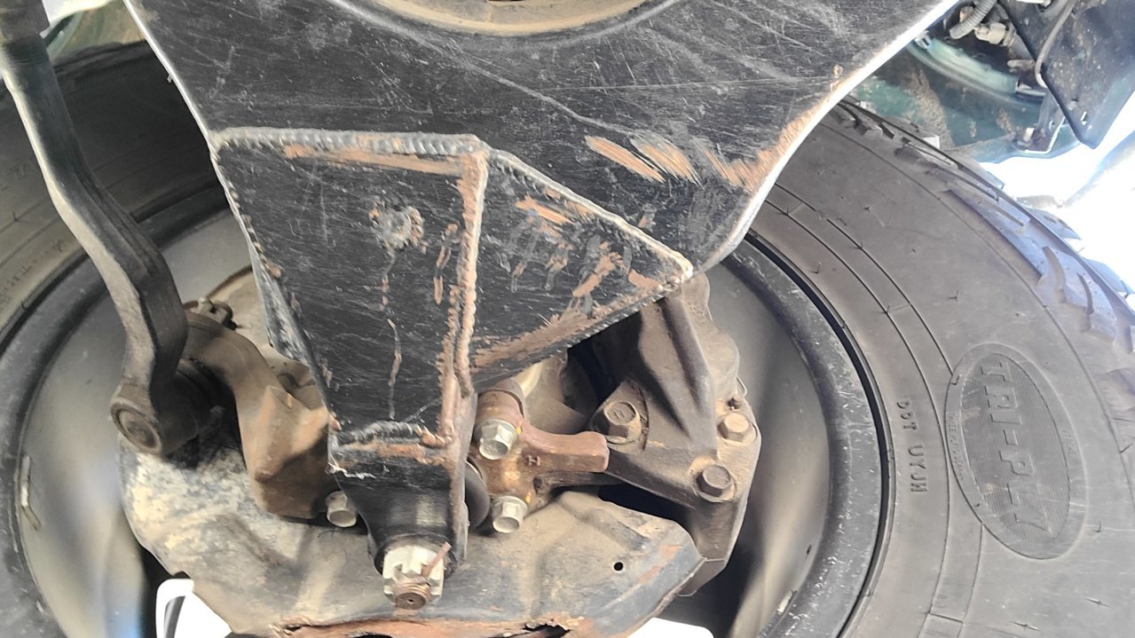

    Reinforced Lower Control Arms W/ Bushings
    What: OEM LCA with Eimkeith Reinforcements, Limit Straps, and WhiteLine Bushings
    Date/Mileage Installed: 11/1/2020 @ 253,500
    Price: $300 OBO
    Image(s):
    Reinforced Frame
    What: My frame with reinforced shock/LCA towers and Eimkeith coil over bucket reinforcements. Will be chopping this out. Great for a SOLID 4wd Swap
    Date/Mileage Installed: 7/20/2021 @ 270,022
    Price: $100 OBO
    Image(s):
    (See other pics for front of frame)

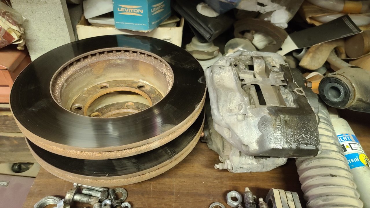

    Brake Calipers/Rotors
    What: OEM Brake Calipers and Rotors. Working great with no leaks!
    Date/Mileage Installed: Pads/Rotors: 1/16/2020 @ 244,608
    Price: $100 OBO for both, $60 each
    Image(s):
