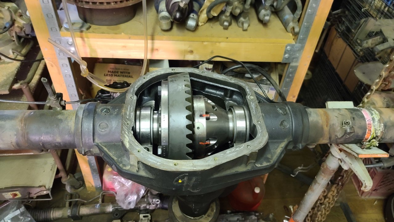

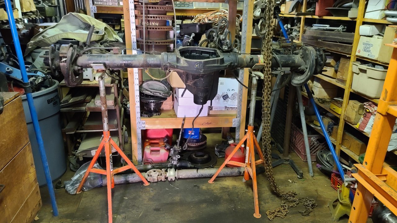

    Regear/locker install is starting! 1st step was getting the axle off the ground so I didnt break my back. I rigged up a VERY sketchy system using a chain hoist, the rafters, and some galvanized pipe to lift the axle about 4' in to the air to set it on my pipe jacks:
    Gonna watch a few videos/read some articles on regearing the 10.5 and then get to it!

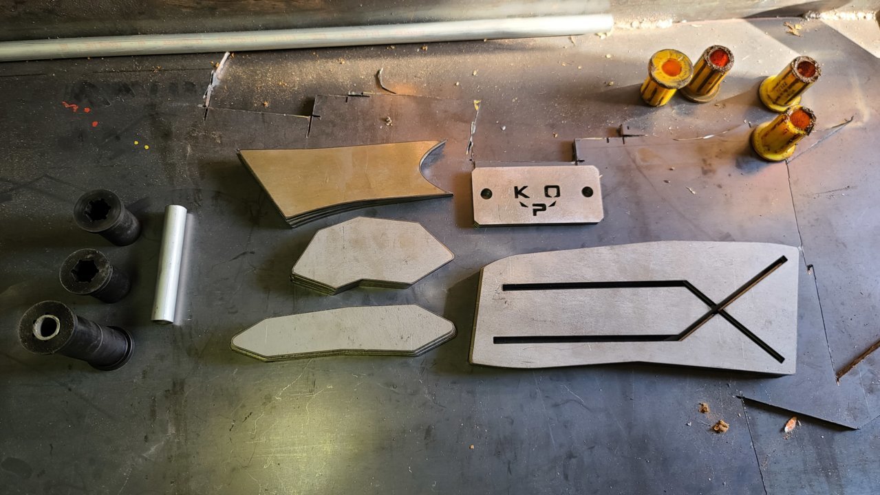

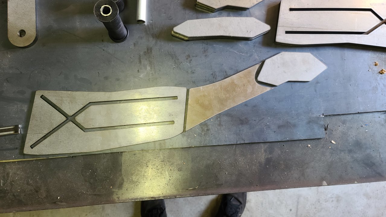

    Got my parts fresh from the laser! Frame plates and engine mounts. The KPO plate will be used to mount my motor while all the other pieces are for my frame. I also found a stainless steel tube on McMaster that works perfect for making the sleeves for my leaf spring bushings.

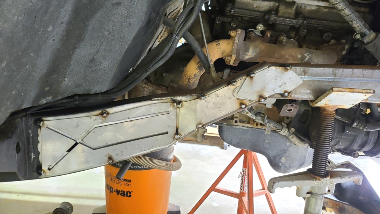

    Here is how the plates will sit on my frame. Should be pretty solid!
    Also started getting the gears/locker in the 10.5. Man these parts are heavy!

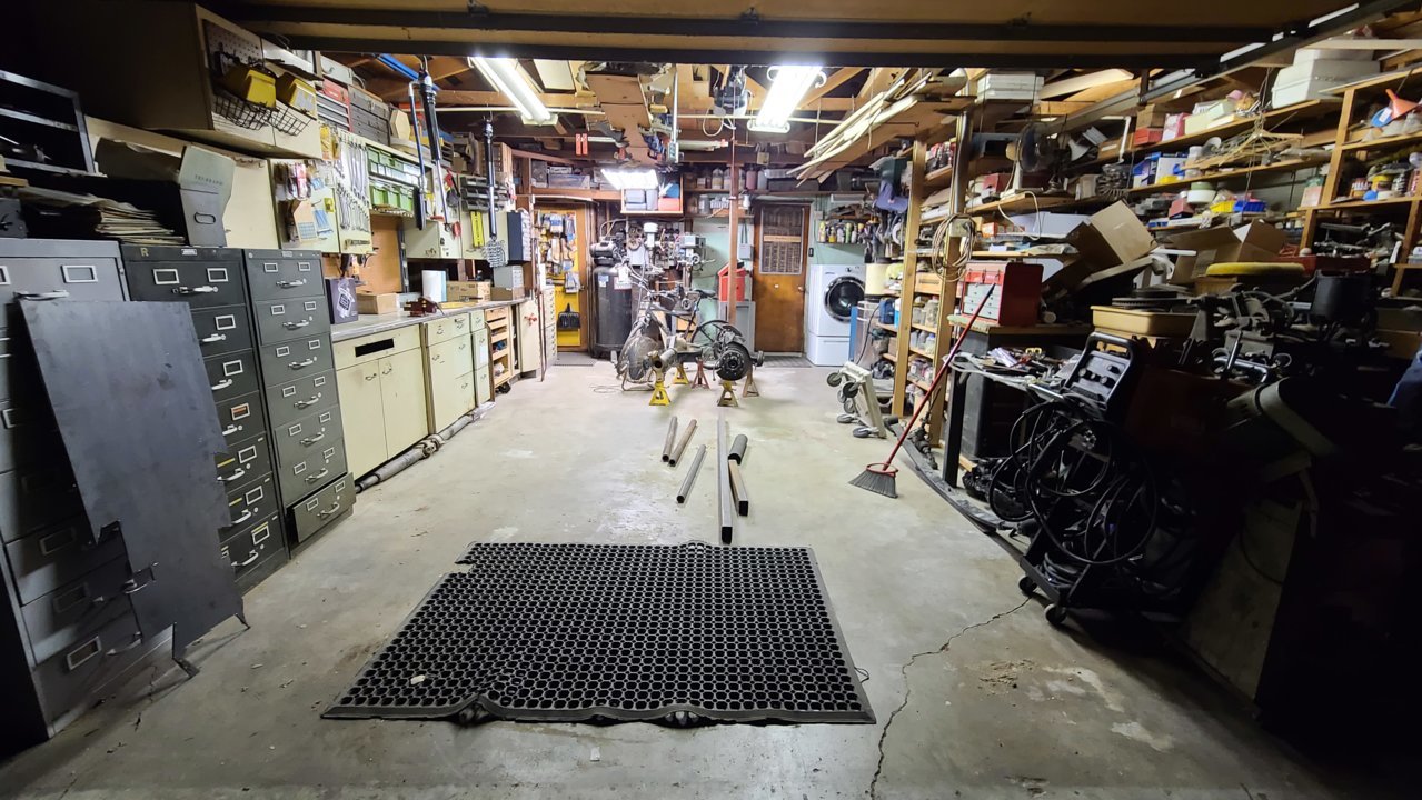

    Took a little break from building the Taco to work on another project (related to the Taco). I cleaned out my grandpas garage so I could work on the truck INSIDE a garage!20221028_021143.jpg
    I just finished getting it cleaned out the other night. I wish I had a before pic, you guys would have thought I was insane for thinking I could clean it out AND fit a car in it.
    I now have a 22'x11.5' space cleared for the truck. The garage measures 25'x24' but with the amount of stuff my grandpa has there was not way to clear out THAT much space.

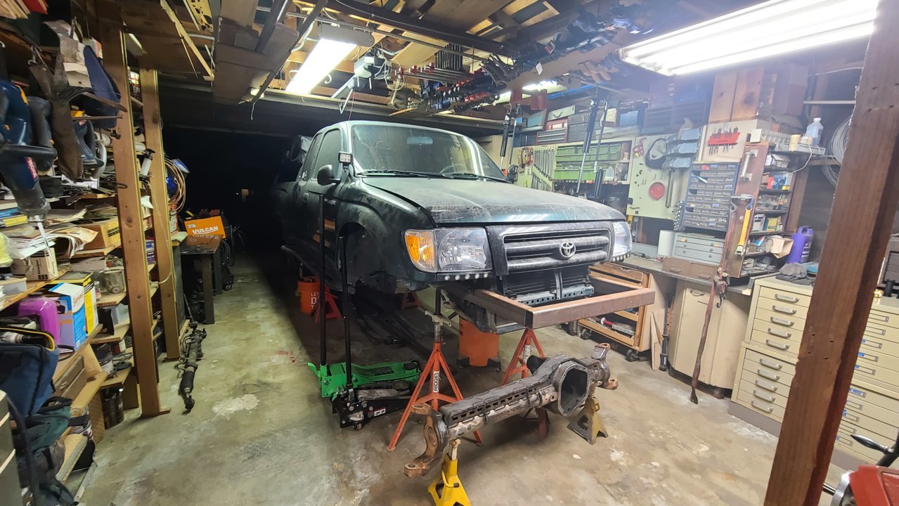

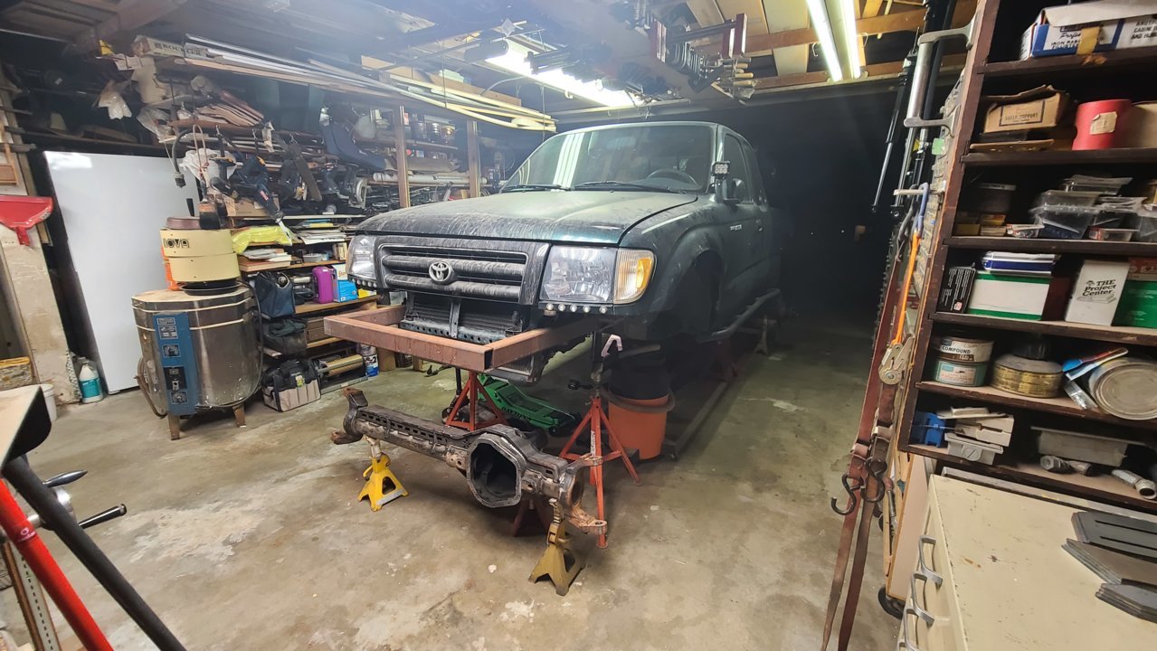

    Got the old guy in the garage!!
    Ended up renting a flatbed and with a little brain power my buddy and I were able to get it on the flatbed and offload it without hurting anyone or anything. Super stoked to start working on this INSIDE!!

    Started getting my frame plating in. So far it's looking pretty good! You really gotta put some big tacks on the plates to be able to hammer them around the contours of the frame.

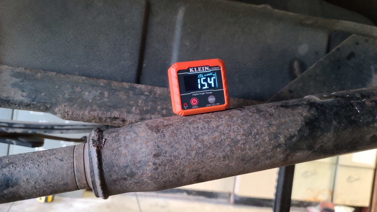

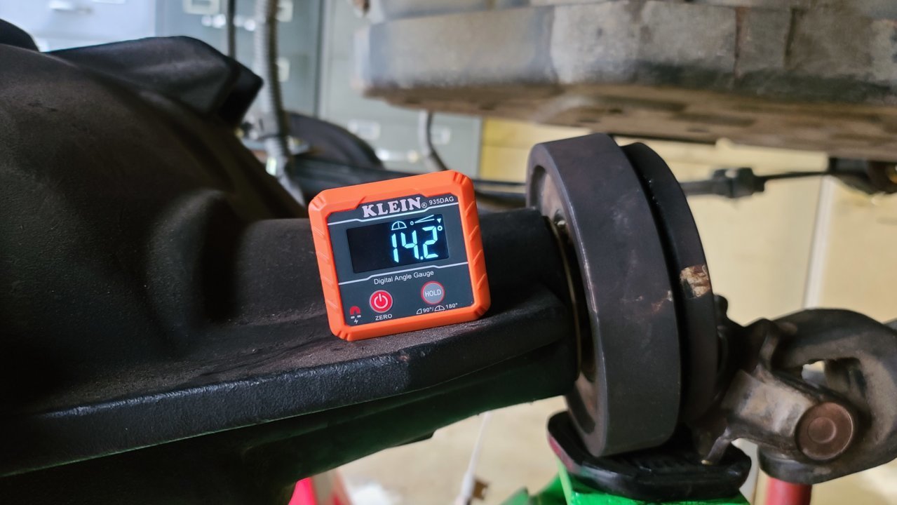

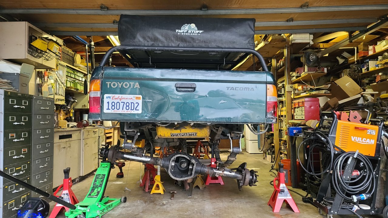

    Started getting the rear axle in!
    I am a little stuck on the pinion angle tho. From what I was reading the Taco has a double Carden joint so the pinion should be in line with the drive shaft:
    So that's what I did and it seems super steep. I set the pinion ~1.5° lower then the DS to account for acceleration twist. Thoughts?
    cbechtold and ToyRyd04 like this.
  20. Nov 8, 2022 at 3:32 PM
    #280
    ToyRyd04
    ToyRyd04 Taco Transformer
    Aug 5, 2011
    #61217
    1,873
    Greg
    Perryville, MD
    '04 PreRunner
    SAS'd PreRunner Diamond Axles Crawlbox
    If your keeping the 2 piece driveshaft, point the pinion at the carrier bearing support. Then set pinion 1-3* lower to counteract axle wrap/pinion rotation on acceleration.
