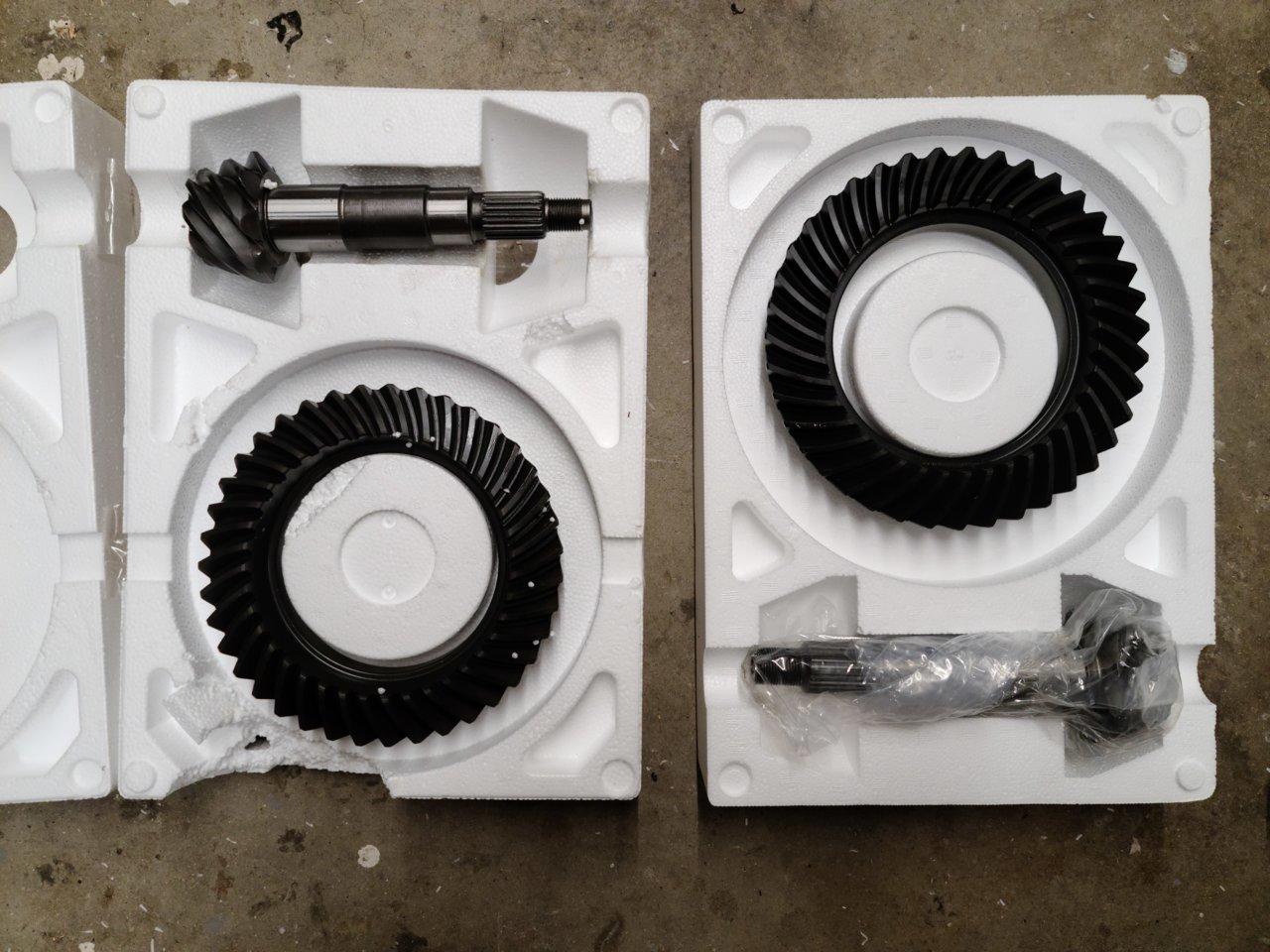

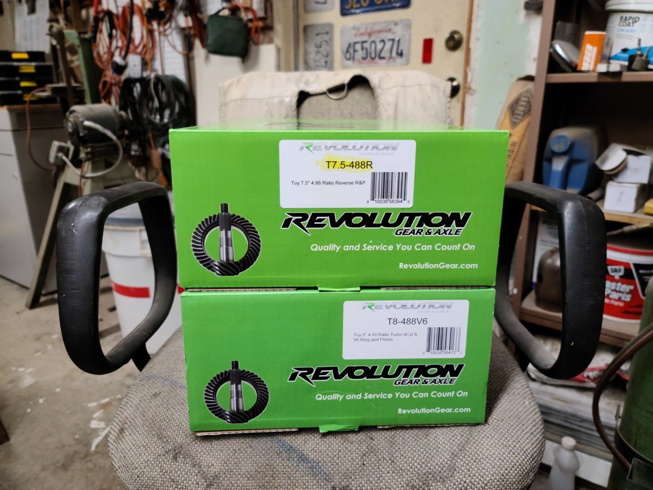

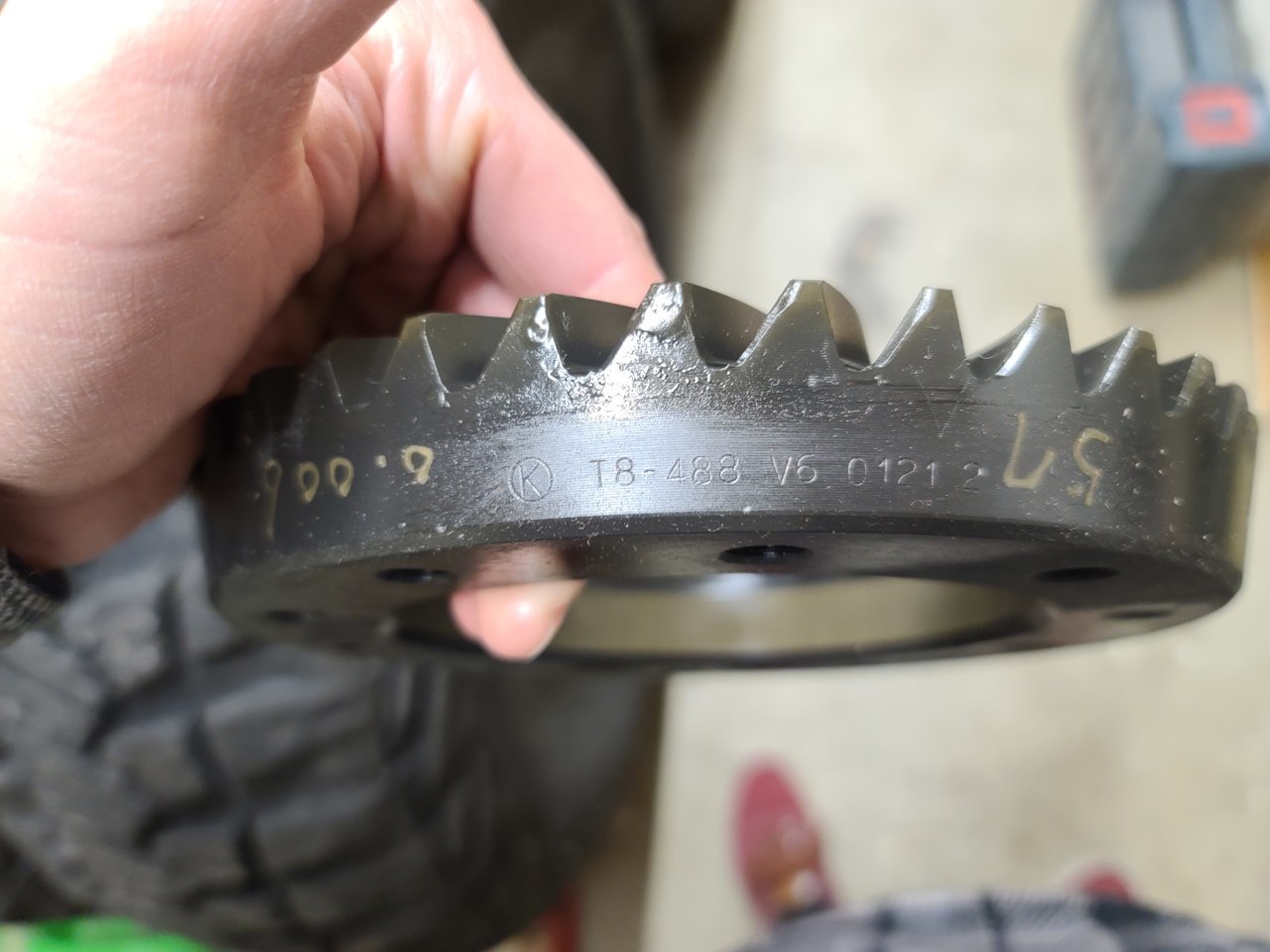

    Got gears and wheels ordered today! I went down to Yotamasters and talked to them about my awful plan. They said I was crazy but recommended I get 4.88 gears because they are a little bit stronger especially on the already small 7.5" front. Went ahead and put an order in for 4.88 front and rear gears, a master rebuild kit, new bearings, and a front Spartan locker. Front rebuild and locker will be here end of next week. They had the rear rebuild kit, bearings, solid spacer, and both sets of gears in stock so I went ahead and took them home today:
    Total cost for everything was 1,188.54 through my boy at Yotamasters, not too bad!

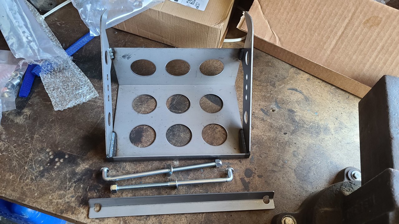

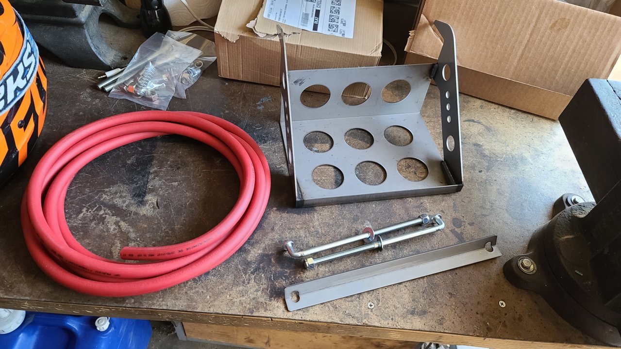

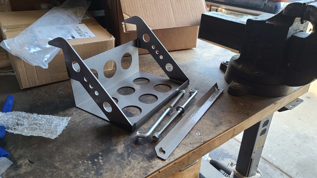

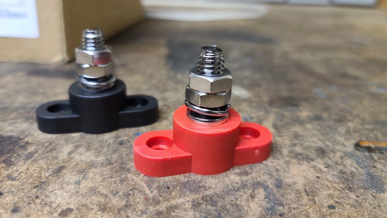

    Here are the items I bought for the relocation:
    • 15' 1 Gauge solid copper wire
    • Battery box
    • 1 gauge lugs
    • Terminal Posts
    I called Kartek for my battery box but they didn't have any that would work with my battery. I just bought this one from eBay, seems decent enough quality but only time will tell.
    The plan is to get the battery under the bed near the gas tank on the passenger side, run a ground to the frame, run a positive to the engine bay using the wire, and terminate it at the post terminals:
    I'll tie everything that's currently on my battery to the post terminals and run a ground from the frame to the new negative terminal.

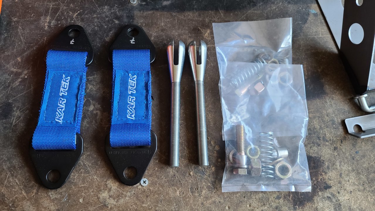

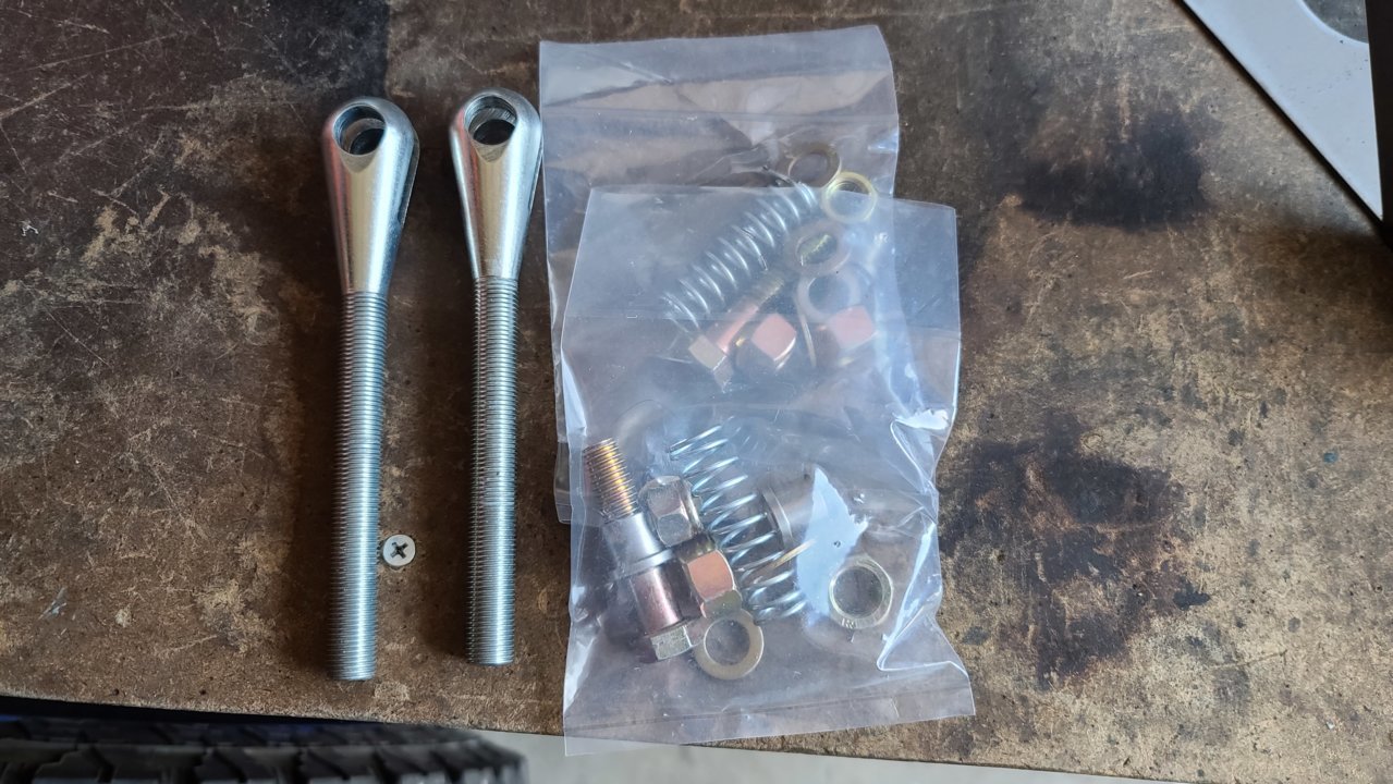

    I also got my limit strap hardware. 2 adjustable Trail Gear clevis's and 2 7" limit straps. I also have tabs to weld to my frame. Should be pretty easy, my biggest concern is my coil overs interfere with the strap, but I guess we'll see.

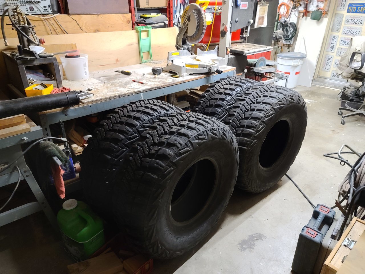

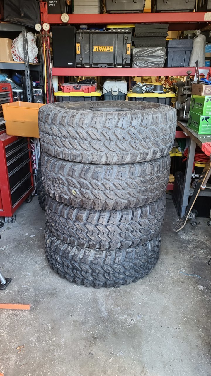

    Little update on my tire selection: I liked the Kevlars but upon looking more closely at what I bought I realized they were really old (2012-2013) unevenly worn, had bad rock rash, were cracking, and about 40% used. I wasn't really happy with them but I mean they were cheap.
    Anyway yesterday I decided to sell them. I managed to get $800 for them (what I paid) with the intention of saving up for some new tires. Then by some miracle someone posted these basically brand new 37x12.50r17 Pro Comp Extreme MT 2's for $800! The guy selling had no idea what he had. I checked them out a little more carefully this time and I couldn't pass them up.
    No cracks, 21.5/32 tread depth (new is 22/32), evenly worn, no cracks or rock rash anywhere, and even better they are all 2019/2018 tires, so basically new!
    I will feel much better driving with these guys and more confident they won't explode on any road trips. Definitely worth it!

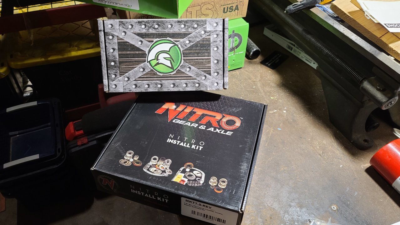

    Finally got some parts so I can start working on this thing!!
    Spartan locker and differential rebuild kit for my front diff.
    I've had the rear diff parts for about a month now and these guys finally came in to YotaMasters!! Looks like the next week or so will be gear and locker time!
    Broke Okie Ty likes this.

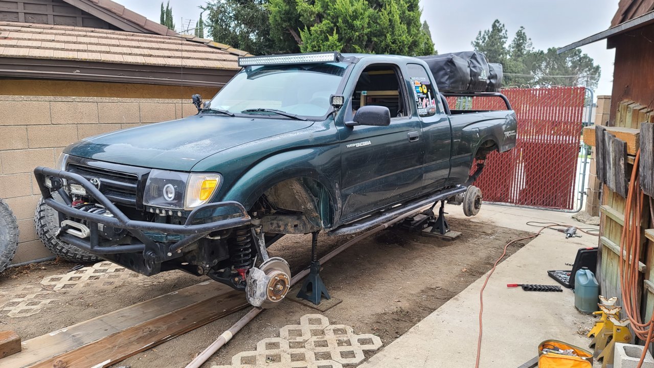

    The work has finally began!!

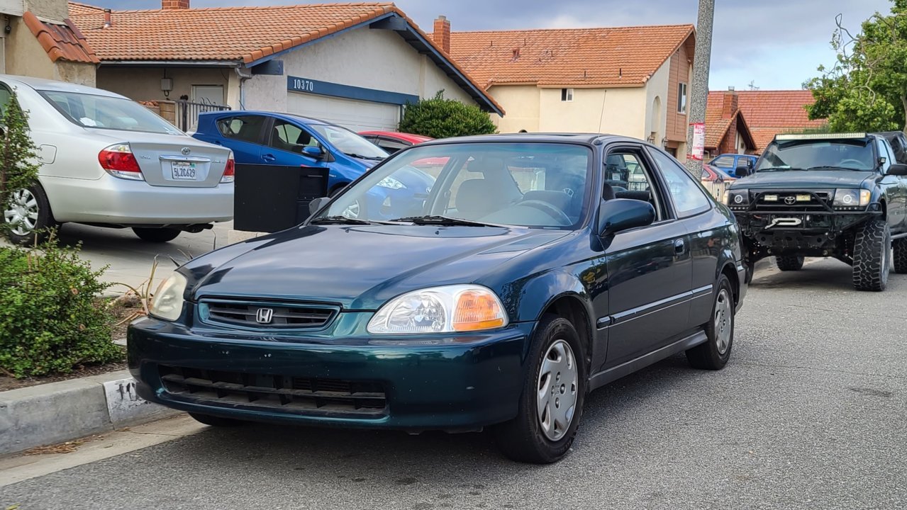

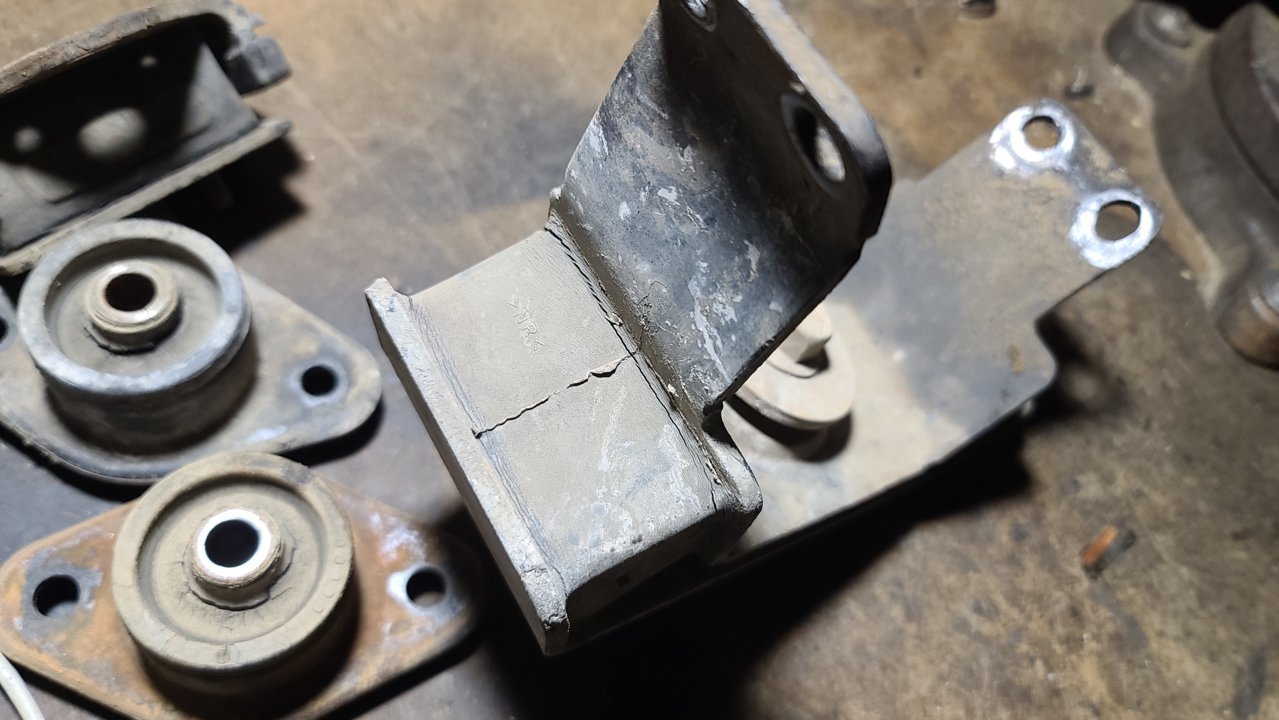

    Part of the reason I have been procrastinating is because my truck has been my only vehicle/daily driver. I have been applying to jobs since I've finally graduated and I needed to make sure I had a way to get to interviews and a job when I got one. After 4 months I finally landed my 1st real job! I'm pretty excited to start. On another note, due to a complete accident I somehow made a good chunk of change in Doge Coin. I decided to use this new found "wealth" and invest in a commuter car. Here it is:
    A 1 owner, garage kept, 1996 Honda Civic EX. It has 310k miles on it (I know, it's a ton!!), it's 5spd, and it's AMAZING on gas. Believe it or not, you're looking at the original paint too! It was owned by an older lady who took very good care of it. It was put on non-op 6 years ago so it needs a few things (wheel bearings, A/C recharge, tires, trans fluid, etc.) but I've been driving it for the weekend and so far it seems pretty reliable. Since I have a daily and a job I can finally start digging in to Frank, so let's get in to that:

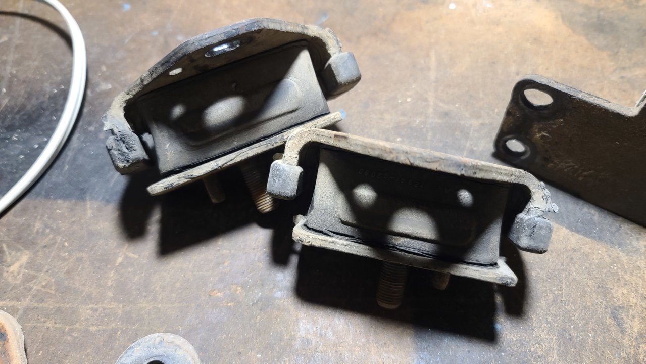

    Body, Engine, and Trans Mounts:

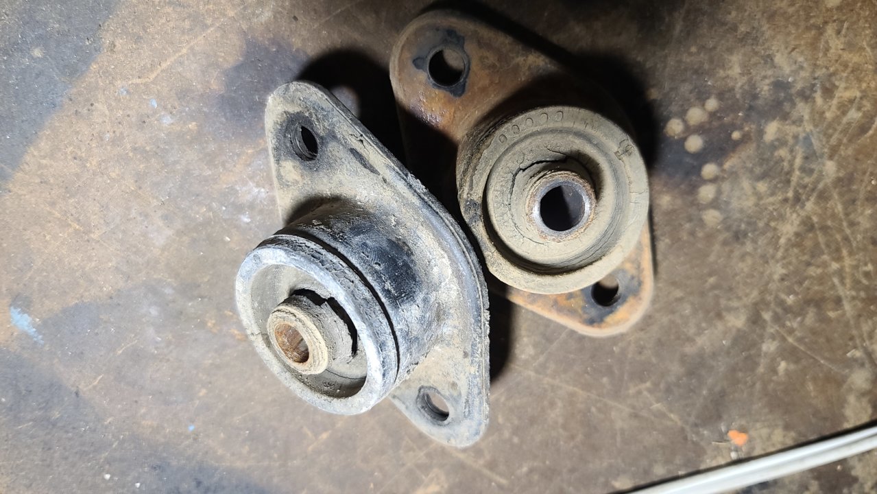

    Started with the mounts. My body and engine were clunking around so I figured it was time to replace the mounts. I used Energy Suspension body mounts and RockAuto special trans and engine mounts. Talk about a PITA on those engine mounts. Took me about 3 hours to get one side done. Never. Again.
    Looking at the old mounts you can tell they were about done.
    Engine mounts cracked all the way through.
    Trans mounts starting to crack.
    Body mounts completely separated.
    The new mounts made the truck feel new!
    Gears:
    Didn't get far on these today, just got the truck in the air and the wheels off. I brought the truck to my grandparents where they wouldn't mind if it sits on jack stands for a while. My plan is to get the gears done this week. I am going to tackle this job myself (famous last words...) I found the FSM for the job and I plan on following it to a T.
    I'm hoping to have the front and rear diffs out tomorrow, regear them Wedsnday, and reinstall them Thursday/Friday.

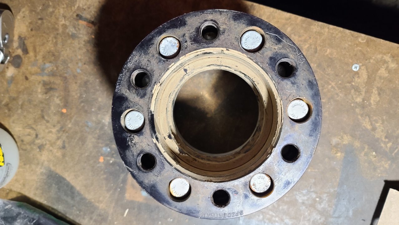

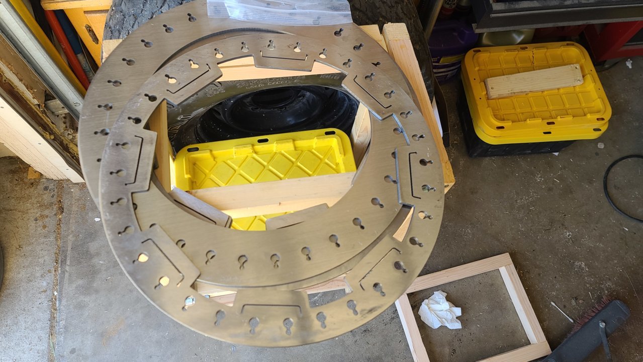

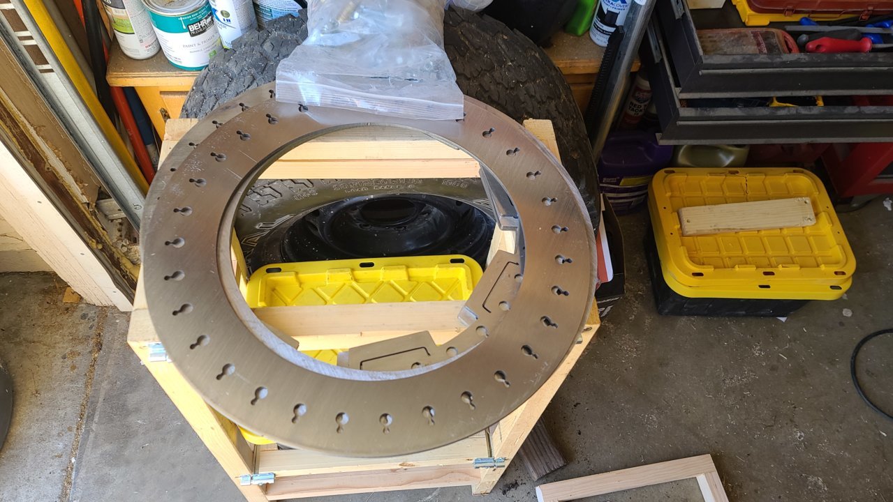

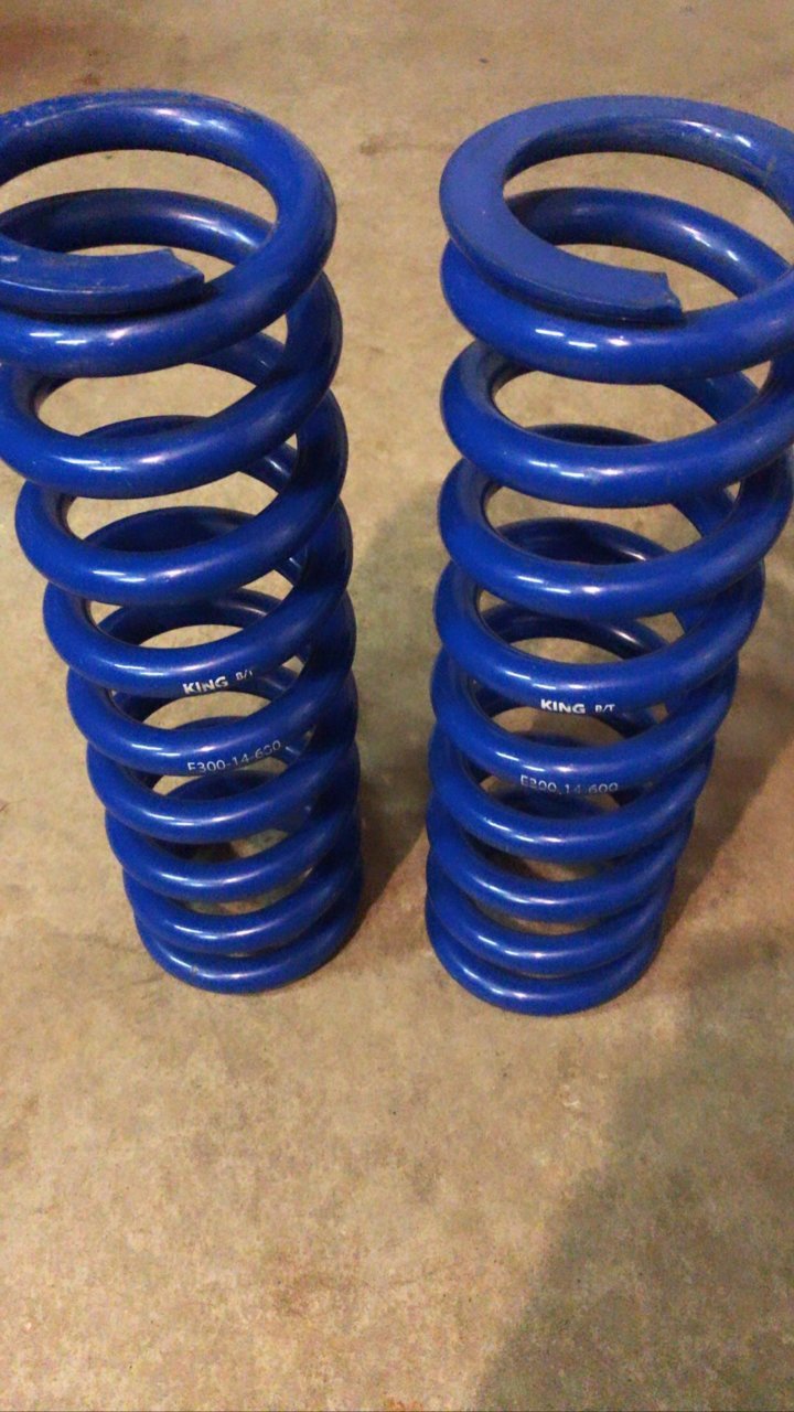

    Finally some more parts have started showing up to add to my pile! My beadlocks finally came in after 2 months of waiting:

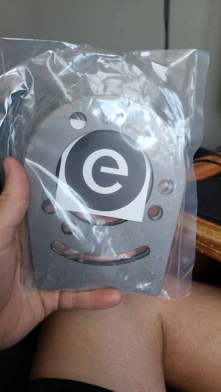

    An EimKeith upper coil bucket reinforcement kit:
    And some proper springs for my coilovers:
    They are new 600lb X 14" King springs. I wanted these springs because I have been running Bilstein strut springs on my coilovers. No idea if that's bad or not but I figured it wouldn't hurt to put the proper springs on.

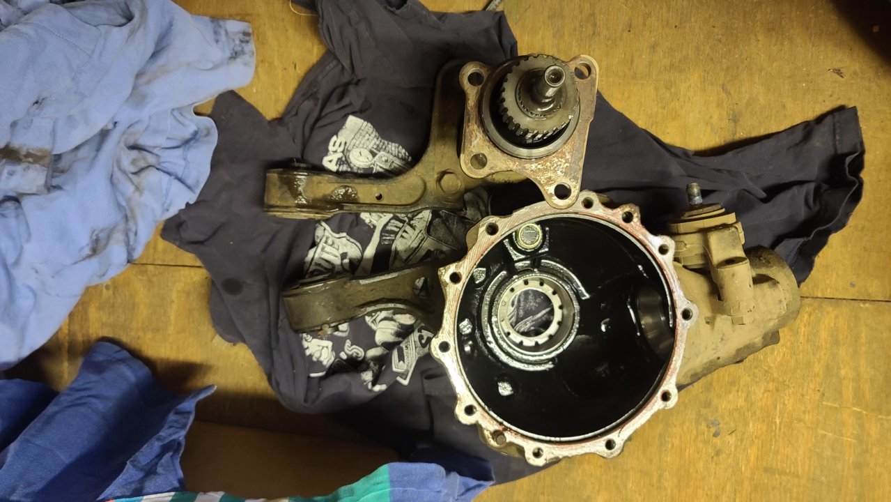

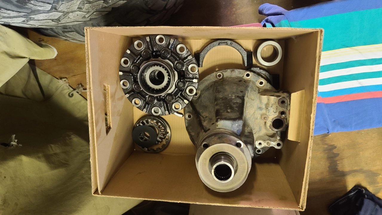

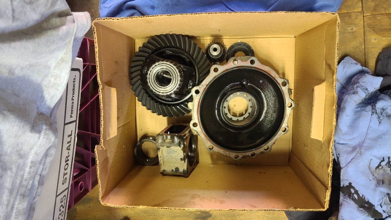

    Got the differentials out!
    I was worried the front diff would be a massive pain but thankfully it came out pretty smooth. I jacked the diff up to unseat the bolt in the back, slid it forward so the bolt wouldn't drop back in the hole, lowered the front, and used a small pry bar to shove the bolt off the cross member. Then it just rolled on to the floor.
    The rear was also very straight forward. I followed a nice guide from a fellow TW member. Didn't even need to take the brake lines off. I will need to remove them when I replace the seals but all I wanted to do today was get the diff out of the truck.

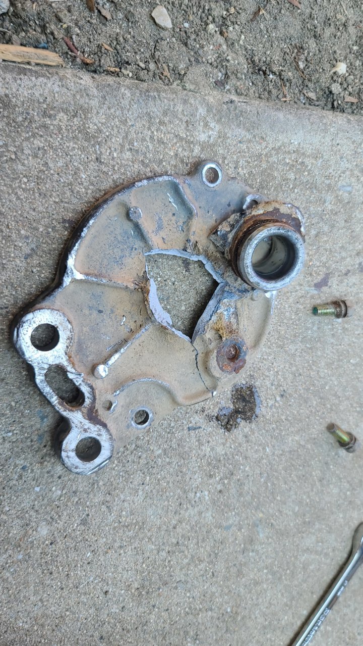

    What I did screw up was the stupid e locker actuator.
    As you can see it was very rusted in there and when I was prying it out it snapped the aluminum casing. I'm going to need a new one which sucks but ya live and learn. When I install the new one it will get a liberal amount of antiseize!

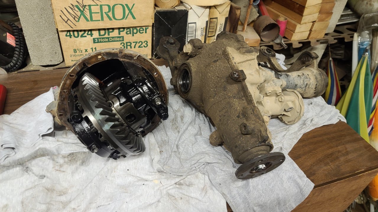

    I spent the entire morning trying to set the computer in the Civic reset so I could smog it. The little bastard is being suborn and not setting the Catalyst system monitor to ready so after 2 hours of driving around I gave up and decided to work on the truck.

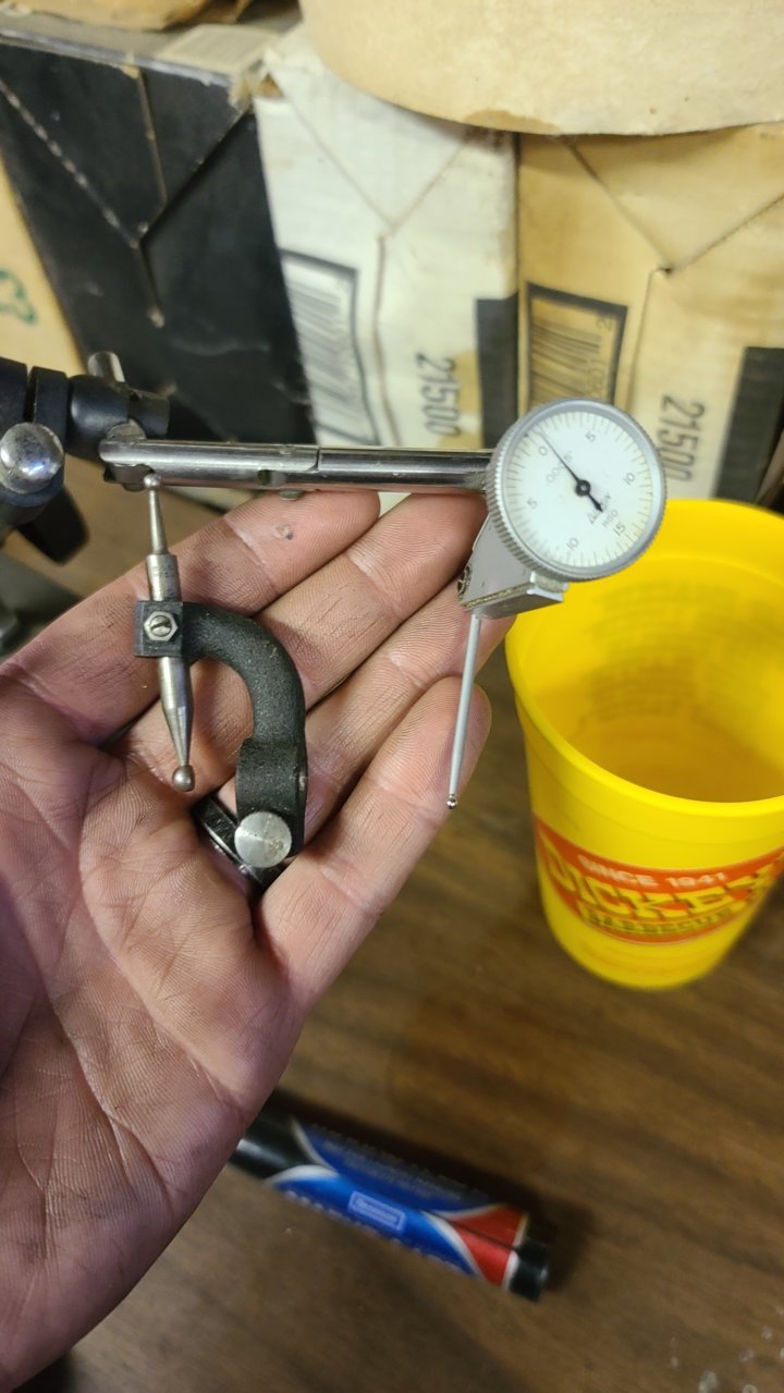

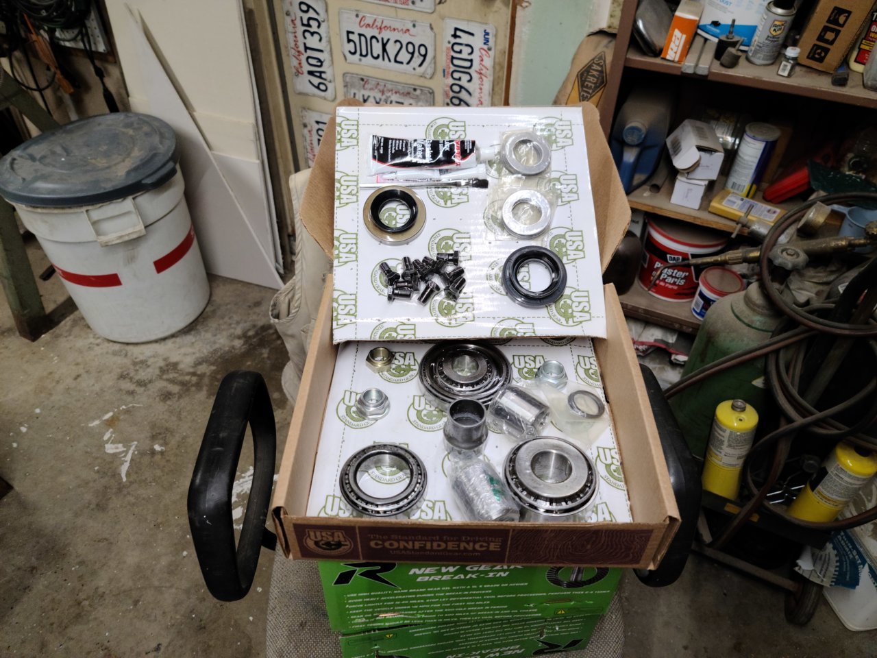

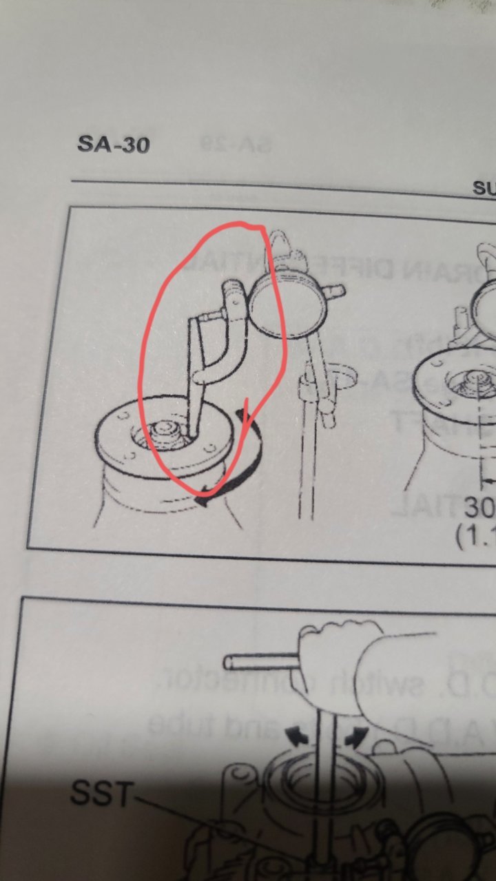

    I started by printing out the FSM gearing pages so I could take it in the garage with me. On the 1st page I noticed they were using a bizarre attachment for a dial gauge. I have never seen an attachment like that before.
    I spent the next couple hours figuring out what that thing was (indicator hole attachment) and then hunting for one at all the local hardware stores. Anyone I called had no idea what I was talking about. Right when I was about to give up and order one online I got a call from my grandpa saying that he actually had one lying around. I checked his garage 1st but somehow I missed it. Thankfully he remembered where he hid it and was able to get it before I spent $70 on a new one! He also had a test indicator too!

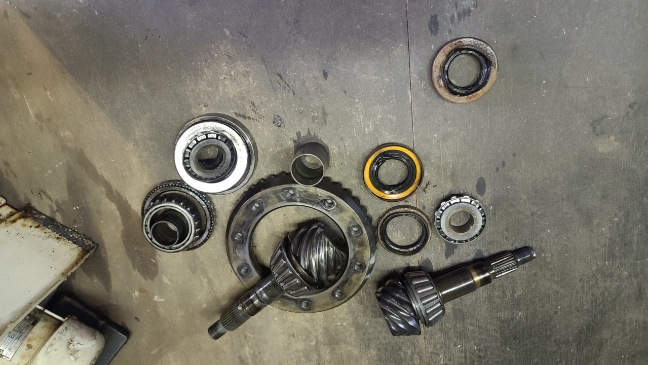

    Now on to the tear down! I started with the rear diff because it was more simple. This came apart pretty easy. I was able to get all the bearings and races out with a hammer and some punches which was nice. The service manual wants you to spend a small fortune on specialized tools which I wasn't about to do.
    Torn apart and ready for new gears!
    The clam shell was a little more difficult. This one is critical that you follow the manual. Doing things out of order makes it harder on you down the line, trust me. It still isn't completely apart because I left my good pullers at home and I couldn't get one of the bearings off. Tomorrow I'll bring my collection of pullers so I can finish getting that apart.

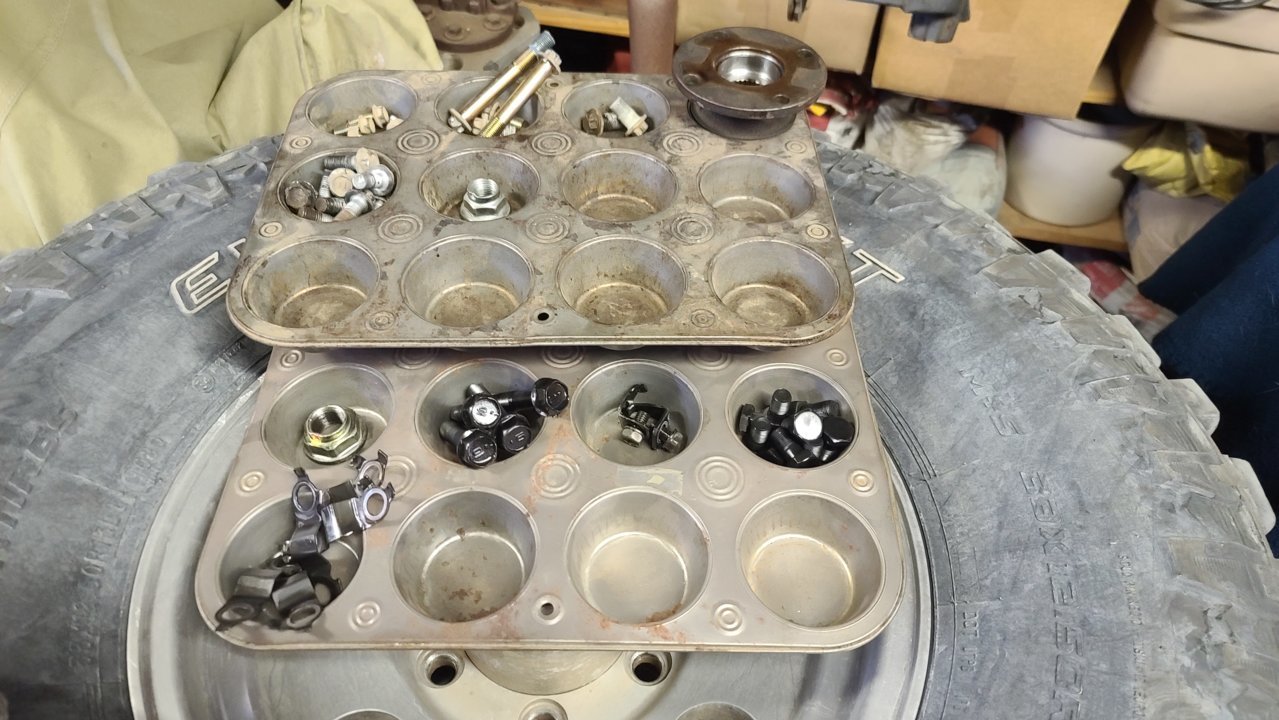

    Gotta stay organized too! I found using old muffin tins is a great way to organize bolts and keep them off the floor, I highly recommend.
    My favorite part about replacing parts is building up the pile of old parts. The bigger the pile the more satisfied you are at the end of the day :)
    Gonna go back tomorrow and get that clam shell stripped, everything cleaned, and start the re assembly process! Wish me luck...

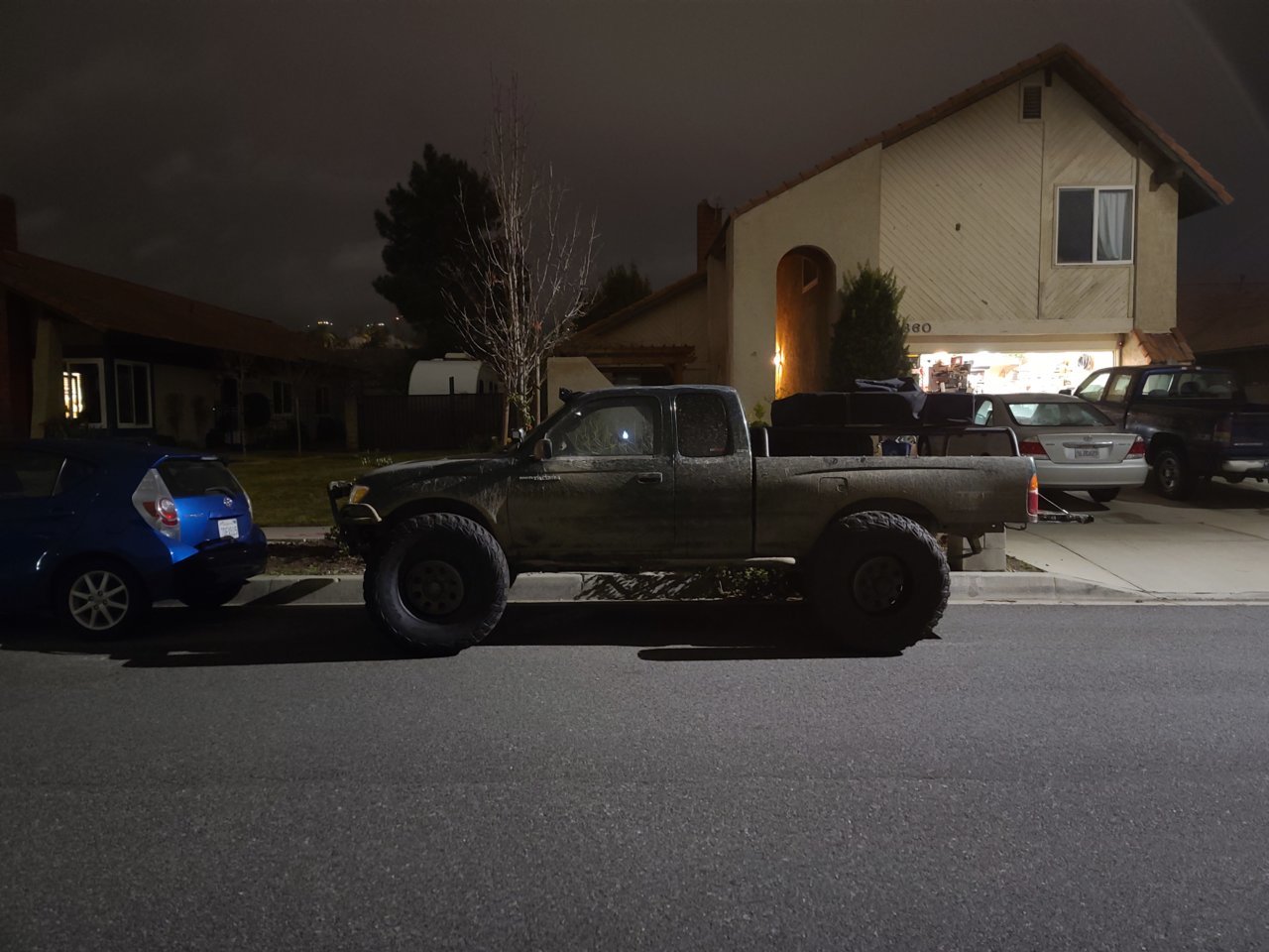

    Are you still running without a rear fender? Run into any issues with the police regarding it?
  19. May 22, 2021 at 11:54 PM
    #99
    ForestRunnerFrank99
    ForestRunnerFrank99 [OP] Well-Known Member
    Mar 10, 2019
    #286162
    1,108
    Josh
    Rancho Cucamonga, CA
    '99 TRD 4x4 Manual 3.4l v6
    Fox Coil-overs, Dakar Leafs, Intake, Tires, Rims
    I don't have a rear fender, bumper, or lights on my license plate and so far so good. I'm honestly kinda suprised.
