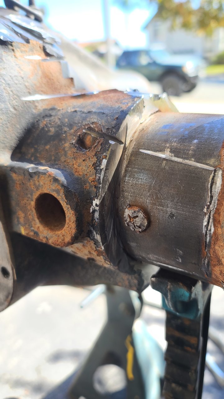

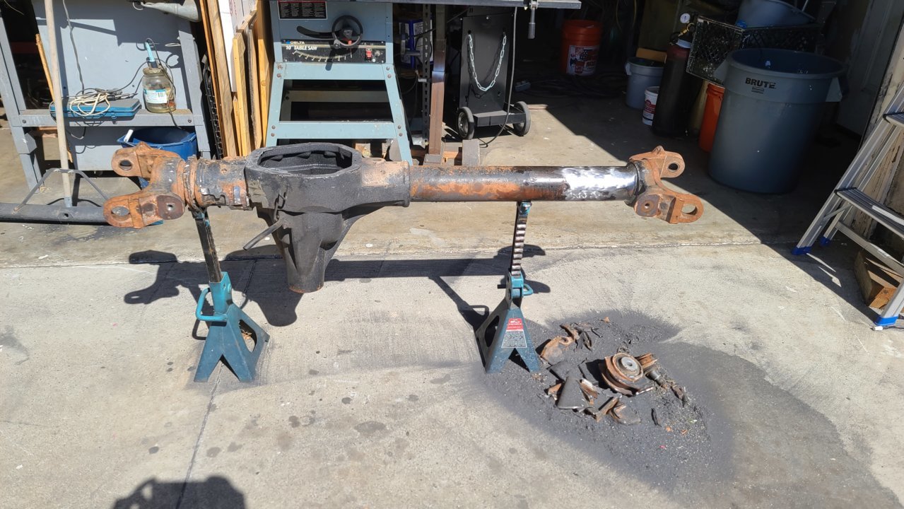

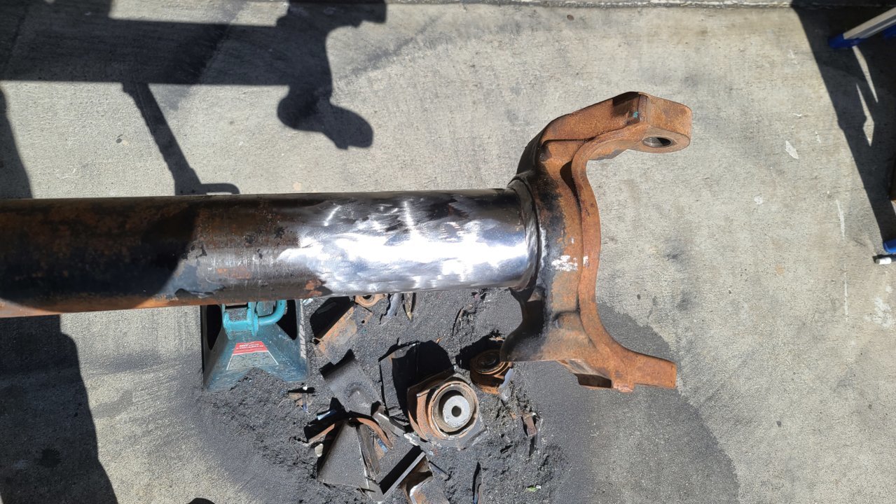

    Got one side all cleaned up! I found cutting as much off as you can with a cutoff wheel is the way to go. Once I got the majority cut off I used a grinding wheel to get as close to the tube as possible. I finished it off with a flappy wheel and I'll come in with a DA sander for the final touches. Overall this 1 side probably took 5-6 hours of just cutting and grinding!
    One side to go, with me luck!

    You going to truss it?

    Yes sir. On these axles you gotta cut 2" off the casting so it's a good idea to run a to ensure you don't snap it in half.
    I doubt my light weight Tacoma would break it but better safe then sorry.

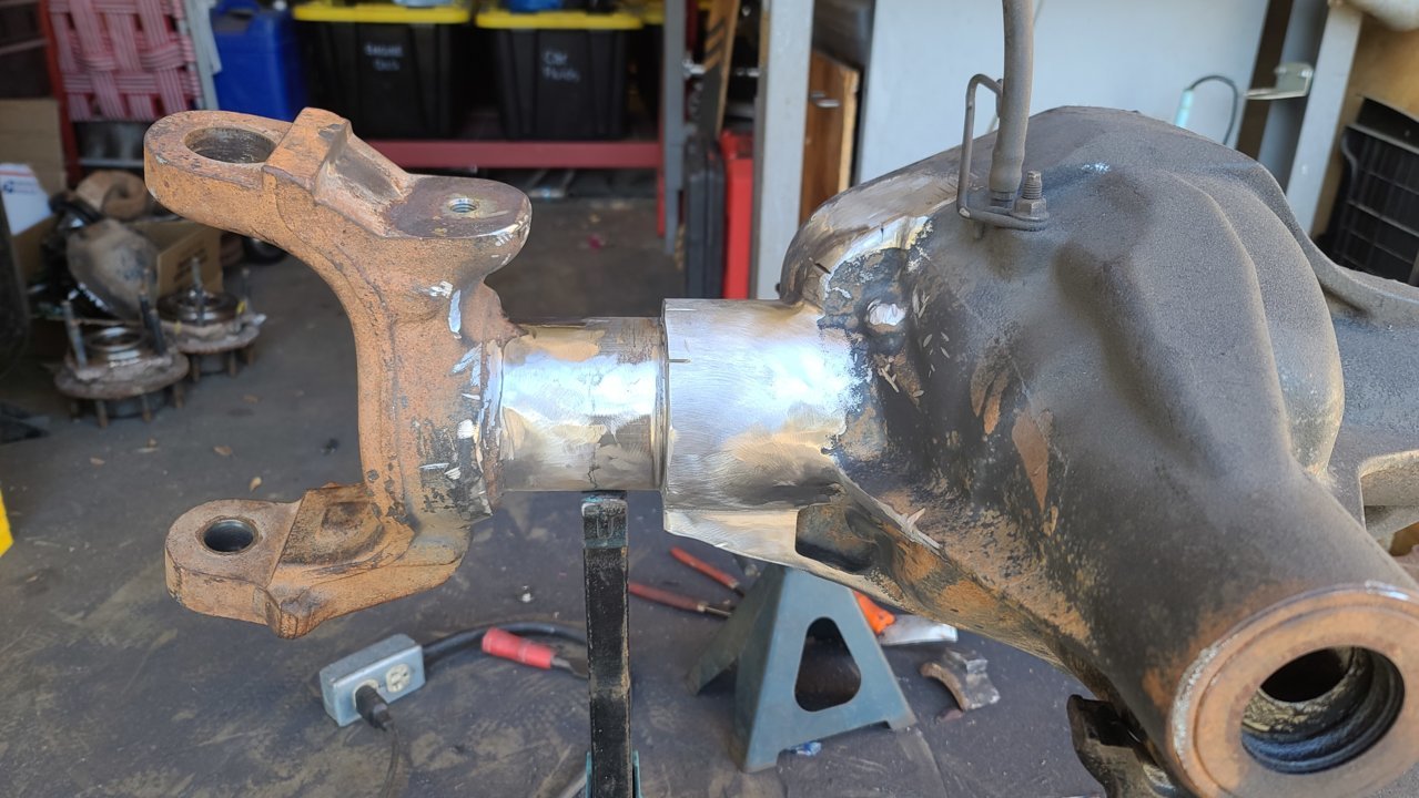

    Little update. 1st off my clutch pedal needed to move over a few inched because of the tub. The tub makes it so my pedal is about 1" from bottoming out. The clutch fully disengages but I can't start it without the clutch cancel button. I figured I'd just take it out, bend it, and be done. What I found was interesting. The spring had just about cut through the metal! Now I know the plastic bushing in these trucks is a weak link and disintegrates but I didn't think the spring would eat through the whole thing!
    I ended up welding it and drilling a new slot. I figured this should give me another 250k miles right? The spring is about 1/4 worn through so I'll just need to keep an eye on it. I slapped some grease on everything and the clutch has never felt better! Oh and bending put it in the perfect place! I can now start the truck without the clutch cancel button.

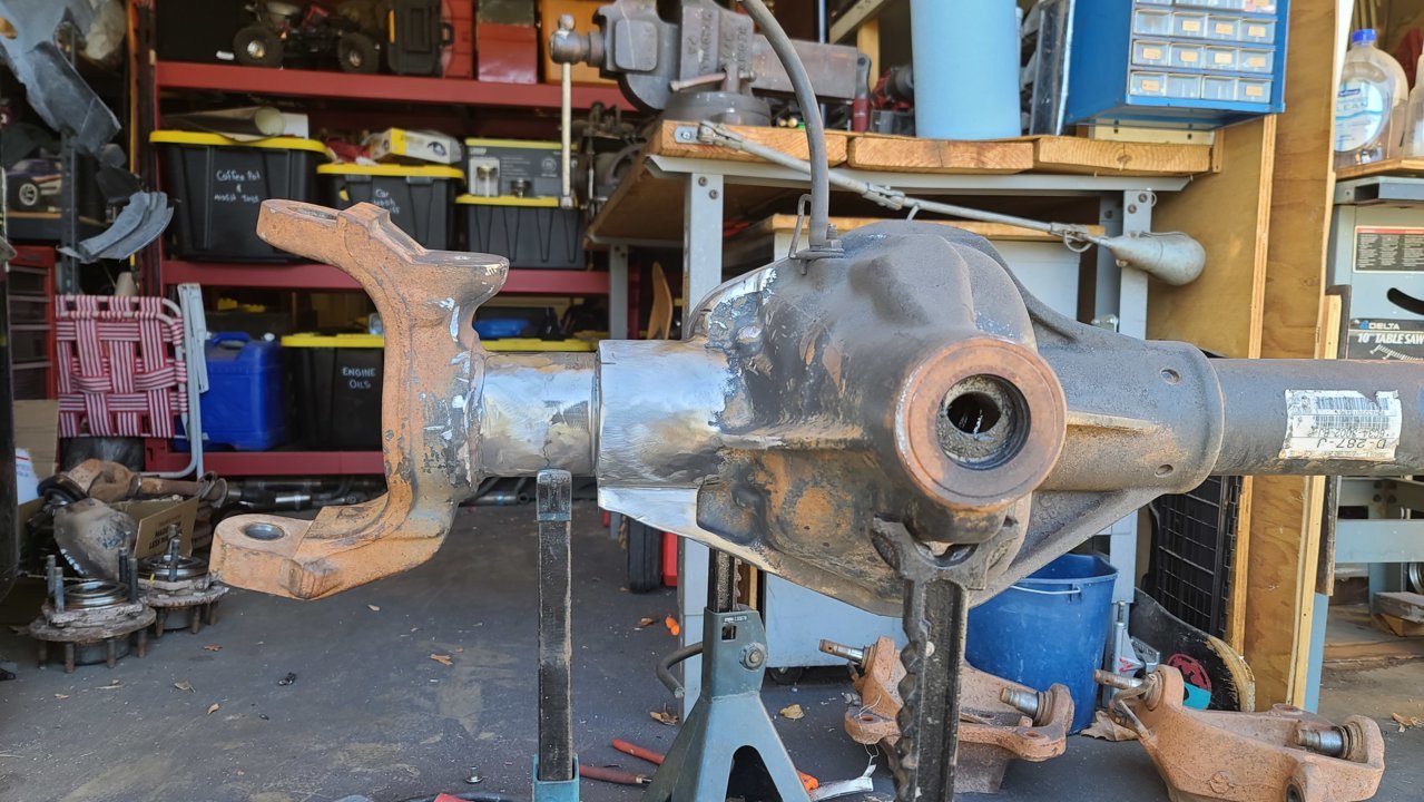

    And now the axle, it is finally 100% cleaned up and ready for welding!!!!
    I started with cutting the 2" off the housing. This was awful and stressful and I still managed to nick it! I'll have to weld up some of the scratches but I'm not worried about strength. The tube is VERY thick. I'm also gonna run a bead around the casting and the tube for strength purposes and it's getting a truss so it should be just fine.
    I am very happy with how it cleaned up. Looks like the Ford trailing arm mounts were never there!
    Next step is sand blasting and welding!

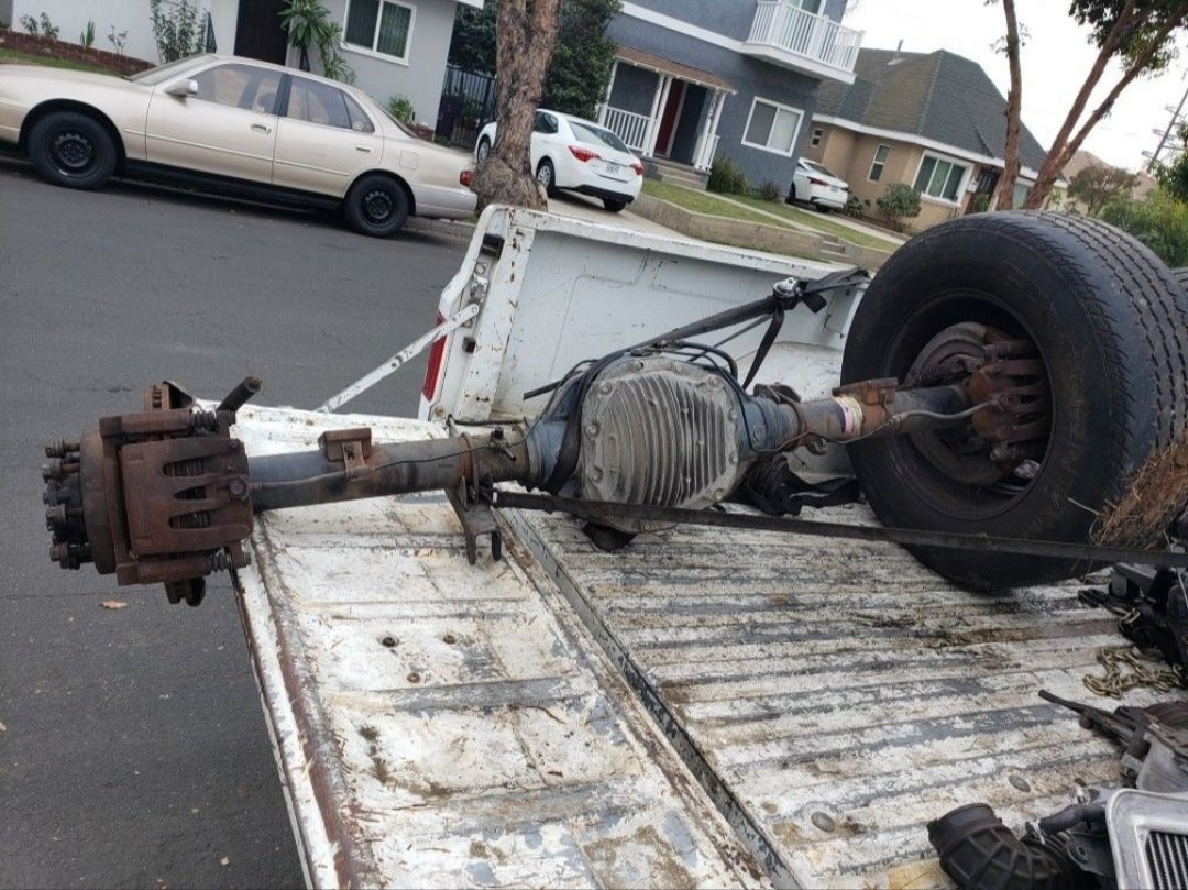

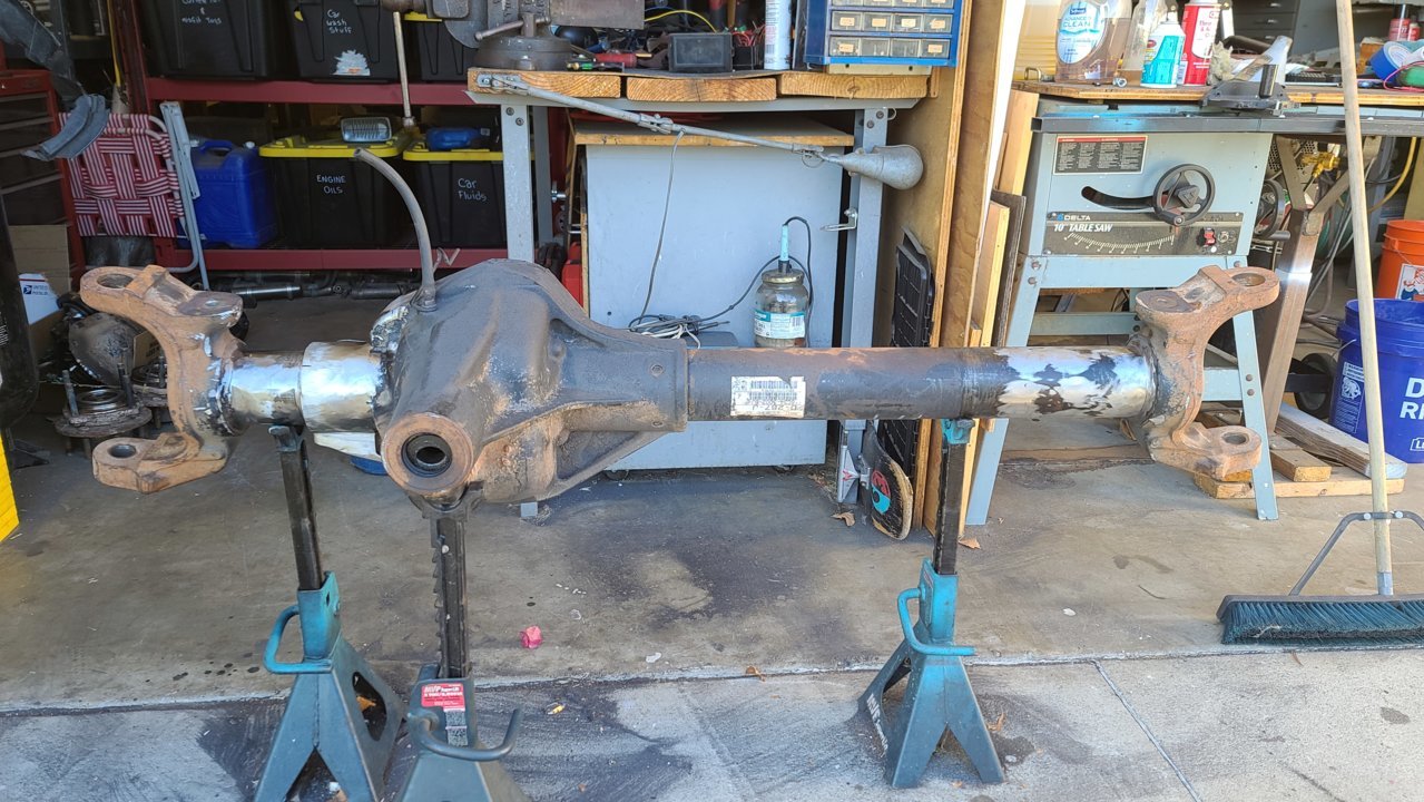

    Just picked up this guy:
    It's a Sterling 10.5 from an 09 F250 Superduty! It's the perfect match for my Superduty dana 60 front end. I was originally looking for a 14 bolt but, as you may know, the Ford dana 60 has an 8x170mm bolt pattern and the 14 bolt has an 8x6.5" bolt pattern. Obviously the Sterling 10.5 matches the D60 with an 8x170mm bolt pattern. Now here is the best part, I got it for the small price of $250! Around here that's a steal!!!
