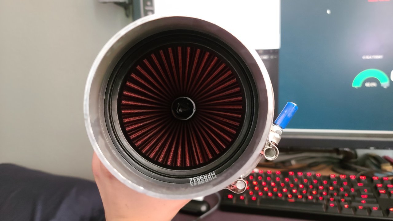

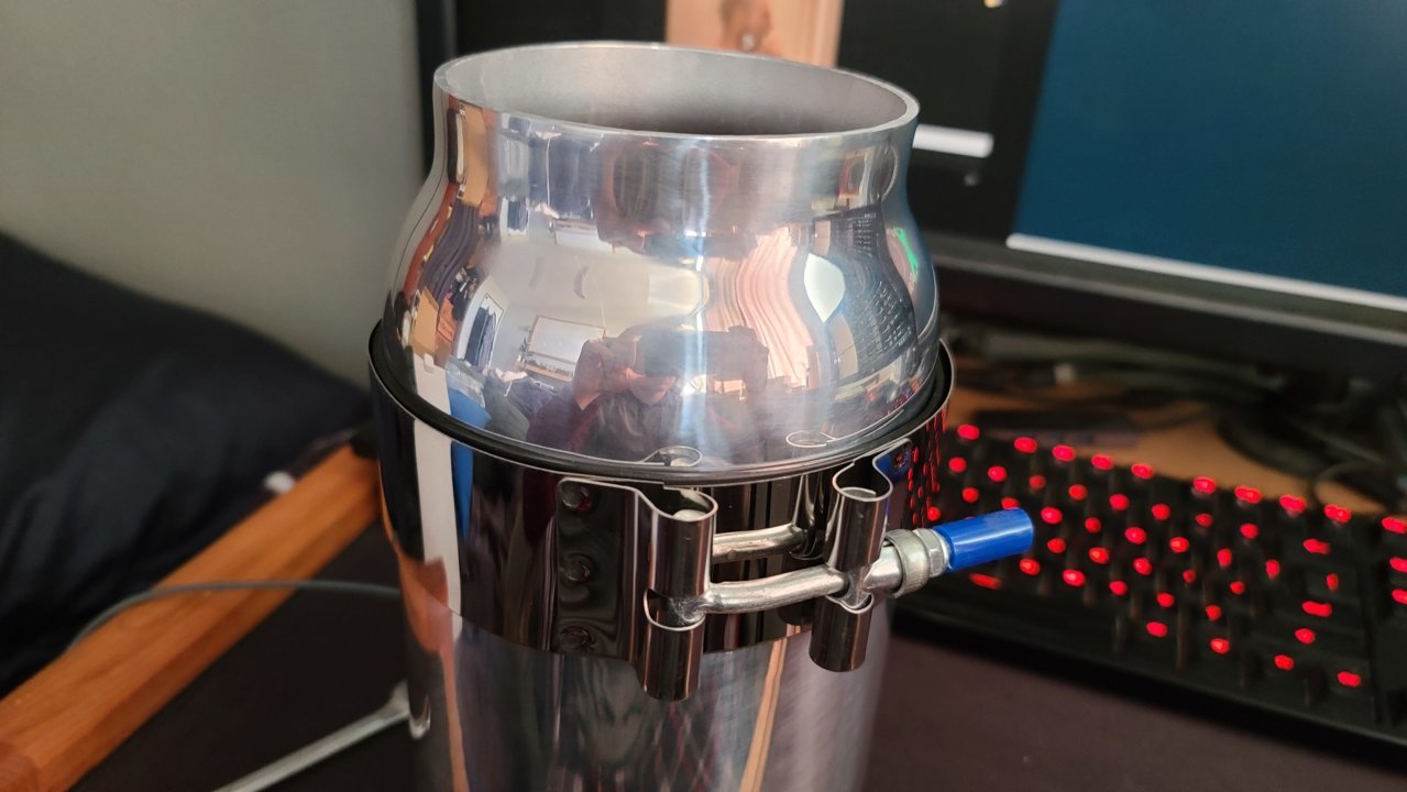

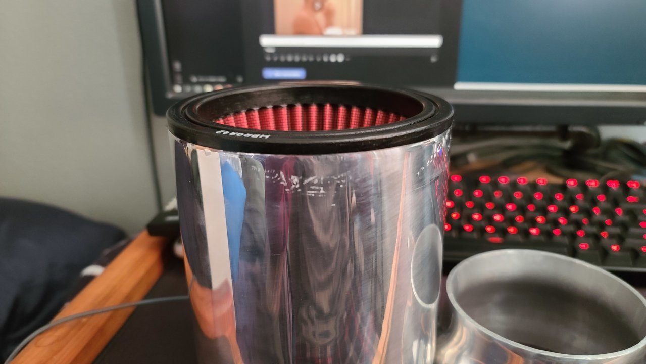

    I haven't really seen any good pictures or reviews of those Spectre inline air filters they sell on Amazon so I thought I'd make a little post about it. I bought the
    Spectre Performance 9832 Inline Air Box with 4" Inlet Filter. It just showed up a couple days ago so I took some pictures of it:
    First thoughts, it's larger then I thought for some reason. It's about 10" x 6" and the inlet and outlets are 4"! I'll need some adapters to get this to work in my truck.

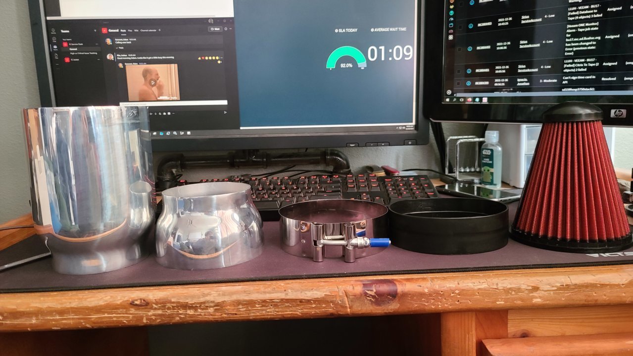

    Then I just had to take it apart and see what made it work:
    In order from left to right: Canister, top piece, clamp band, rubber seal, air filter.

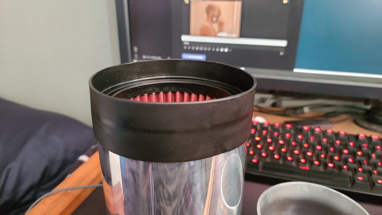

    I was not expecting the rubber seal in it! I though the metal band just clamped it all together, metal on metal. This should make it pretty dang water resistant. The air filter is a little smaller then I thought, especially when compared to my CAI one, but I think if you were to unroll it, it wouldn't be any smaller then the OEM flat filter, so it should work without any choking issues (hopefully).
    It goes together pretty interesting as well:
    The filer is the 1st to go in, it has a lip so it rests on the rim of the canister.
    Then the rubber seal slips over it. The seal has a lip so it sits right where it needs to.

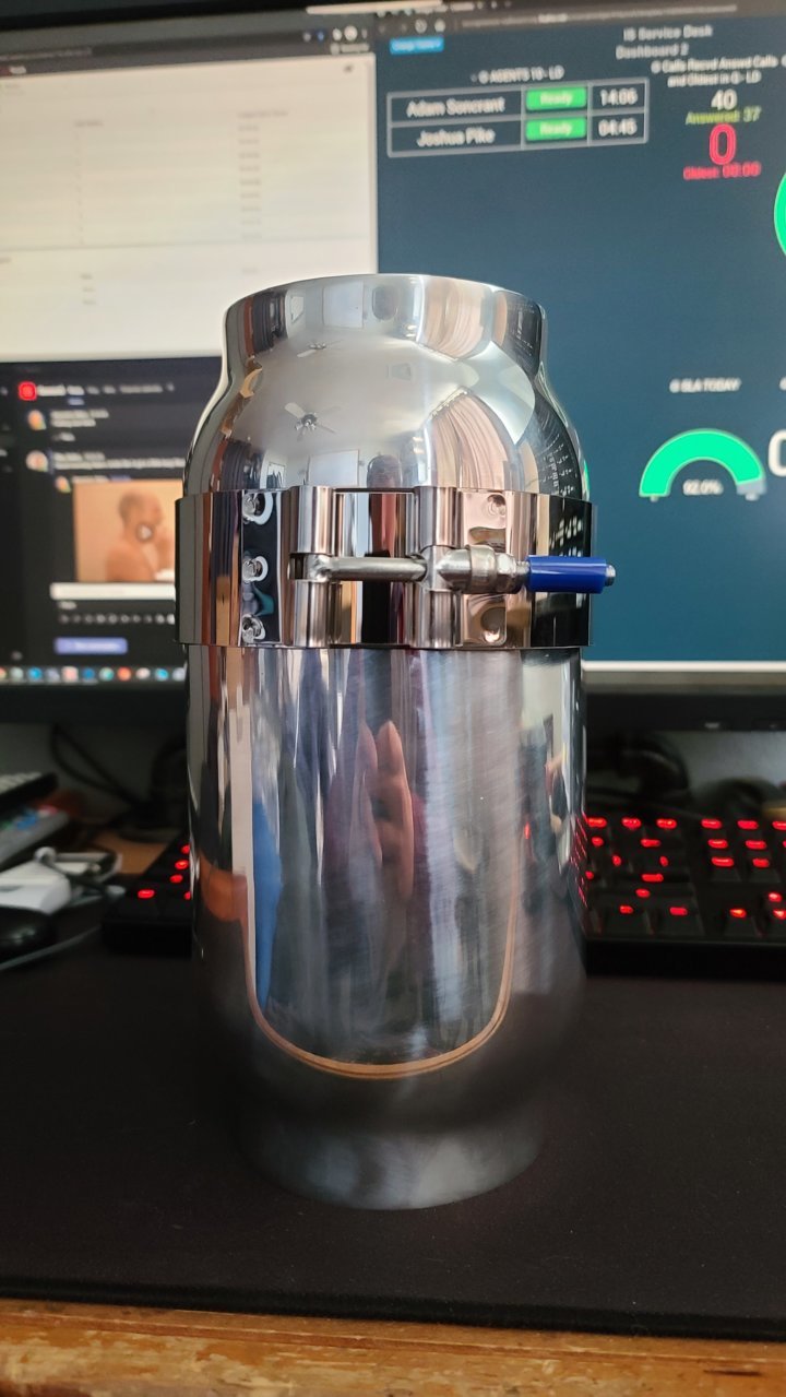

    Followed by the band clamp

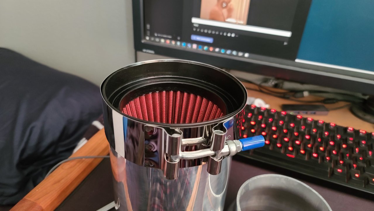

    And then the top piece. Finally just clamp er down.
    The filter sits in there pretty nicely with a little room around it:
    So far I'm happy with it. I'll work on a system for mounting this in my truck and keep you guys updated!
