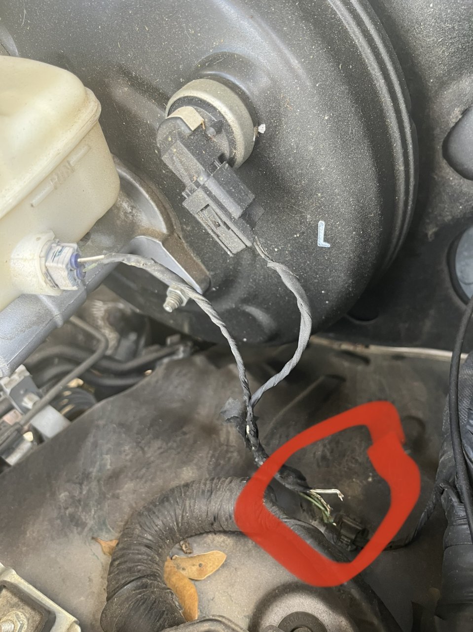

    Today I noticed a frayed wire coming from the wire harness coming from the break fluid reservoir. No lights on/issues with the breaks curious as to what this wire is and best way of replacing/repairing?

    First, disconnect battery negative.
    Disconnect harness.
    Repair harness correctly.
    Connect harness.
    Connect battery negative.
    Done!

    Looks like rodent damage.

    Is that a piece of rodent feces next to the leaf ?

    no, went back just to verify haha, dead fly that was crunched up

    You definitely have had a varmint chewing on your wires. Stuff a cat under the hood!

    Look for other wire damage....and get a cat.

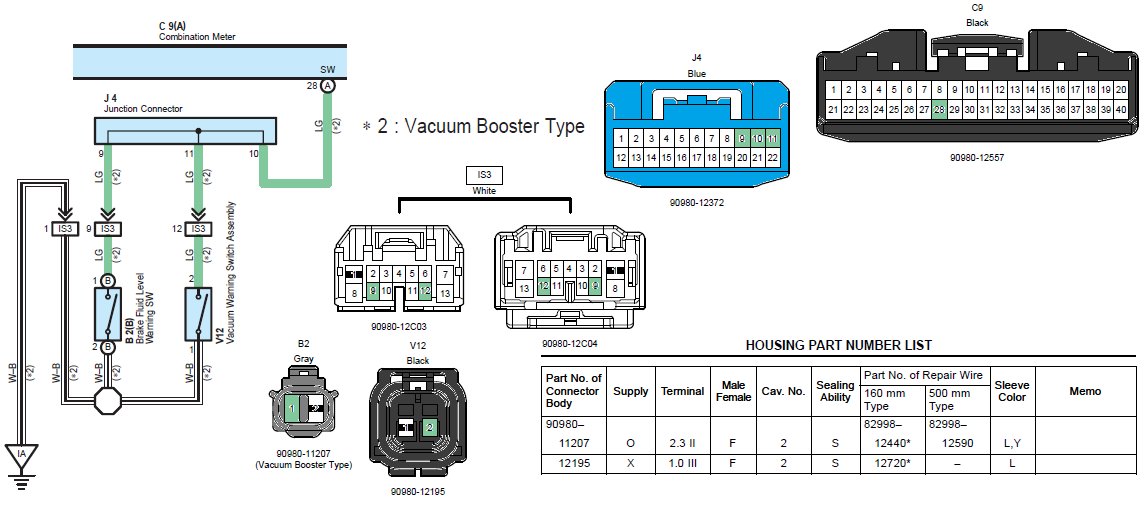

    Low fluid sensor wire? Probably disabled the circuit hence no warning light.

    What ever it was it yanked on it pretty good to pull the wires out of the connector.
