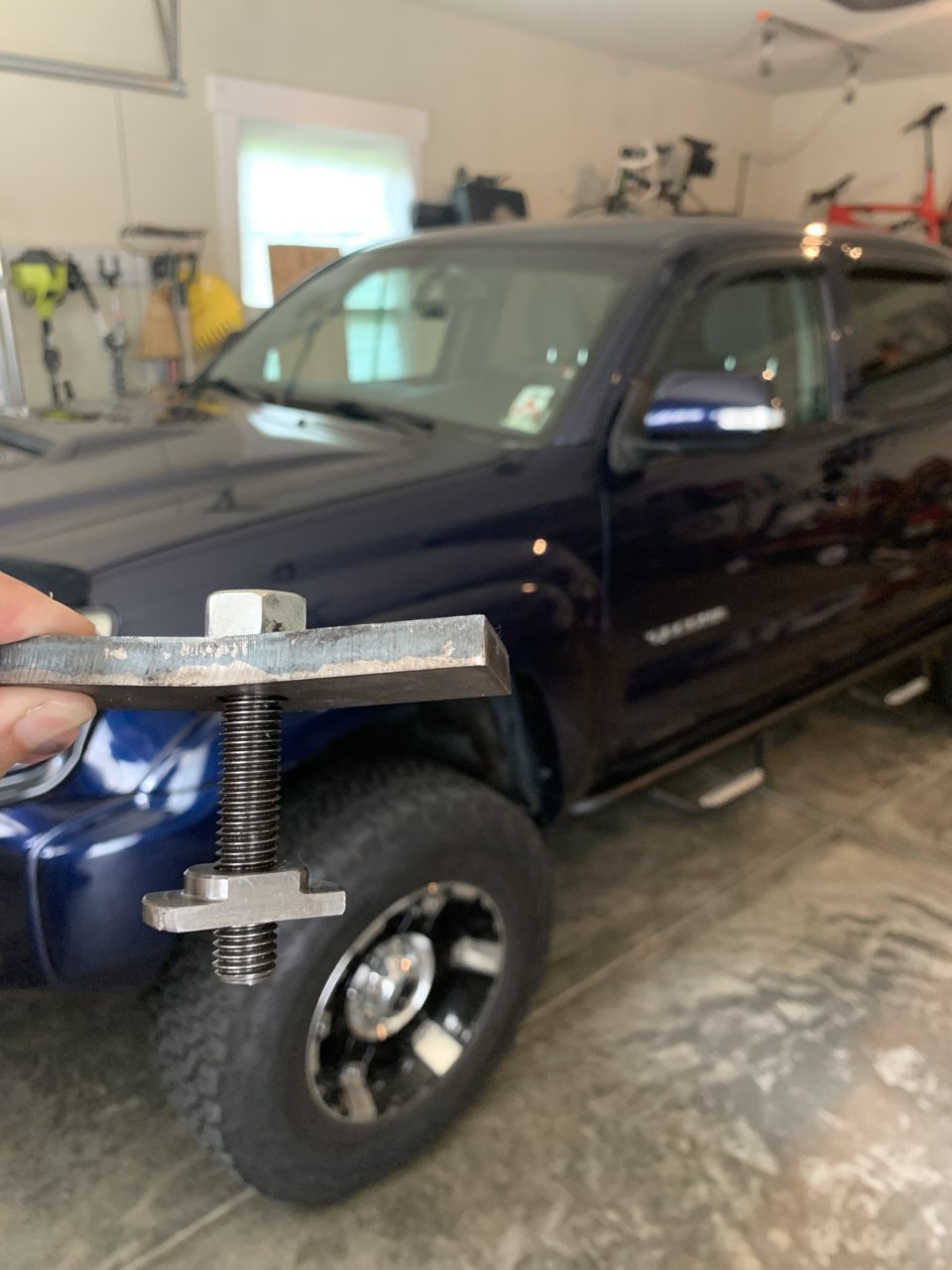

    Giving back to the tacoma world community.
    Here's how this will work- Giving the tool away, all you need to do is pay me shipping.
    Here's the catch: When you are done, please repost the tool to this thread with the same deal and a pic of your truck after the job's complete.
    I'm looking forward to seeing where all this thing travels.
    To get started:

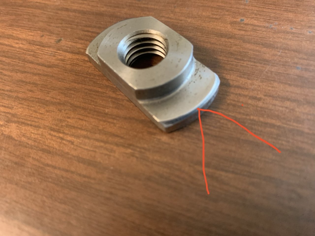

    7,489
    I’ll be at my office in about 30 minutes. I’ll measure it.
    six5crèéd[QUOTED] likes this.
  14. Sep 2, 2020 at 10:55 AM
    Muddinfun
    Muddinfun Well-Known Member
    Apr 17, 2017
    #216500
    7,489
    The threaded rod is 6" long. Also, the back side of the puller plate needs to be beveled just slightly. I posted those pics before I actually used it. When I used it, I had to grind the edge just slightly to get it to slip in behind the bearing.
  15. Sep 2, 2020 at 10:59 AM
    six5crèéd
    six5crèéd Be the light
    Jul 9, 2019
    #298734
    36,093
    Southern Virginia
    8 lugs no plugs
    Can you share a picture of exactly where you're talking about the bevel needs to be?
