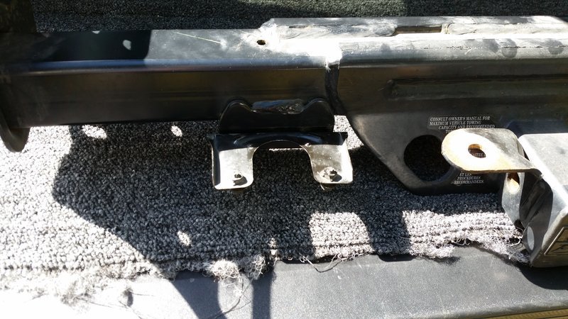

    Finally removed my receiver hitch, was looking at the bracket that holds the trailer wiring plug, and realizing it can be modded very easily.
    In the following pics you will see how I was able to bend the mounting bracket to allow the trailer plug to be repositioned out of the way of off road obstacles.
    With a simple 90 degree bend, and rotation of the bracket, you will no longer be exposing the electric plug to damage.
    1st pic is the bracket

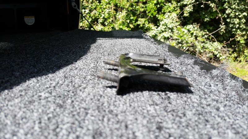

    2nd pic shows how it hangs down from the rec. hitch

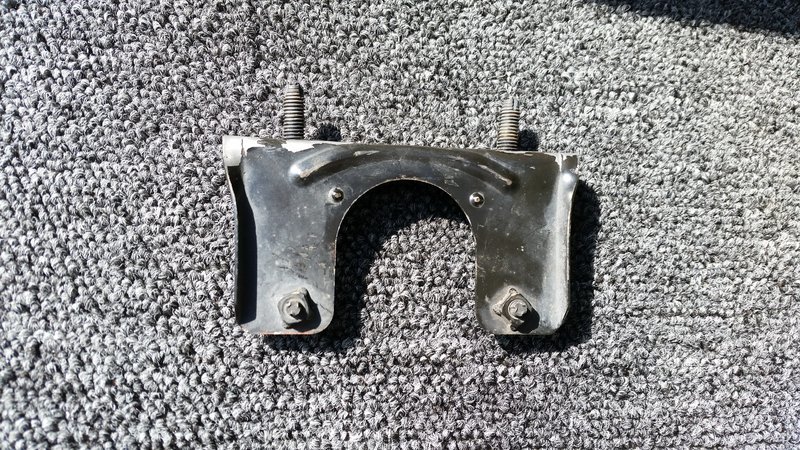

    3rd pic shows the mount after being bent in a vise, and re installed

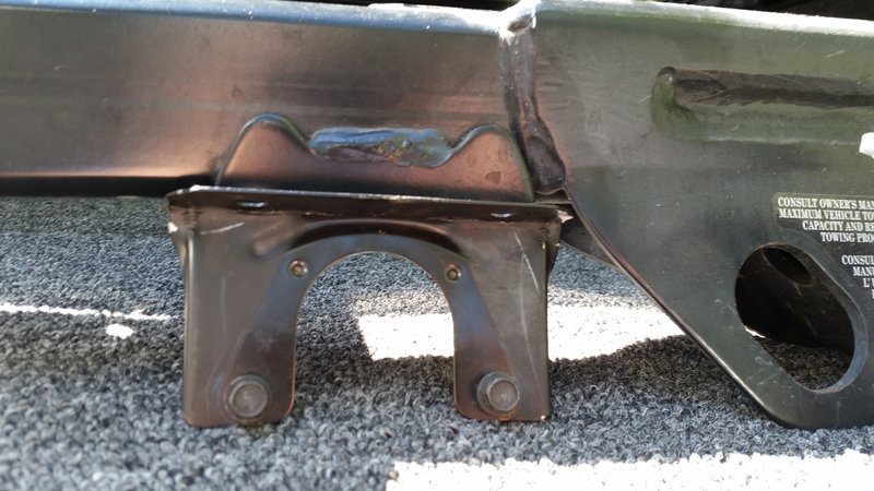

    4th pic shows the bracket from the side

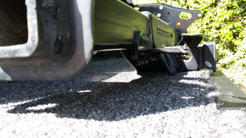

    5th pic shows the bracket after bending, yeah it'll need some rattle can!

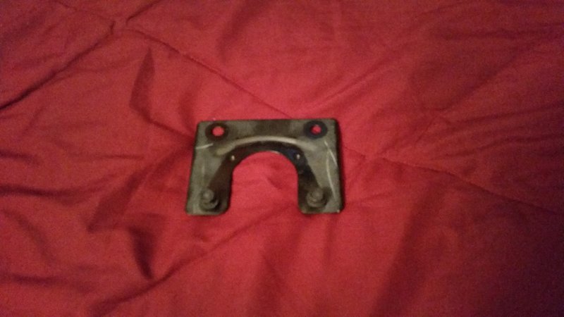

    6th pic shows the bracket from the side!
    Very easy mod to perform, and could save you destroying your trailer electric plug!

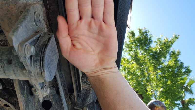

    20160404_121406.jpg it will face down where my hand is as opposed to facing to the rear once modded

    Negative sir. Been workin. Ill get it done saturday or sunday. How many inchs down is the bend.?

    I didn't measure it, but if you eyeball it from the pic V I think you'll be ok!

    True right at the cusp of that arc. Use a hammer to bend it or pliers of some sort?

    I borrowed a hammer and a vise...
