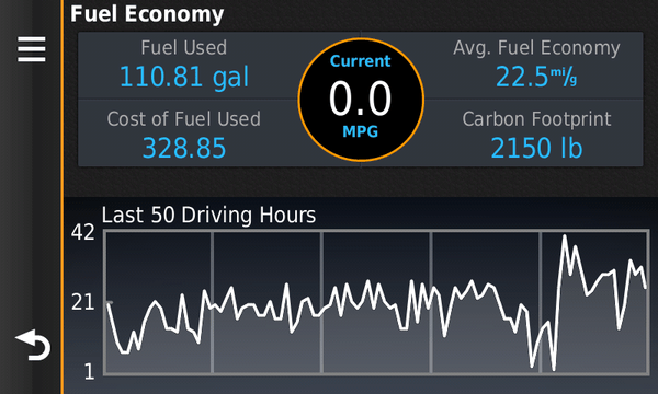

    Here are some screen shots from the Garmin.
    This one tracks the last 50 driving hours and the Average includes time before removing the intake hose. You can clearly see the difference of before and after in the graph:

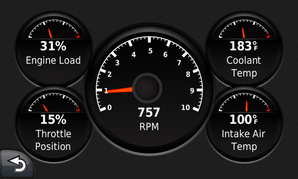

    This is the gauge page I was monitoring today. This was at the end of the trip sitting still with the truck running for a few minutes when I stopped to get the mail.

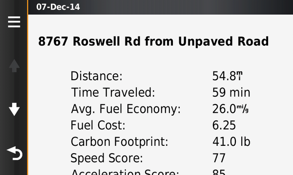

    This is the first driving segment report when I left this morning to my first destination:
    This is going to be an interesting experiment.
