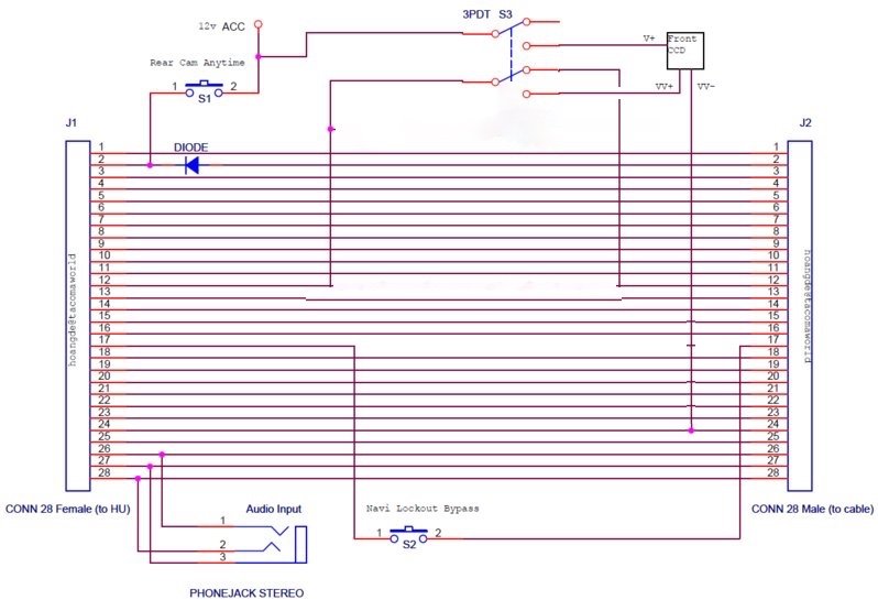

    It is my x version schematic.
    1./ Rear Camera anytime
    2./ Front Camera
    3./ Nav. bypass
    4./ Aux Input
    I don't want using Pic, Relay and possible remove diode for switch. Feel free to input/recommend

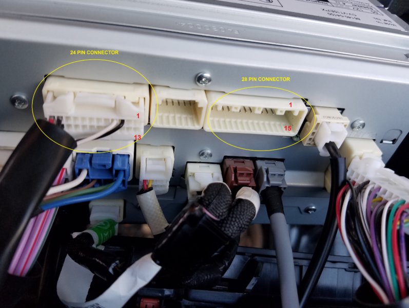

    Update to this diagram for anyone else following it.
    Pin 13 in the diagram showing video+ should be Pin 12. (so put a switch/relay on pin 12 not 13 as shown)
    Pin 14 in the diagram showing video- should be Pin 24. (so join video- to pin 24).
    You can also use a DPDT relay, no need for 3PDT relay as shown.
    Here is a bad update to the diagram.
    Attached is a PDF (extracted from the Toyota manual) with all the pinout information for that connector.
