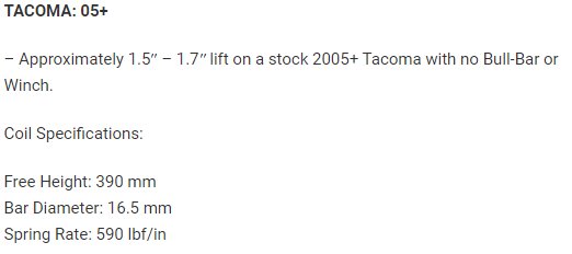

    Awesome thanks man, makes sense with the drop offs. I found the 884 coils that were mentioned earlier, that isn't super expensive and seems like the best option for ride quality. Says they are 2.5" springs, safe to assume they would settle at about ~1.75? No plate bumper, or winch. Stock front end.

    Per Wheelers Offroad:
    OME 884 springs:

    the 884's gave me right at 2" in the front, thats 4x4 6 cyl, no aftermarket bumper/winch, etc... I did 1.5" aal, and i went from 3/4" rake (back end high) to 1/2" rake (back end high). No problem on alignment (other than seized up bolts) and no vibrations, shudders, etc...
    I would guess with 884 and 2" springs in the back you would be close to level. I did to the lean spacer on driver side, and driver and passenger side are dead level with each other.
