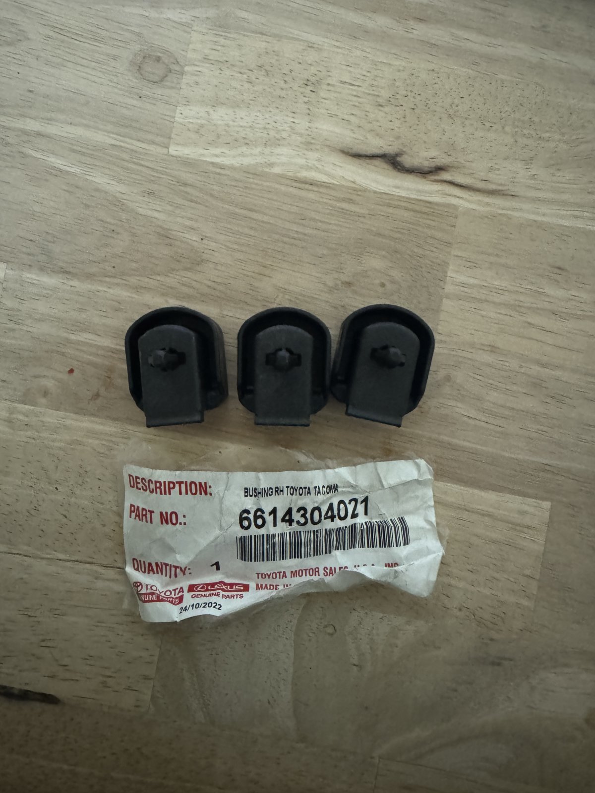

    I have (3) tailgate bushings available for free. I seemed to go through them on a regular basis when I owned my 21 Tacoma. First come first serve of course.

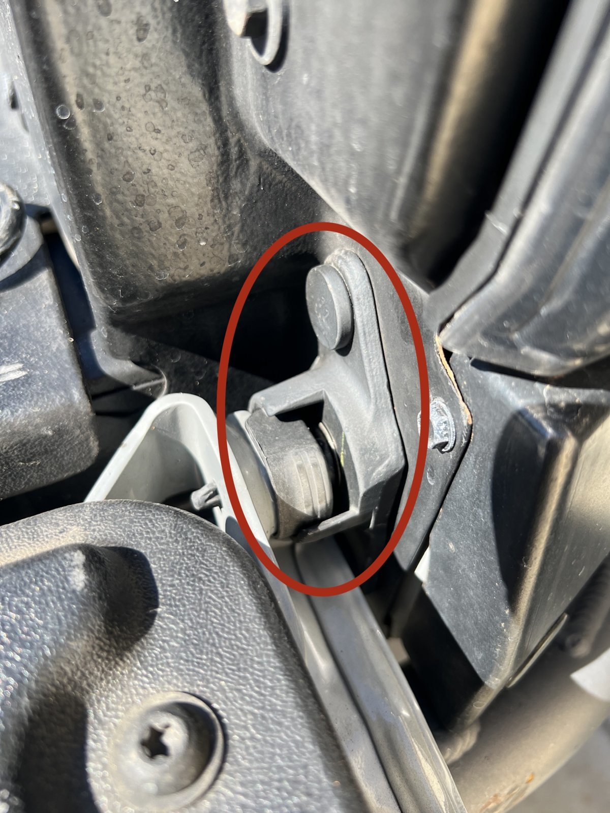

    I know yours are all gone, is this what I need for the drivers side tail to stop rattling. Something has worn down in my tailgate has dropped enough to rub the bed liner.

    Not sure this is what you need. This is a plastic bushing used in the soft open tailgates. It goes on the passenger side.

    Thanks. I have the slow open tailgate but the bushing on my drivers side is what’s been worn. Thank you for the response tho.

    Unfortunately that’s the expensive side to have to fix. That’s the whole mechanism if my memory serves me correctly. The plastic bushing is about $4/$5 where as the other side is much more expensive

    Just double checked, on my 2020 trdof my soft opener is on the passenger side and those bushings are the for the soft opening side. The red circle in the pic is the soft opening mechanism and the bushing. This can be verified by noticing that the shaft on the soft closing side moves with the tailgate while the shaft on the opposite side is fixed and doesn’t move. Once I find a part number for the drivers side I’ll post it here incase someone else has my issue
