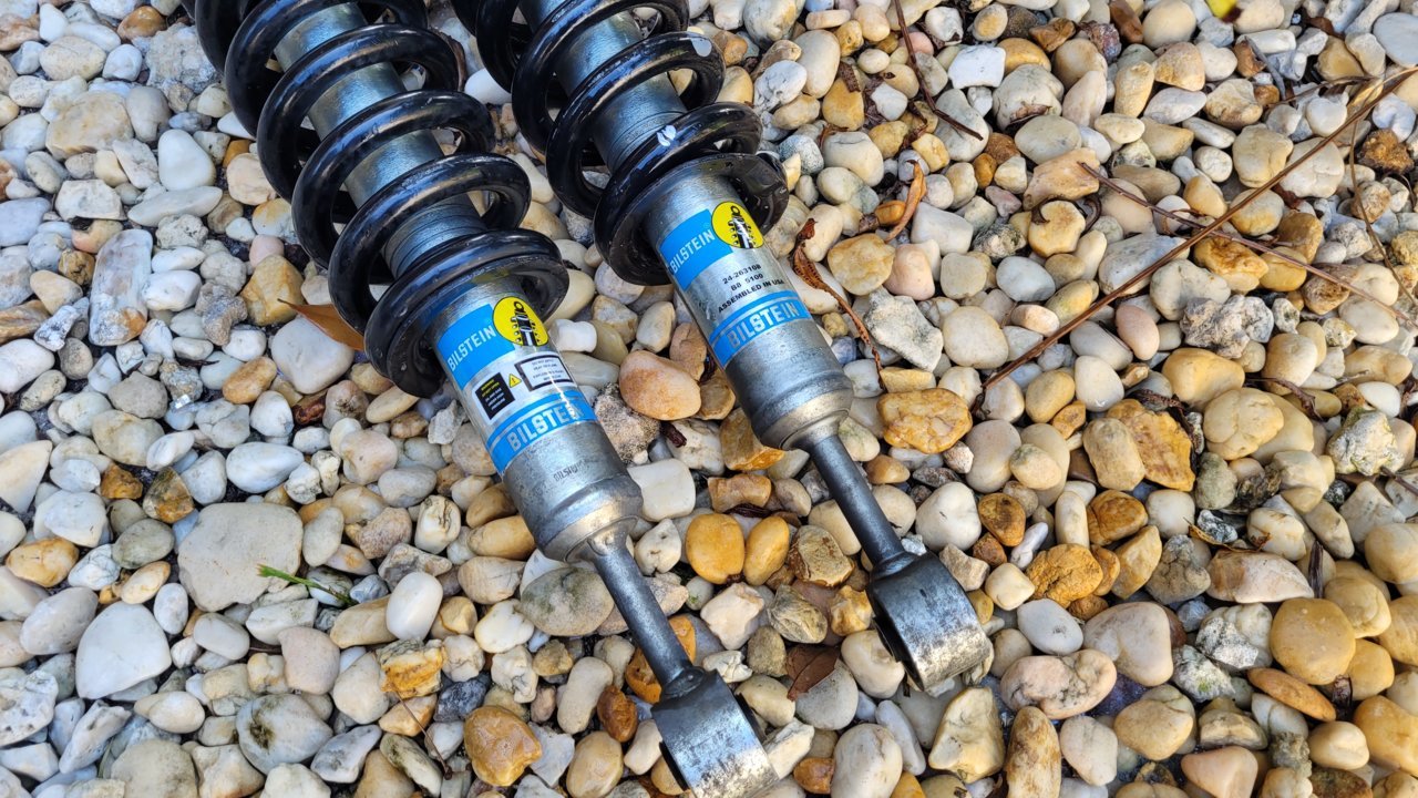

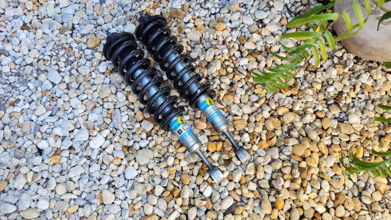

    I installed these 5100's on my truck about 10k miles ago.
    They coils are defective, I have finally confirmed the springs were the cause of the metal on metal banging sound when traveling over speed humps.
    This the noise the OEM coils were making since day one.
    https://youtu.be/wBIB4Evx4uM
    Struts good, springs bad.
    Anyone in the Ft. Lauderdale area that needs / wants the struts they are free to pickup.

    Not sure about you aftermarket springs making a metal-on-metal noise.
    The metal-on-metal noise in my truck was LOUD, loud enough that my neighbors knew I was on the street due to the noise.
    After countless hours under my truck and finally using a professional listen device I was able to confirm the OEM springs were defective.
    Just think, I replaced the perfectly good OEM struts with the 5100's and still had the noise. Looking back, I should have replaced the entire assembly, would have saved myself a lot of time, money and effort.
