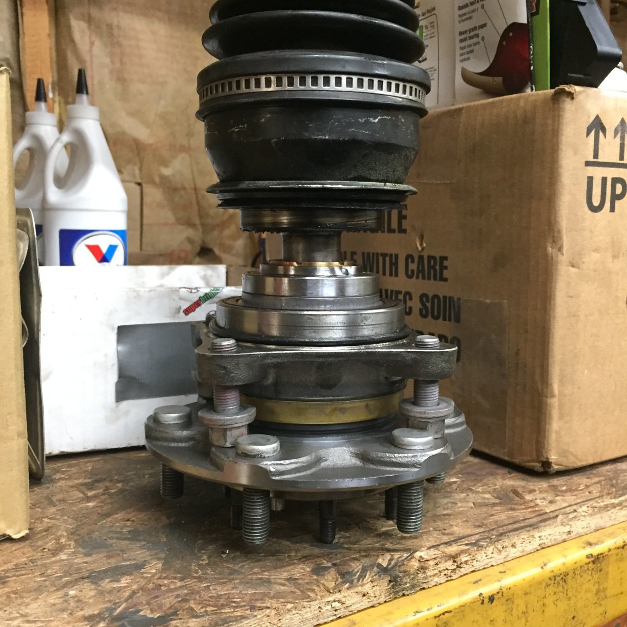

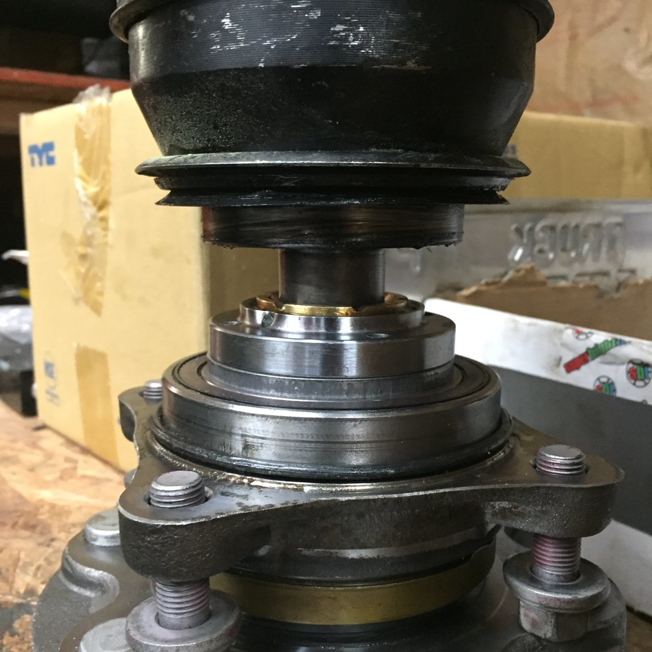

  14. Apr 1, 2020 at 4:10 PM
    #294
    mxtwo50r
    mxtwo50r Well-Known Member
    May 19, 2017
    #219413
    69
    06 Reg cab 4x4
    F18BE733-DD6D-4216-9B88-98E2FE8BA962.jpg A26154BC-F09B-4EE3-B018-660C5D65FEF7.jpg
    On the bench, this is as far as the shaft will go into the hub, all of my 235lb meat slab hanging on the cv will not make it go through. I can spin the hub and it will forcefully “screw” its way through. Do not think “he just needed to wiggle it a bit, what a moron” because the fit is too tight for anything like that. Spinning it requires maximum hand pressure, one on the cv shaft between the cv’s and one on the wheel studs to spin the hub. It is not easy at all, when the brass collar reaches the cv face, it’s all locked up. I.E the only reason its spinning is the screwing action, when it runs out of real estate it stops spinning at all.
    I understand it’s a tight fit, however, my passenger side cv, when removed and on the bench, will drop in the hole with 0 issue, no pressure needed, bearing clearances are tight, but theres a tolerance. This has none. I can’t tell if the bearing bore is off center or the shaft is too large buy just a slight bit.
    I can assemble it with the hub dial taken off and take a pic, but it will just look like a hub on a truck with the lockout dial missing. If you still request I do that, I will do it for you no problem.
    With it all assembled and a 265/70 tire mounted on it, it will free spin (think price is right wheel, spin hard as you can) maybe 1.5-2 revolutions and stop, compared to the passenger side doing, I dont know, 20 revolutions or more.
    What am i missing?

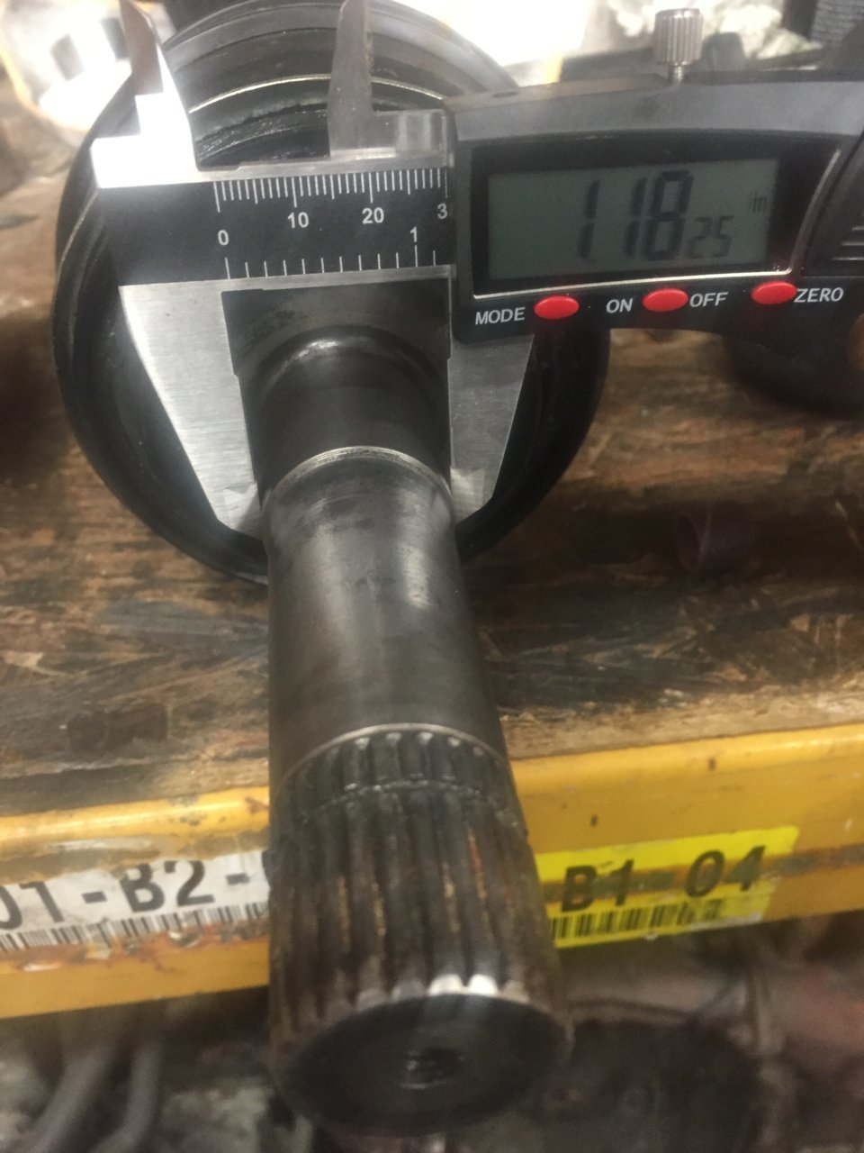

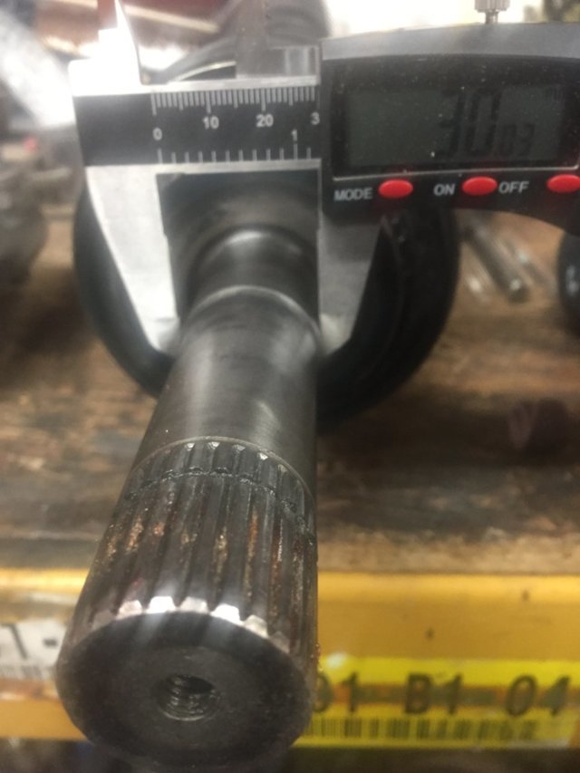

  18. Apr 2, 2020 at 9:27 AM
    #298
    mxtwo50r
    May 19, 2017
    #219413
    69
    06 Reg cab 4x4
  19. Apr 2, 2020 at 9:29 AM
    #299
    mxtwo50r
    May 19, 2017
    #219413
    69
    06 Reg cab 4x4
    Or mm if you prefer.
