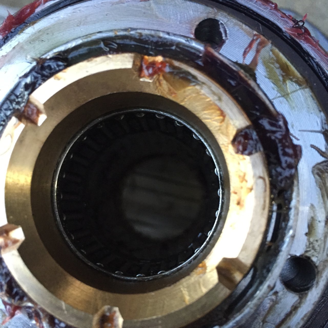

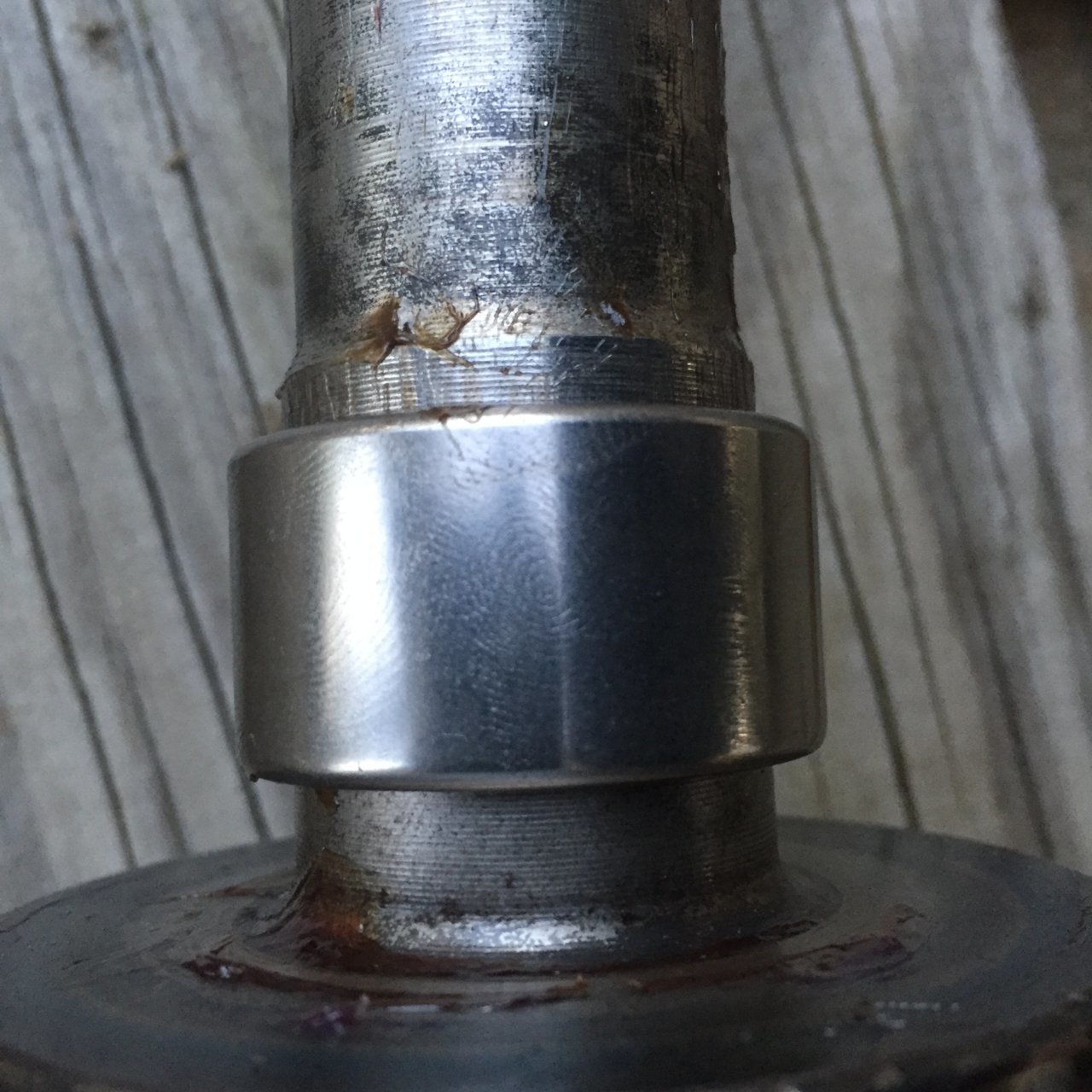

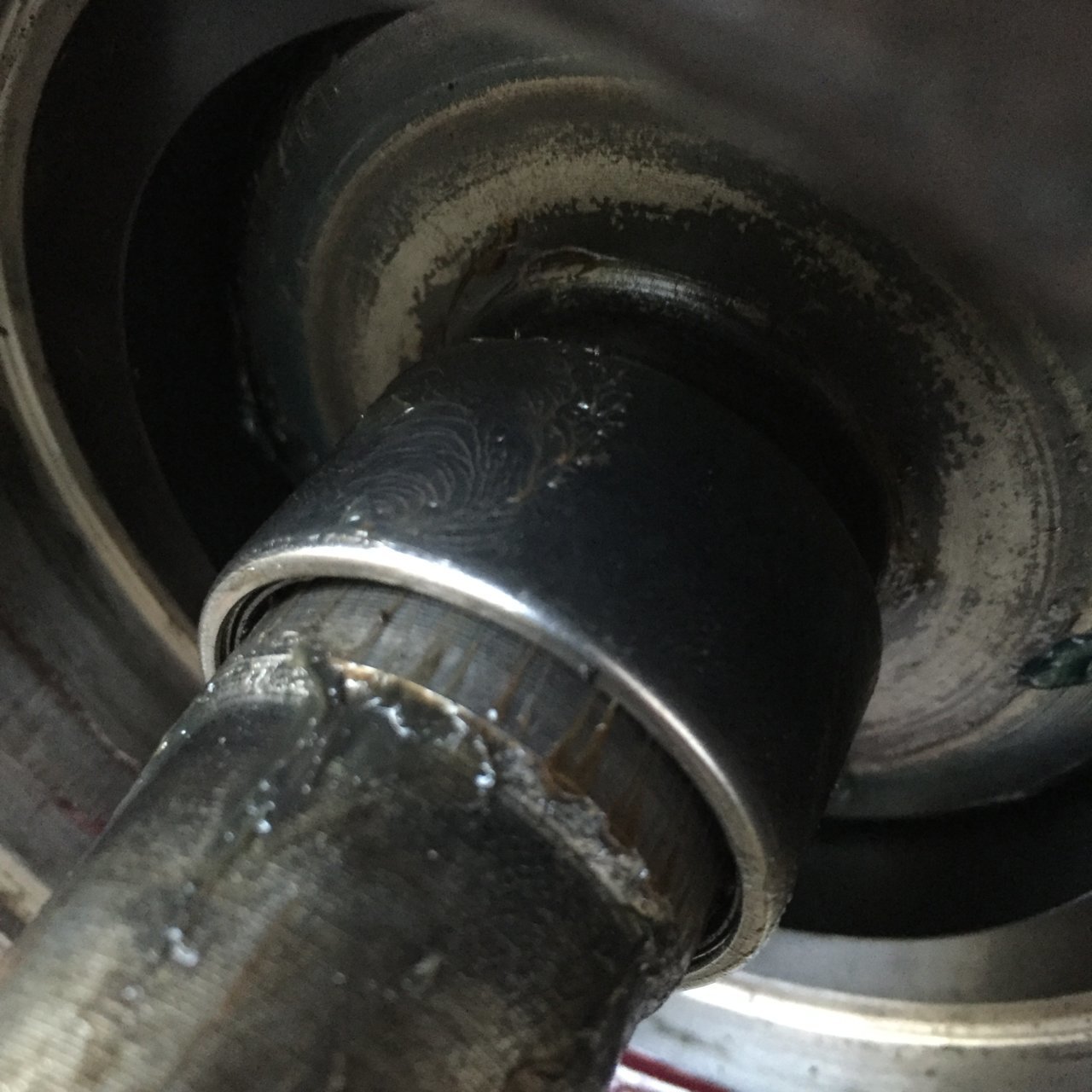

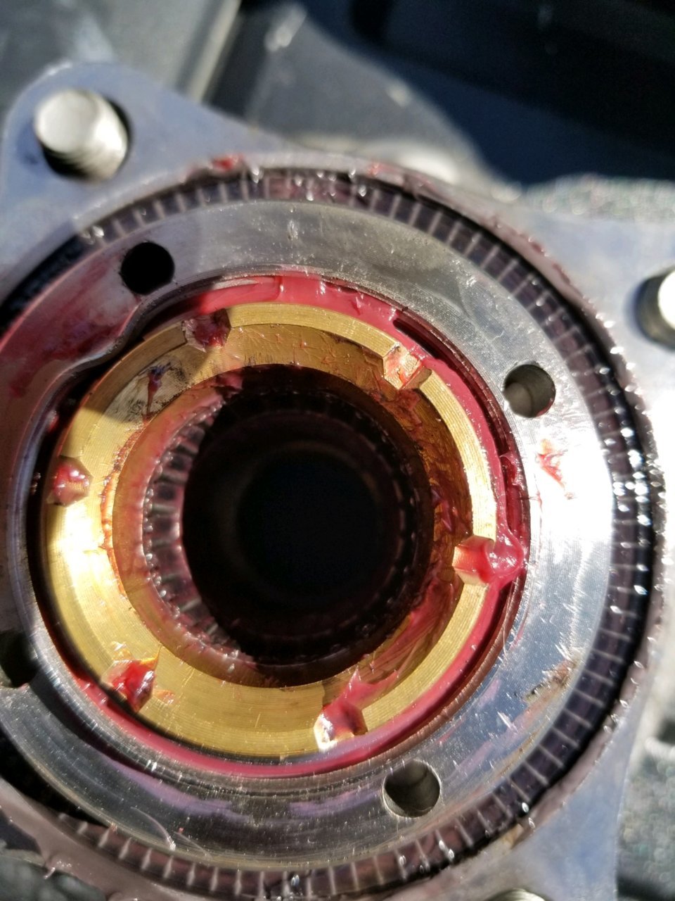

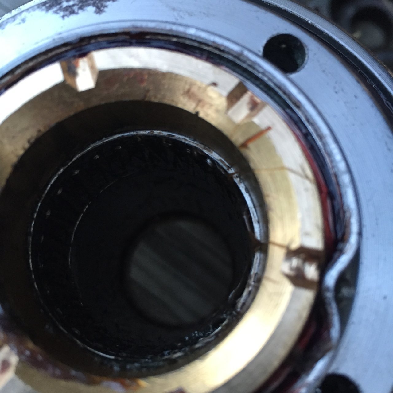

    Went to visit @cjsqueeky (the guy that made the install video) with my parts. He has a spare hub. My axle drops in his spare hub. My axle does not drop in my hub. My spare needle bearing will go on my cv shaft but it is tight, same p/n I used to replace the one in it, 1st gen tacoma. He can elaborate on his opinion. There was a large difference in the ID measurement between the assembled hubs. I feel like there is a stack up of tolerances causing the issue.
    Also pulled my passenger side apart to compare.
    So lets recap:
    My driver cv axle will not fit in my hub assembly for that side.
    Same axle will fit in my passenger side hub assembly, and in another members hub assembly.
    My driver side hub assembly will not fit on my passenger side cv axle.
    My spare needle bearing will fit both of my cv shafts.
    One of my cvs measures 30.02-30.03mm (driver) One measures 29.98-29.99mm (passenger)
    My passenger hub assembly looks to be larger on the bearing bore than my driver side hub assembly, which was the same case at @cjsqueeky ’s house. My hub id was smaller than his.
    Pics:
    Hard to see in the pic but the bearing is hanging inside of that brass lip more on one than the other. Appears my hub is out of spec.
    The same needle bearing I used to replace the original is pictured on my axle shafts. It fits both axles.

    The needle bearing installed in the hub is the same p/n needle bearing as pictured going on both shafts, I ordered 2 when I replaced the original one. So the bearing itself is not the issue. Once installed in the hub, it is too tight. I will say when the spare loose bearing is slid on to the cv for the side I am having an issue with, it is on the tight side but rolls.
    I do not know if the hub bore is slightly too small, or if the shaft is slightly too large, or if you have an instance of the stacking up of tolerances (hub is at the min, shaft is at the max) and it doesn’t work together. Its almost as if the shaft OD is all the bearing can take before its installed into the hub, and once its installed in the hub, the interference fit of the hub bore shrinks the bearing to where the shaft ends up being too large. The hub ID of the problem hub is smaller than both my other hub and of @cjsqueeky ’s spare hub, you can visually see it. I will see if i can get him to chime in if you’d like.

    I can verify there is a problem but I cant tell if it with the Axle or hub needle bearing.. I am almost thinking the axle is just a little over sized and the hub is under sized.
    His pic shows the shoulder protruding past the brass bushing and mine it is flush with the brass bushing..
    My bet is the wheel hub was not machined properly causing the bearing to crush more than designed causing the shoulder to roll out.
    Notice in the pic my hub doesn't show the shoulder sticking out past the brass bushing.
