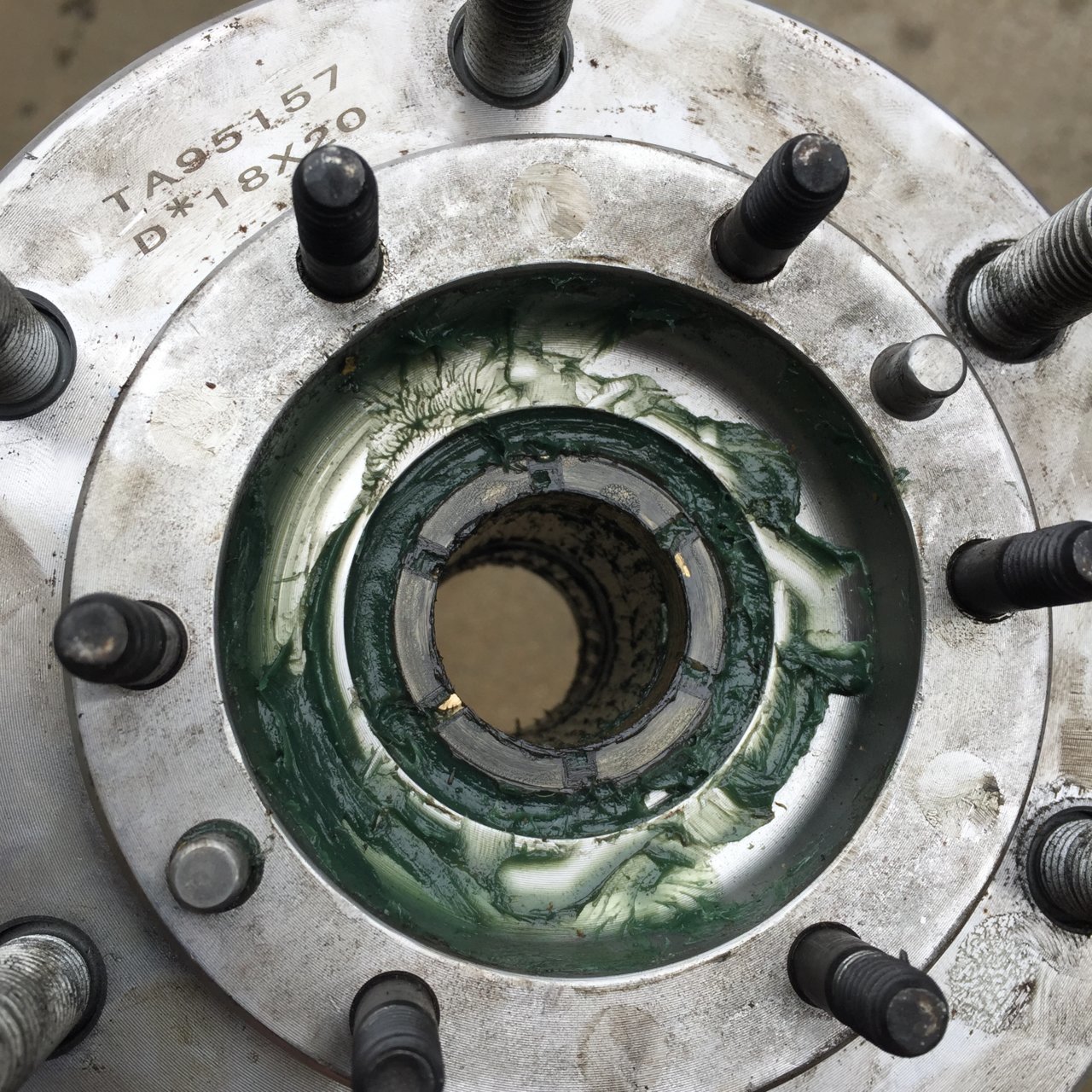

    @bobsuruncle I confirmed it is a non add hub. it was the one provided in the kit.
    Just clarify when I say hub needle bearing I am talking about the piece that I put in the picture. I am sure if we press out the needle bearing out of the fitting and non fitting "hubs" the ID will be smaller which is causing the bearing to compress more and rolling the edge out..
    @mxtwo50r and I carefully analyzed the non fitting hub and it is stopping half way into the needle bearings.
    Both of us have a lot of experience with the original trucks that used these parts. He has also worked in one of the more reputable 4x4 shops in the area and knows what he is doing.
    I think it is a pure machining defect of the hub needle bearing area.
    One more thing it is very hard to explain or understand until you have hands on the parts.

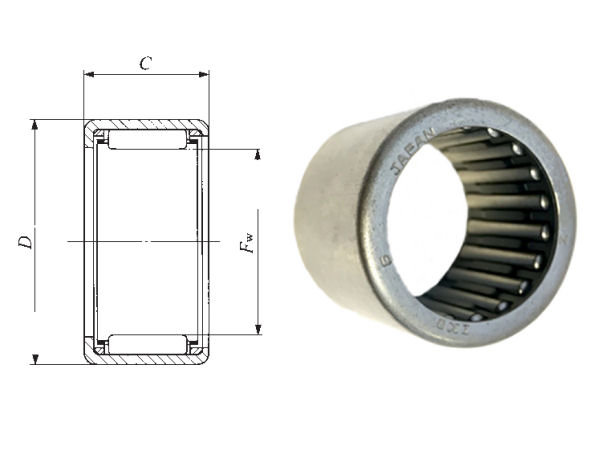

    Standard needle bearing Dimensions
    Fw: 30mm
    D: 37mm
    C: 20mm
    You keep asking questions that have been covered in previous posts.

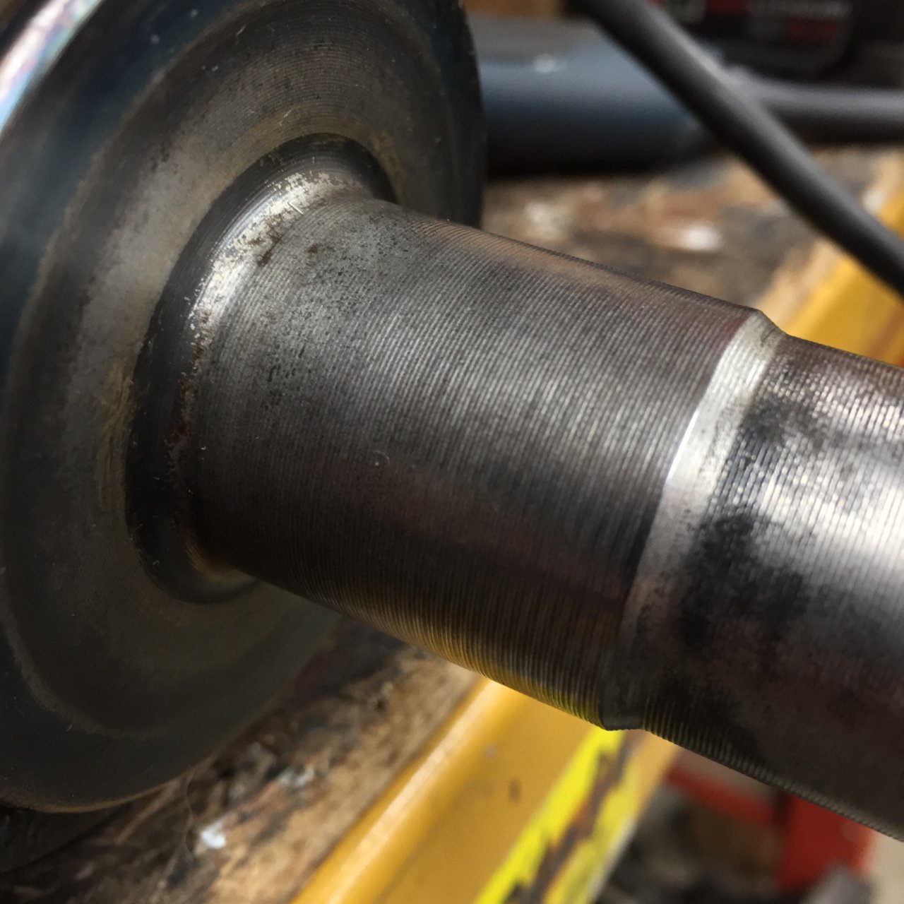

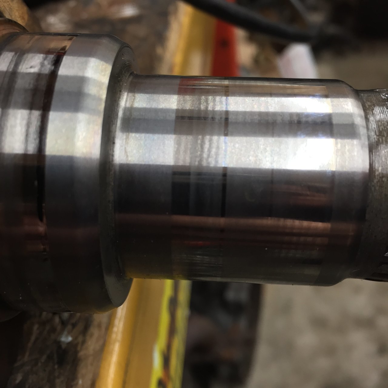

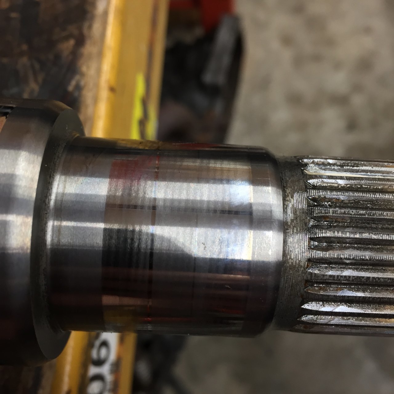

    Also, question, is your outer cv machined smooth where the needle bearing rides? The spot of the cv that would ride in the bearing has a rough finish on mine, your fingernail ran across the ridges of the surface make a noise. It has the same machined, phonographic finish the whole length of the shaft out to the splines, it never gets smoother for the bearing area. I tried to take a pic, but its hard on my phone to get it. Took a pic of the other end for comparison. Granted it has been in a bearing so it would be worn smooth, but even the spots not in way of the bearing have a MUCH smoother surface finish. It has the rough finish on the splines, but was machined smooth for the bearings, you can see the surface finish difference in the pics. The new cv, does not have this difference.
    Oem inner cv bearing surface, note: even where the bearing doesn’t ride is very smooth, which is what the original surface would have been for the bearing as well:
    @05Taco4x4 cv surfaces:
    Tough to see but the oem bearing surface is machined much smoother than the ones provided in the kit.

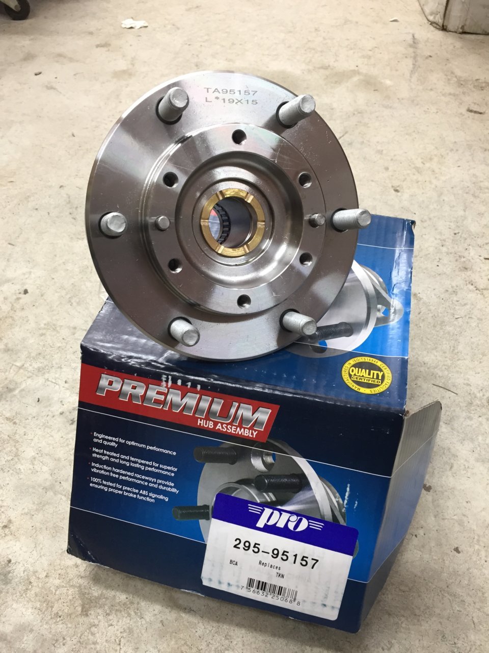

    He stated I assumed too much, here is 2 of his made in china hubs he uses that I ordered on my own. 40 bucks on rock auto. Same style markings, same hub, same needle bearing. Guess what, one will barely slide on my cv, one doesn’t fit at all like my problem one. LOL. They are different sizes out of the box...china woohoo!
    You be the judge...
    His hub:
    Durago 295-95157:
    Look at the sticker under the sticker... china
    Other members have rebuilt his kit and used the same hub above. Theirs did fit and work without issue. Leads me to believe the quality control isn’t there on the non-oem parts and its a roll of the dice if you get stuff that will work or not.

    Also, did you ever measure the OD of the shaft? Mine is 30.02 - 30.05mm depending on where i measure it. The bearing ID is 30mm. I didn't look up the min max tolerances for the bearing, but that kind of slight oversize would lead to this exact problem. Hubs have the same loose tolerance so if you get the right set, all is good, and if not, then it just barely won’t fit properly.

    That bearing surface on the CV stub is HORRIBLE. I have done a fair amount of lathe work and I can tell you that part was made with too fast of a feed for use as a surface for rollers to run on. All the parts I build have a smoother finish than that, even if it’s just cosmetics. Ideally that bearing surface should have been ground to achieve the final bearing surface. Even if a grinding process is not used, it’s still very possible to achieve a much nicer surface with a lathe.
