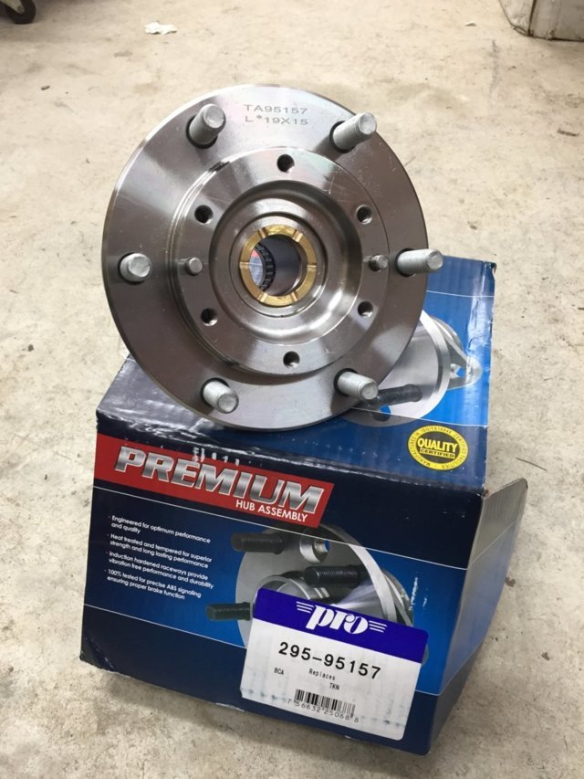

    To be less confusing in my reply, when I say hub I am referring to the wheel hub which the wheel bolts to, not the manual locking hub.
    This sounds similar to the problem I and others had. The hub bore for the inner needle bearing was machined too small, but just ever so slightly so it isn’t easily noticed. When assembled, it would take the required bearing clearance away and destroy the bearing while driving. When you assembled it, and rolled the wheel, it had a slight drag on it while rolling, and it would try to pull the wheel hub and outer cv shaft together towards eachother, this wiped out the inner bronze piece on my truck.
    I solved mine by purchasing multiple dorman wheel hubs and using one that did not have any drag on it when you put the cv shaft in it. They are chinese parts so its a 50/50 if you get a good one or not.
    https://www.offroadsolutions.com/products/category/drivetrain/
    This is where I got a replacement bearing and bronze pieces if you want to try this route. The problem is if the hub is machined incorrectly replacing this bearing will result in the same problem.
    Wheel hub replacement: dorman 29595157
    I would recommend doing some troubleshooting to make sure this is your issue, and if so, buying a whole replacement wheel hub like above. Checking the fit of your cv shaft and the hub on the workbench is how I solved it. Might have to order a few to find one that works.
    digitalferg likes this.
