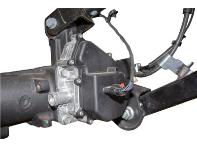

    ^Modern Wranglers/Gladiators still have it, but changed to electric actuation like Toyota's:
    From what I read, Mopar offers an electrical bypass kit for people upgrading to chromoly axle shafts, bigger axles, and/or manual hubs.

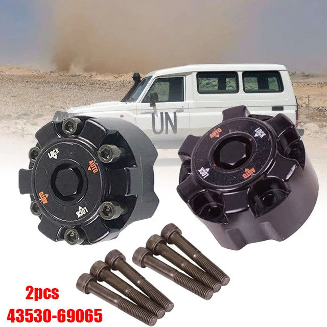

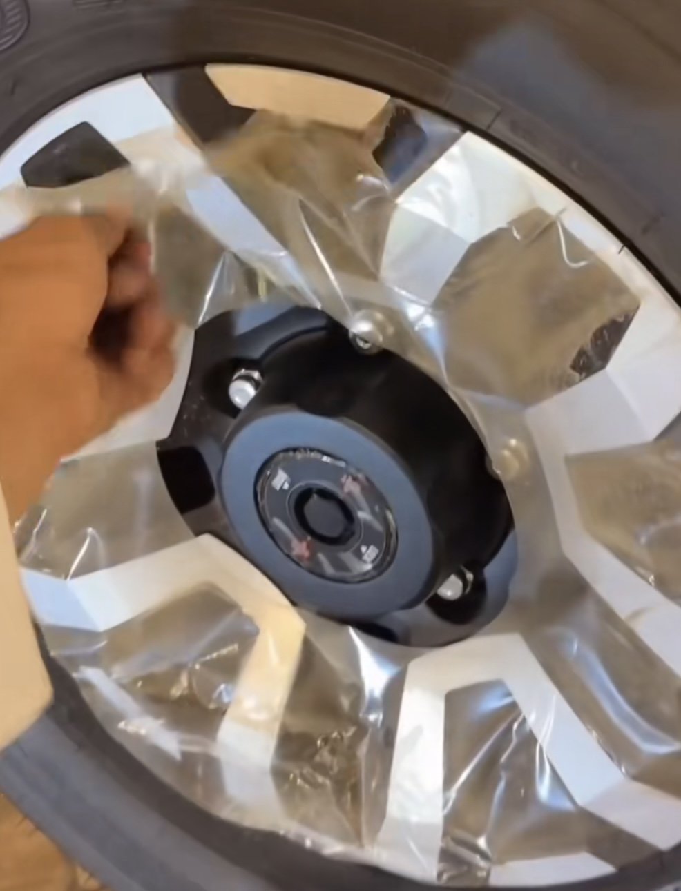

    looks like new LC might come w front manual hubs. I wonder why
    me figuring out if these are compatible with 17x8.5 Method 701 bead grip, red CVJ high angle boots, and future compatible with longer travel 934 RCV, and when it becomes worth to just do MarTec SAS which may or may not entail manual hubs
