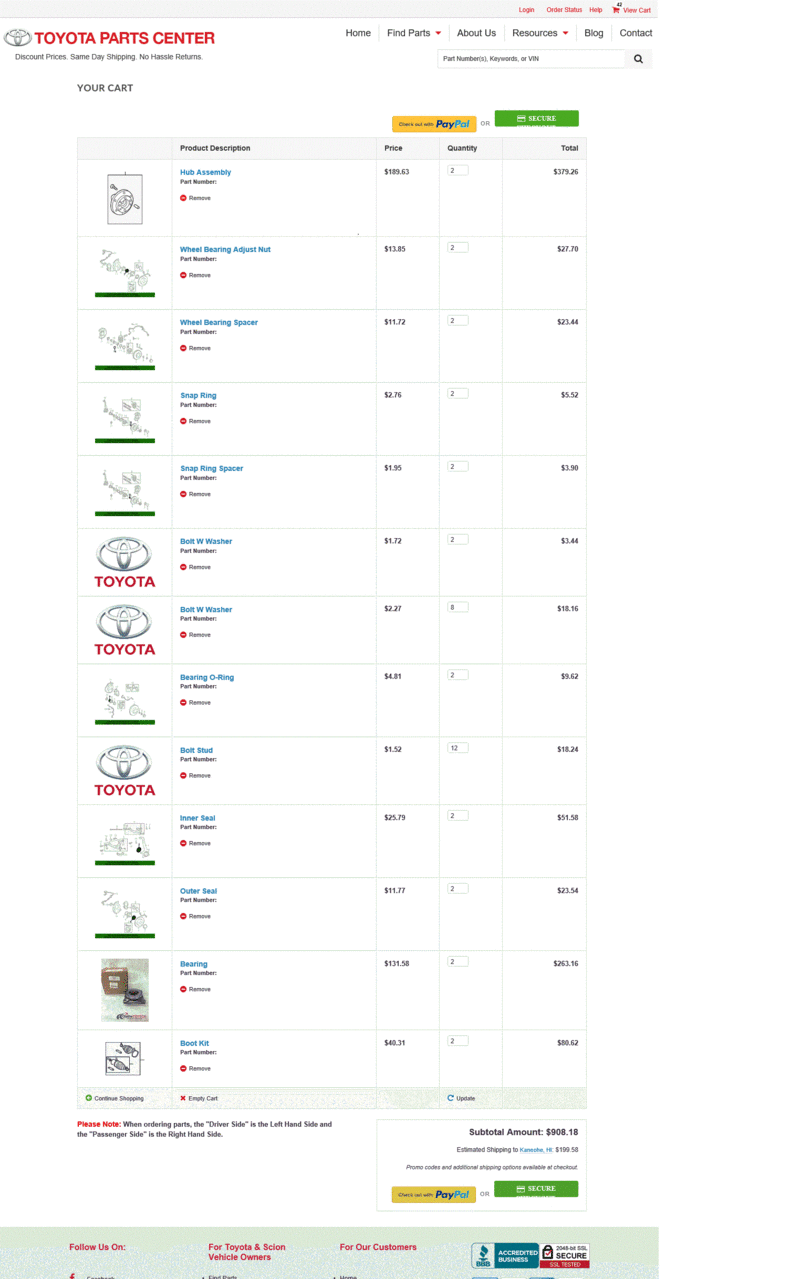

    I think this could really take off..... if it cost about half as much.

    Absolutely, but unfortunately I don't control Toyota's pricing.
    To give you an idea, these are the parts I have to order. These prices could be a little lower/higher but generally in the ball park.
    Then add the manufacturing/shipping costs for the custom stuff.
    You can not make this kit for the same price you can buy it from me, let alone the time/money in R&D.

    That "s just what all these guys needed to see !! Including ME ! I hope you make some profit ?? Your time and R& D
    is very much appreciated !!!! I hope to install my awesome kit soon , Thanks & Happy Trails 2 us all

    I knew there were hidden costs. I am going to try and pick up one of these in the new year..

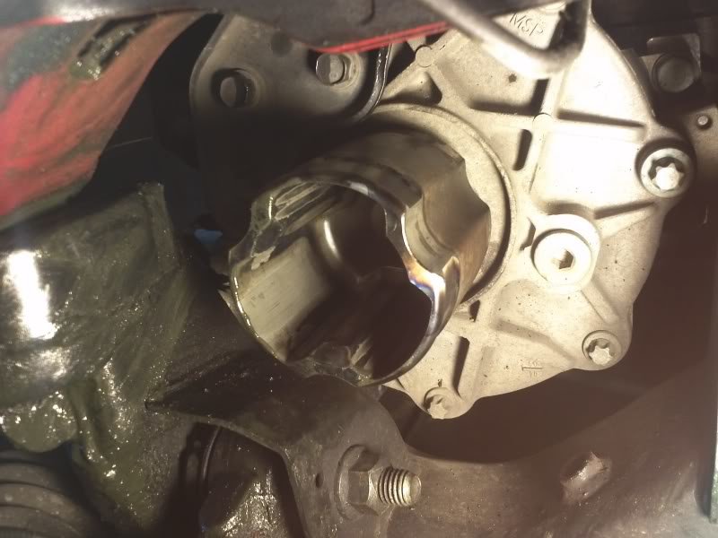

    These two videos give a visual of the process.
    Removal
    Rebuild
    I suggest to remove the inboard joint's clamp and slide the shaft out of the housing, leaving the housing INSIDE the carrier diff. It will look like this

    like that Idea of leaving inward joint in ! ? BUT how would i put new oil in that joint ? also now that this will be a free wheel hub ,
    could you use GREASE on outside CV instead of oil ? ( like old school Toyota Birfeilds ) ? I hope to install my hub kit soon ?

    There should be only grease, no oil anywhere.

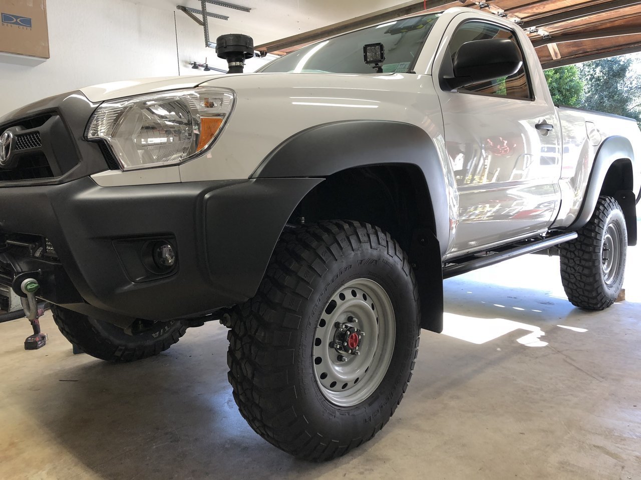

    Damn that's clean, me drool.

    And this is how 4WD trucks should come from the factory!
