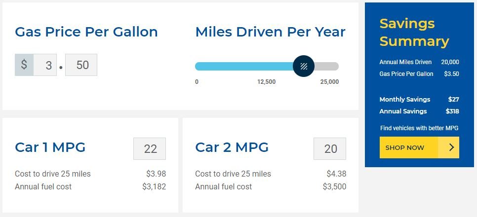

    What's 2 mpg savings over 20,000 miles at $3.50/gal?
    tonered likes this.

    Fuel is about $3.65/gal where I live but I realize that's high vs national average, however VERY likely to be well above $3.50 40k miles down the road.
    With these numbers it will pay for itself after 60k miles, realistically well before that with the way gas prices are going up.
  20. Aug 8, 2018 at 12:32 AM
    #60
    05Taco4x4
    05Taco4x4 [OP] ToyotaHubs
    Jun 29, 2011
    #59085
    6,257
    2TR-FE Enthusiast
    FJ Tcase, Manual Hubs, 2017 Head unit, Mirror Riser
    + cv boot, 2lo .... I'd say there's value in it
