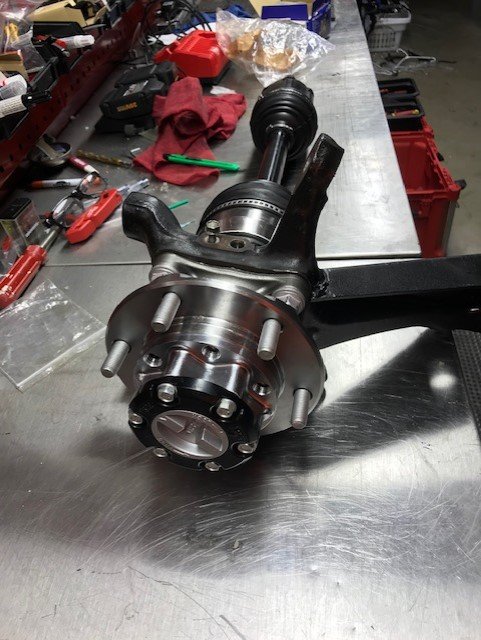

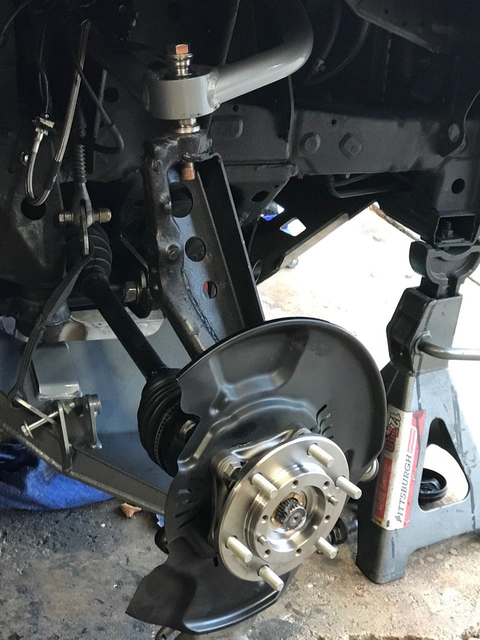

    I purchased the kit a while ago and got everything together recently on my 3rd Gen LT truck. Since I was building axles from scratch it made sense to buy this set-up. Used +3.5 axles. Took apart inner CV which is easy and messy Outer CV just pops on. The hub assembly, seals and adapter all fit just fine. I test fit everything on my rig and it looks to be good to go. Just waiting on shocks to finish her up. I was really excited to get this kit and many thanks to OP for offering it. I see no issues with compatibility on 3rd Gens. Everything fit together. Top quality parts.

    Awesome, looks good!
