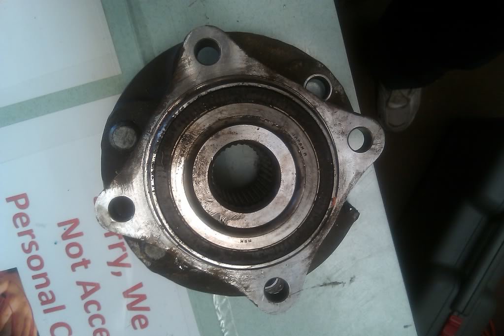

    OK, I am incorrect on one part of my information. Here I am at my shop and I completely forgot that I have the old bearings from two different jobs. Here are the facts. Then we can discuss if it can be done.
    The first photo is of a second gen hub and bearing assembly. It includes the hub, the bearing, as well as the bolt-on race. This entire unit the bolts onto the second generation Tacoma.

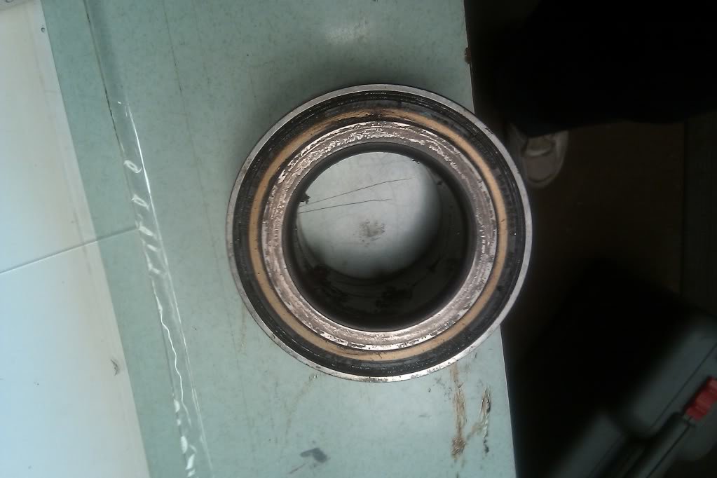

    The next photo is of a first generation hub bearing, alone.

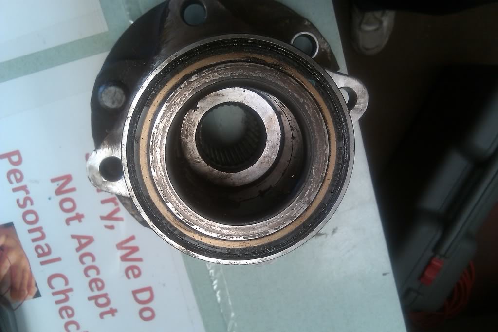

    This next one is of the 1st gen bearing placed on top of the race assembly of a second gen. Note that the outer diameter of the bearing is larger than the race assembly of the 2nd gen. This means that the 1st gen bearing will NOT install into the 2nd gen race.

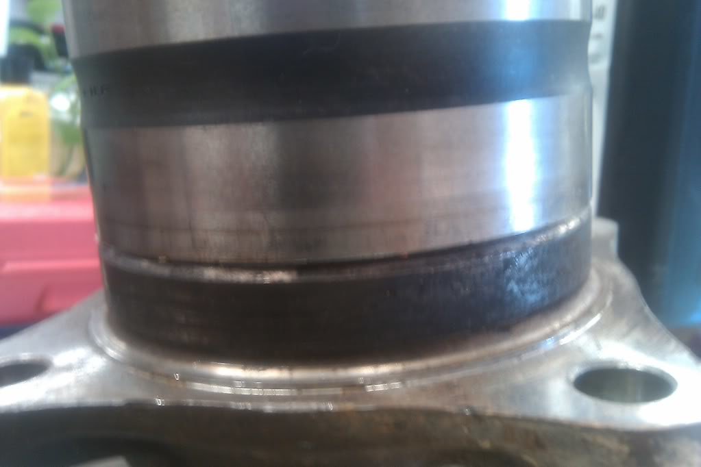

    This is where I was incorrect. The last photo is taken from the CV shaft point of view. It DOES appear that the diameter of the inner bearings on both the 1st and 2nd gen is the same (I don't have a micrometer to measure this, and I don't have another hub from a 2nd gen to see if it presses in properly) This could only be tested by a micrometer, or a press-fit test.
    What this indicates is that you MIGHT be able to press in the hub from a 1st gen, selectable into a second gen bearing assembly. This leads me to believe that you can now reduce the parts list for this conversion to the following:
    bearing from second gen (don't try reusing a bearing from a hub....just don't)
    selectable hub from 1st gen.
    selector itself
    CV shaft
