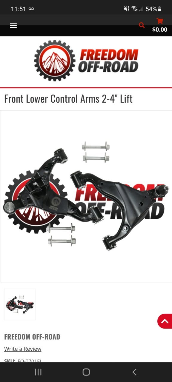

    08 Tacoma TRD OR
    I just saw some folks talking about the Freedom Offroad LCAs on FB so I went and checked out their website site. The LCAs are described as being made for 2"-4" lift but the pictures look just like OE stock photos. I've seen a couple people mention that their trucks alignment came out in spec from Firestone o_O. I'm wondering if anyone here is running them and if they are any different than stock. I'm running Total Chaos UCAs with the corrected caster for lift and am curious if my caster would be too positive paired with caster corrected LCAs or if that'd get in the sweet spot. Truth be told I don't know what my numbers are at currently as I'm very lazy and have full access to brand new alignment racks at work.
