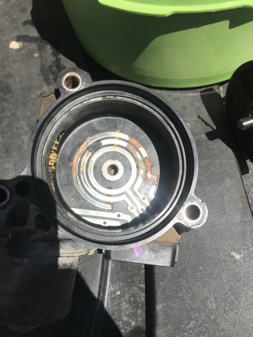

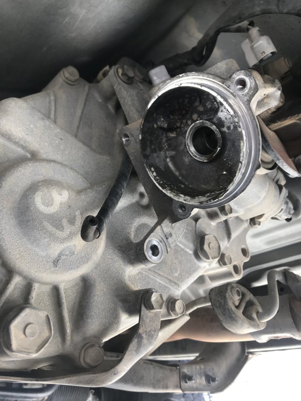

    When the vent line on the xfer case actuator is cracked and loose ,and its been full of water for weeks. I should have taken a pic of what it looked like before I wiped out the muck.
