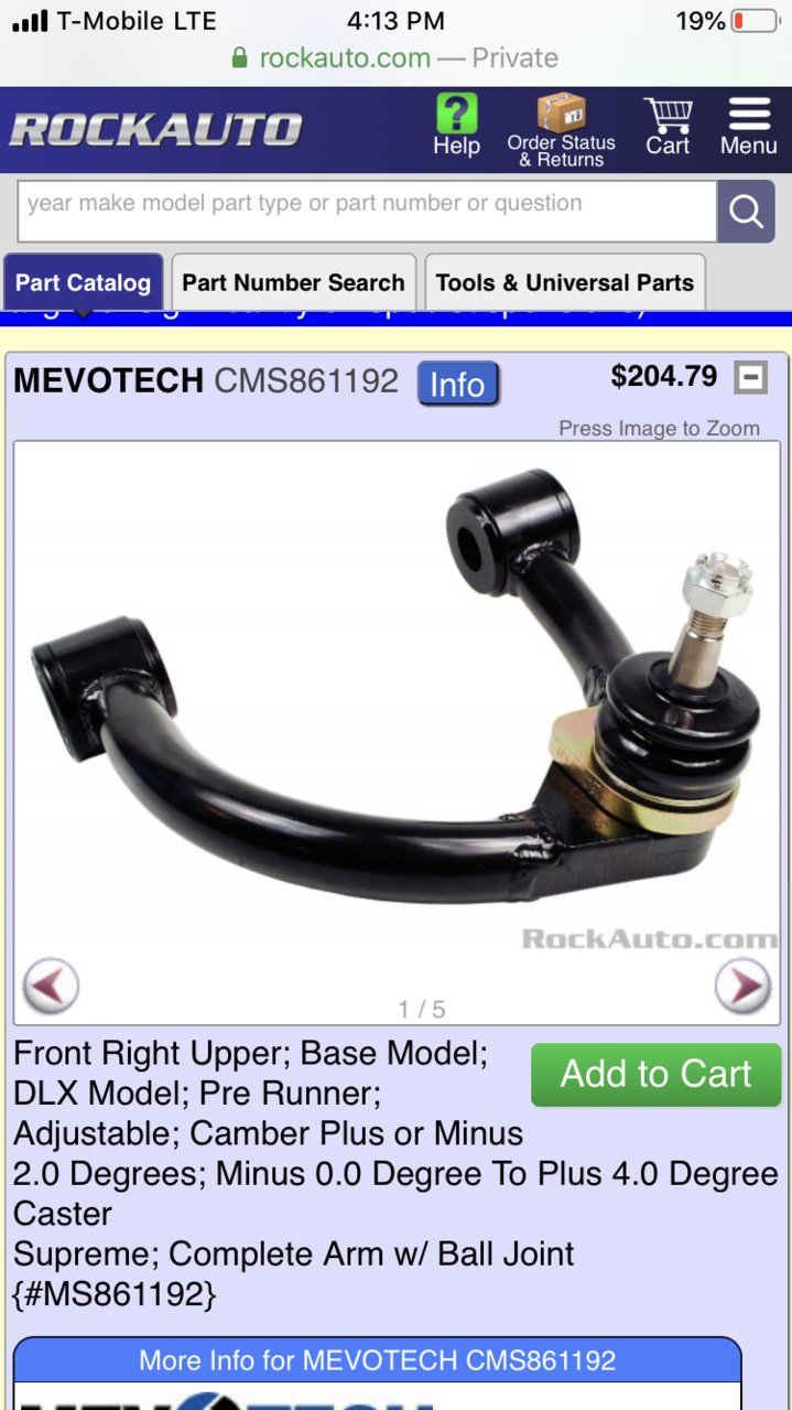

    My buddy got these and they are labeled SPC in a Mevotech box. They are SPC arms

    those arms dont look the same as SPC's. The pictures of these ones show tubular ones whereas SPC has the laft arms.

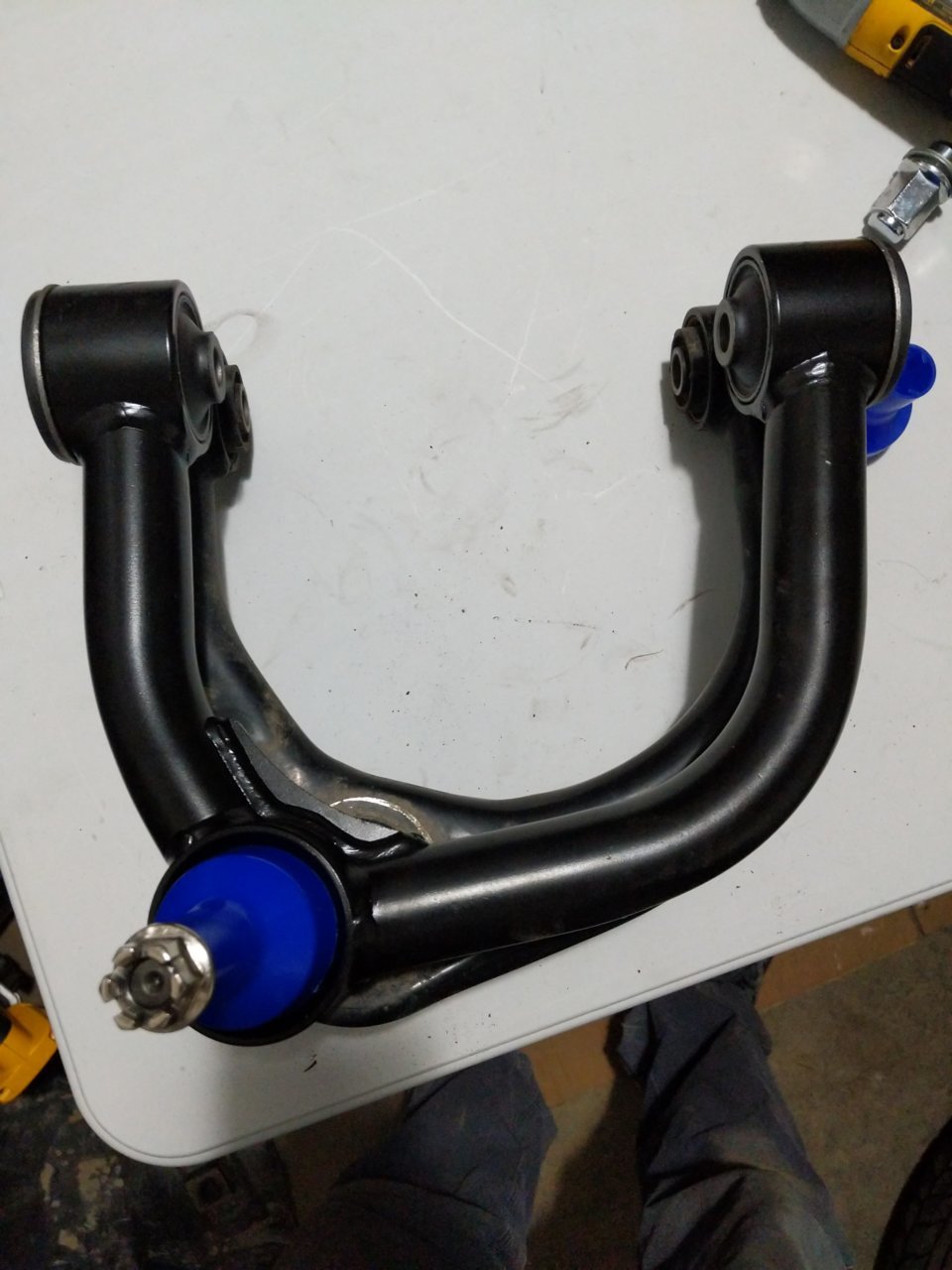

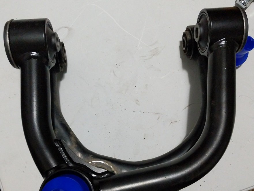

    I got these arms based on this thread - I will say Freedom Offroad is unfortunately mis-speaking on their product. It does provide caster correction to a degree - not as much as SPC's etc. but I would say at least in line with Camburgs. I've got a 2.5" lift on my 4Runner and I'm sitting at 3.8 caster - I think if a specialty shop did it they could pull 4 degrees and keep everything else in spec.
    The ball joints are moved towards the back of the truck, which is what give you caster.
    Edit - I've been a lurker here for quite some time - figured I'd finally chime in! Also, I've got about 6K miles on these arms and ZERO issues so far.

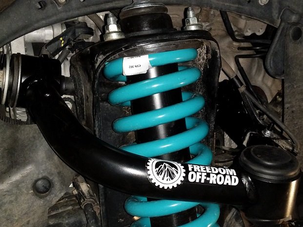

    Also, this. Who knows? They have enough room for 5100's and 886 coils and some to spare, but I didn't want to risk it with the extended King's.

    Positive caster. Yes. They state nothing changes but I'm sitting at 3.8 and 4.0 caster with a 2.5" lift (at least on my 4Runner). It's unfortunate they are mis-speaking on their own product. Here is a photo of the arms directly over OEM arms - the real difference is the ball joints are moved towards the back which in fact does provide caster

    Good to know, so the ball joint being set further back helps eliminate the positive camber?
