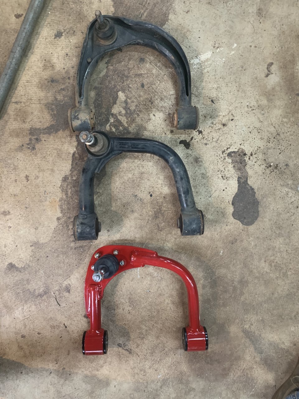

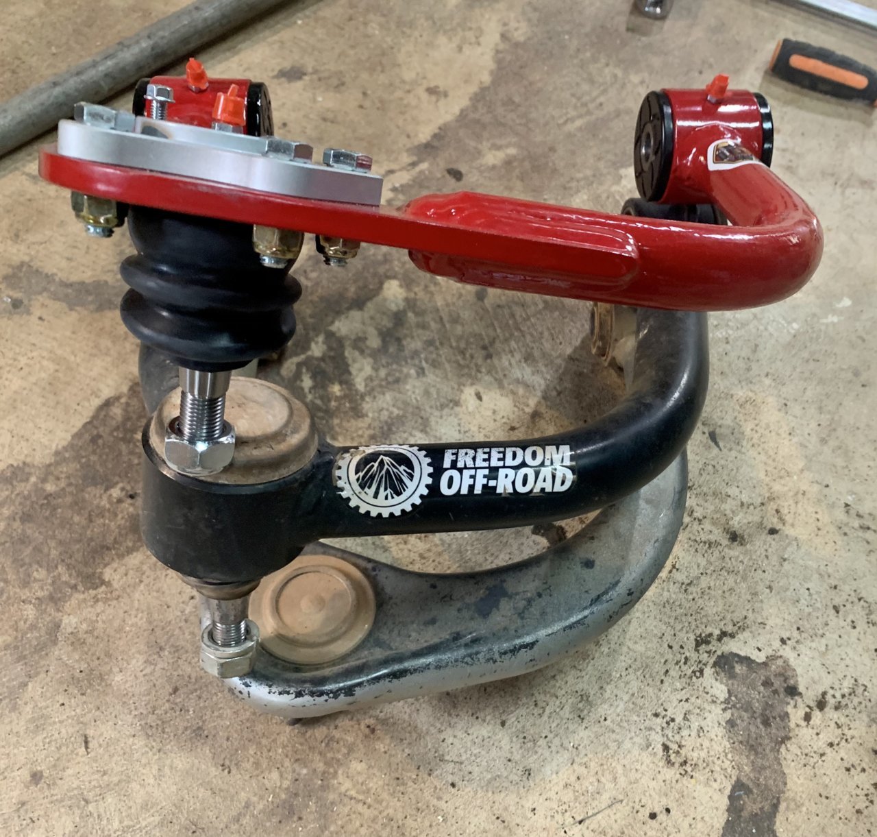

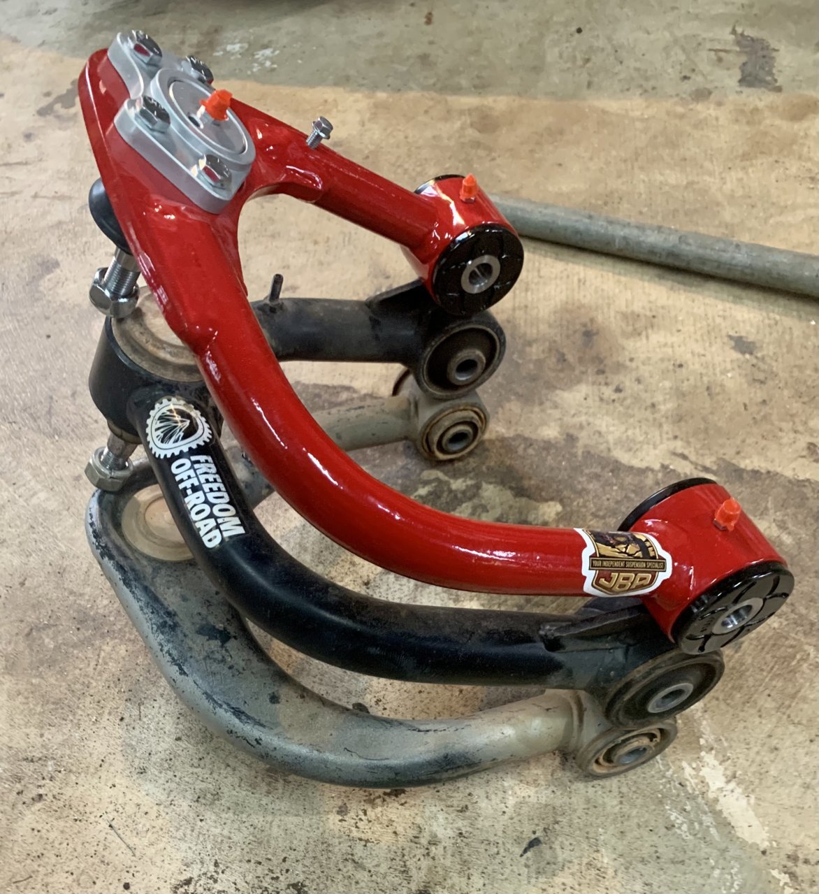

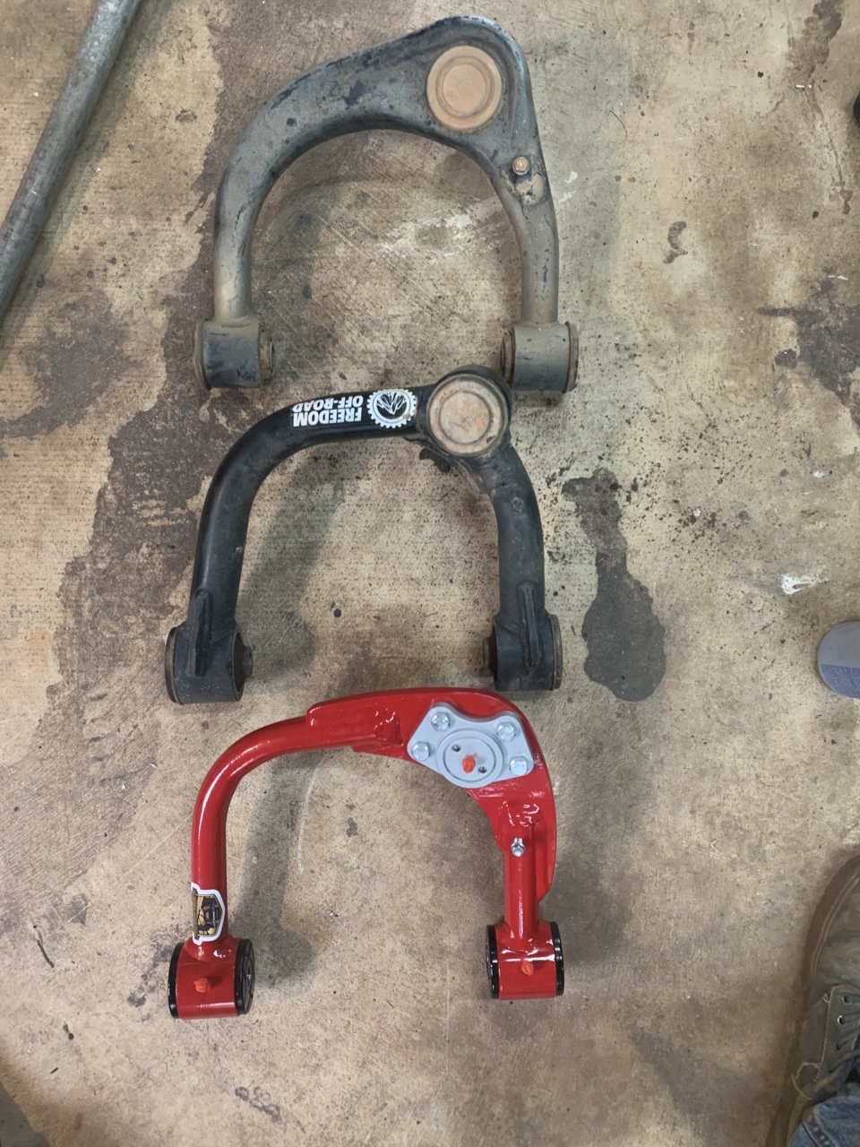

    So here’s the best comparison pictures I could make between the JBA, OEM, and Freedom. I am 95% sure the Freedoms would have been fine with the extended kings. They didn’t come close to contacting the old coil over and I had 3.5 caster0B1FBB61-CA9B-4122-B686-7AA423F85421.jpgEF1E6185-E7DD-4719-8323-A1B84AF7E0B1.jpg D7A12647-EBE5-48B6-843C-CB0EE53EEAA7.jpg4EA39B94-1F17-44F9-9CF9-B825429DB690.jpg

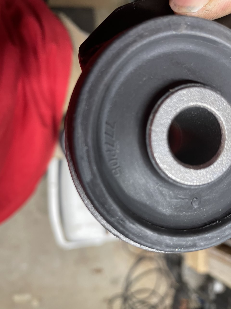

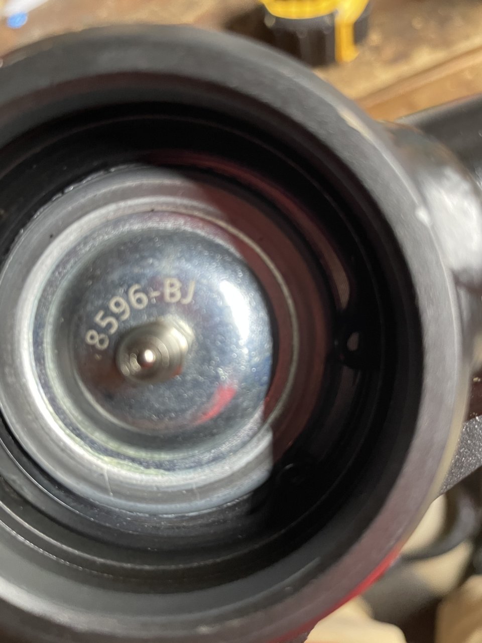

    I just got mine in yesterday. I did take some pictures of the ball joints mine do you have a number on them however I was not able to cross reference them into anything. I did write freedom off road And there are response was they are proprietary ball joints. Also my bushings had a number on them as well. So if anybody is better with part numbers and cross-referencing I think that would help us all out
    53B6B56C-399E-496F-8819-44AA6BB08D96.jpg 5501E8CB-4A23-4C98-B277-42039D77D43A.jpg

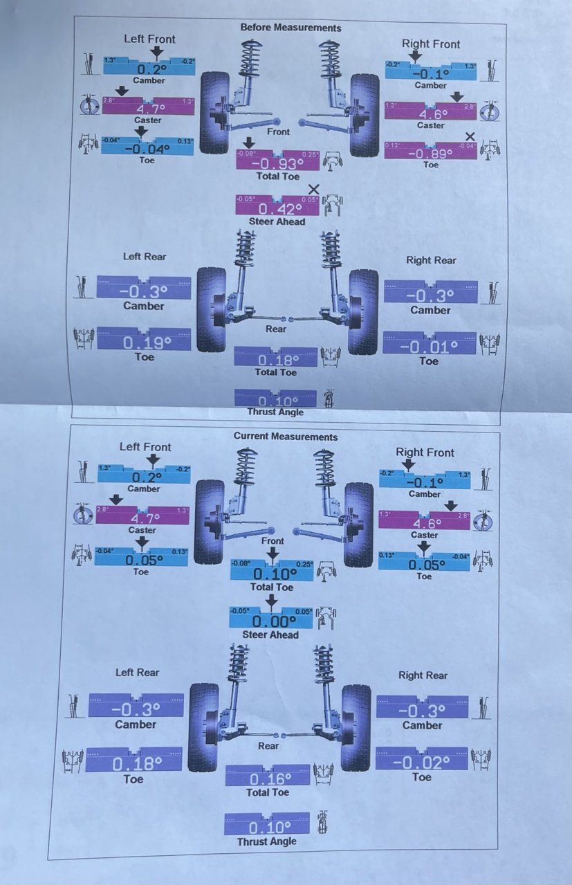

    Recently installed freedoms UCA, 5100s with 885s. Here’s the alignment post install. And about 150miles of break in.

    do you want that much caster?

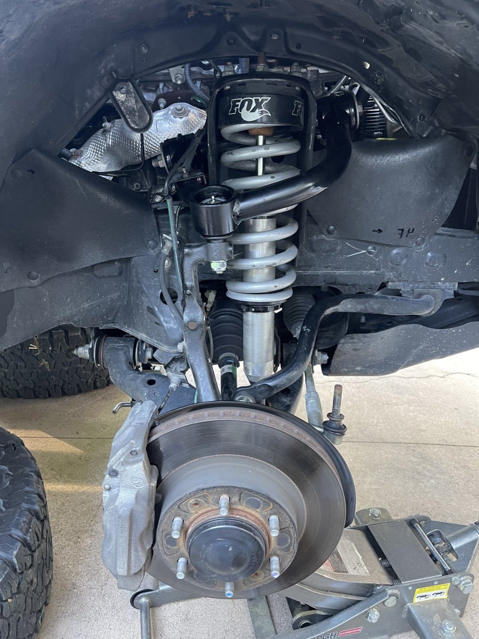

    2019 Cement TRD Off-Road
    I bought a set off the marketplace back in the winter. I just got around to installing them over the weekend. I can't get an alignment until next week, but overall they feel great so far.
    The bushing were in great shape, but I wanted to replace the ball joints. I had to order them straight from Freedom Off-Road because I couldn't find any parts store equivalent. I managed to get them out with a hand ball joint press, but they refused to go back in and fully seat until I took them to work and used a 20T shop press.
    I run Fox 2.0's and had to raise my front about 4 turns, but that needed to happen after I installed the Icon AAL in the rear and left the stock overload in place. I'm still a little higher in the rear which works out great when I have my bed rack and tent installed.
    Overall pretty happy with the UCAs. I'll post alignment specs next week.
    If you contact Freedom Off-Road they can sell you just the boot (crazy how fast a shop press can tear a piece of rubber). They are also pretty easy to install with a curved pick.

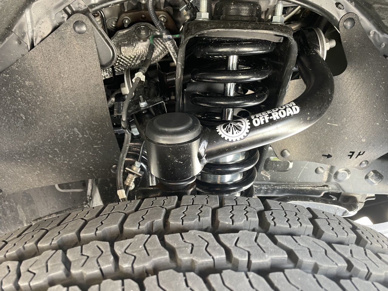

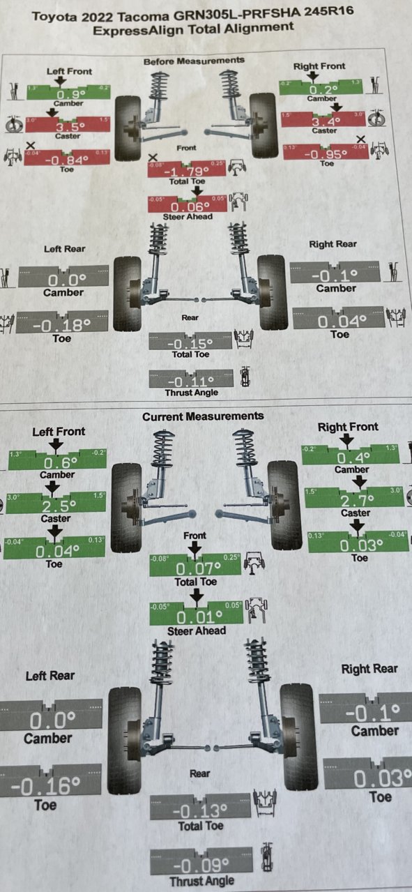

    Installed the Freedom UCA’s with Bilstein 6112’s up front. A lot more clearance compared to the OEM UCA.

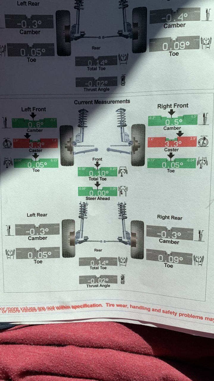

    My question is related to the alignment. I’ve seen some numbers that are a bit all over the place. Admittedly I know very little about alignment in relation to aftermarket suspension other than the very basic stuff. I took it to a local shop and the guy had it taken care of in just about an hour.
    Everything is in the “green”. I’m guessing this is all in relation to OEM alignment specs?
    8BA1EE8C-01DB-4B5D-AD9D-F6E828C0E997.jpg B8BFA1E8-9DB8-4575-BC98-39AF769730A9.jpg

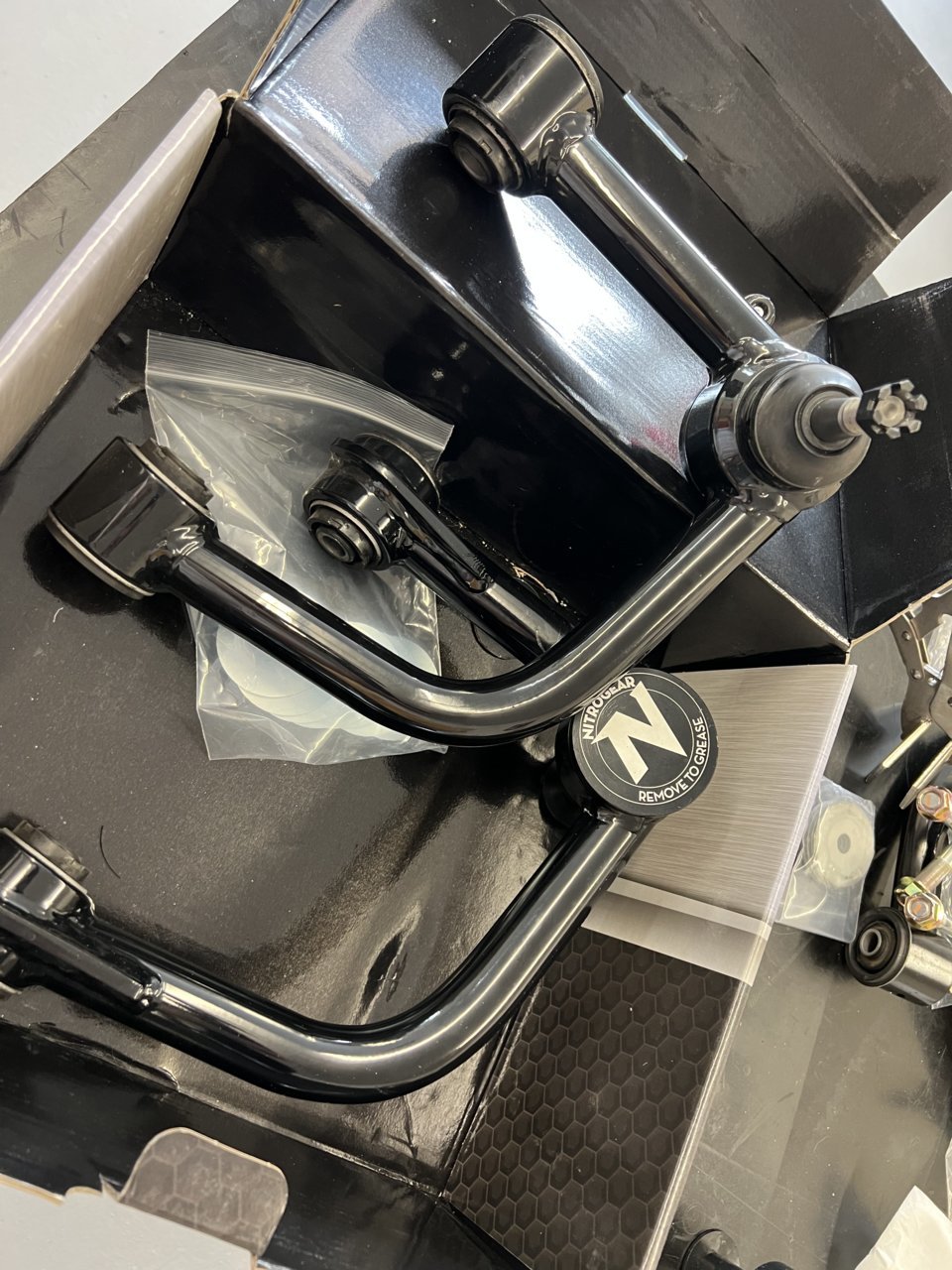

    The freedom upper control arms look a lot like my my Nitro Gear upper arms do they use rubber factory style bushing? My Nitro Gear arms are for sale if anyone is interested they have about 500 miles on them I removed them because I have 10” wide wheels and it was causing to much tire rub with the added cast.6F67F53D-B755-4A84-AB6A-4649098E56AA.jpg
