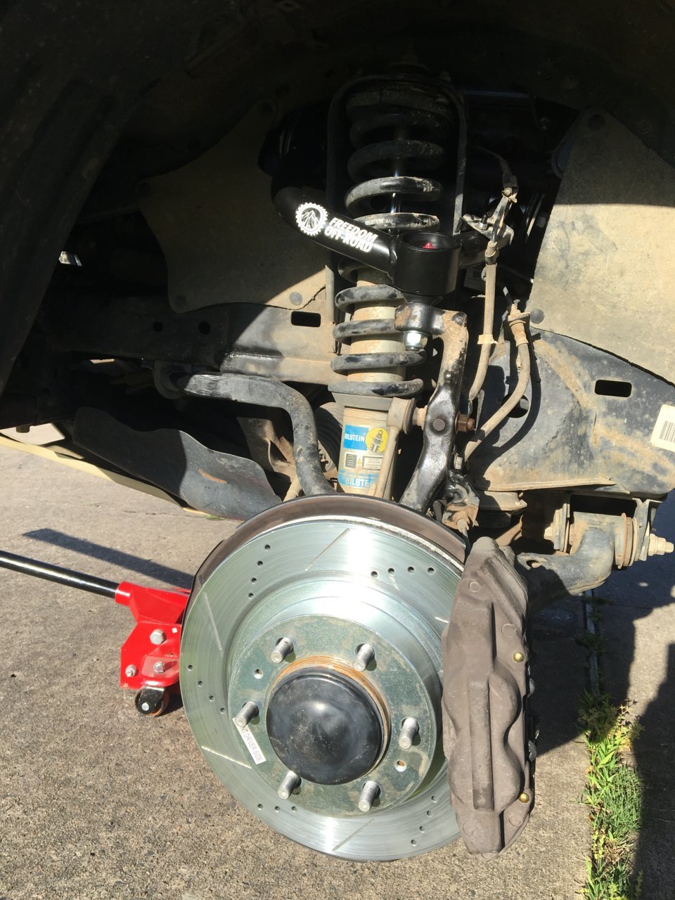

    Anyways, I got mine, they look good! I will be installing these Friday and then Saturday AM going to Toyota for an alignment ($80 special). I will report back with numbers and impressions... look forward to a 2-3 degree caster setting, TRD pro front suspension leaves my little 4 banger a little jumpy on the front end...
    757yotas likes this.
  17. May 10, 2018 at 1:44 PM
    #137
    js05_14
    js05_14 Member
    Oct 6, 2016
    #199109
    16
    2007 TRD Off Road AC
    Got mine installed last weekend. They seem well made and the install wasn't too bad. I took it to Firestone for an alignment. I asked for 3 degrees caster and 0 toe and camber. The tech set the caster at 2.7 degrees passenger side and 1.8 degrees drivers side. He got my toe and camber set near 0. My truck drives noticibly better because I had excess camber and low caster before the new UCA's. I want the drivers caster closer to the passenger so I plan to try a different Firestone soon since I got the lifetime alignment.

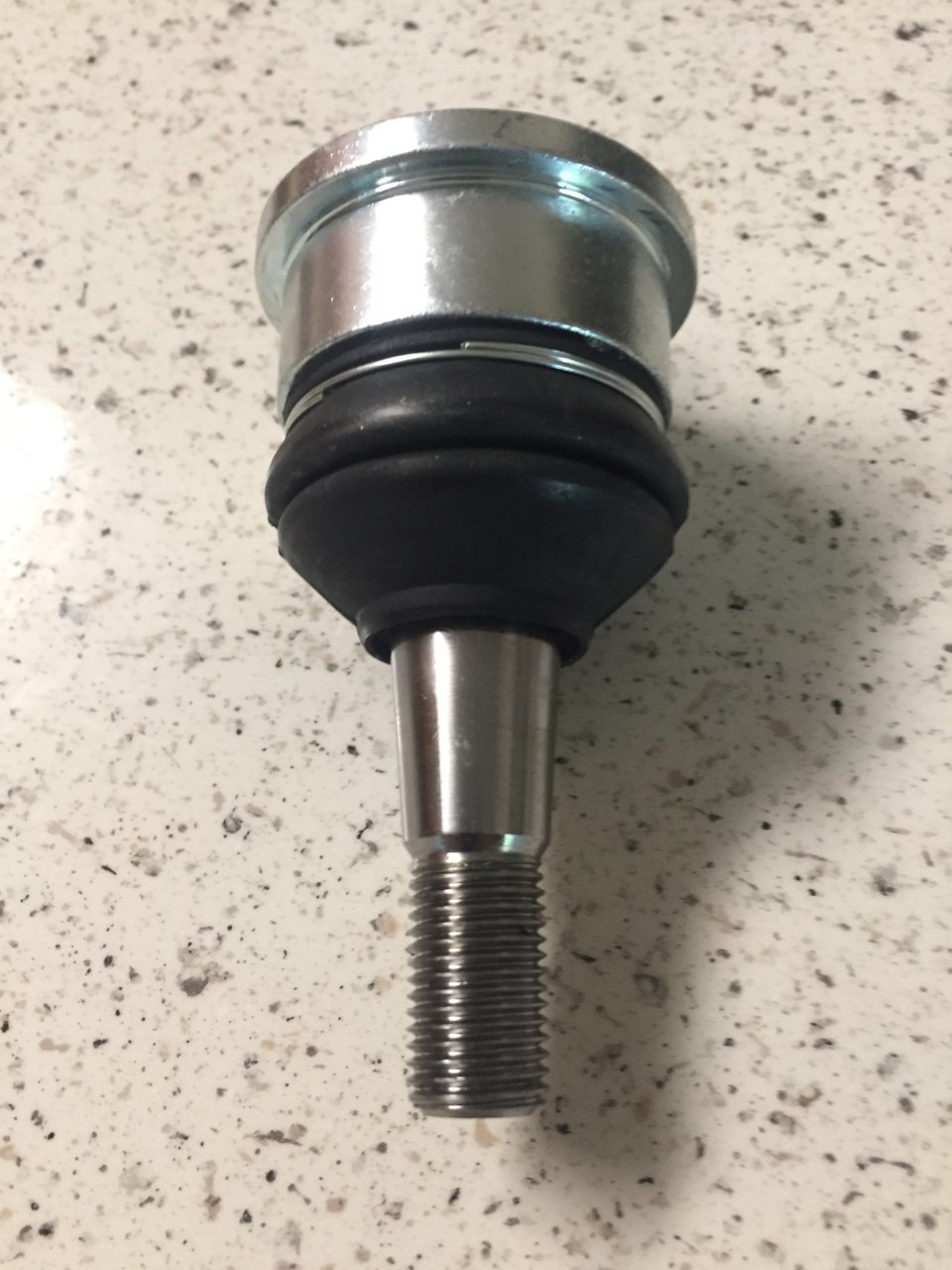

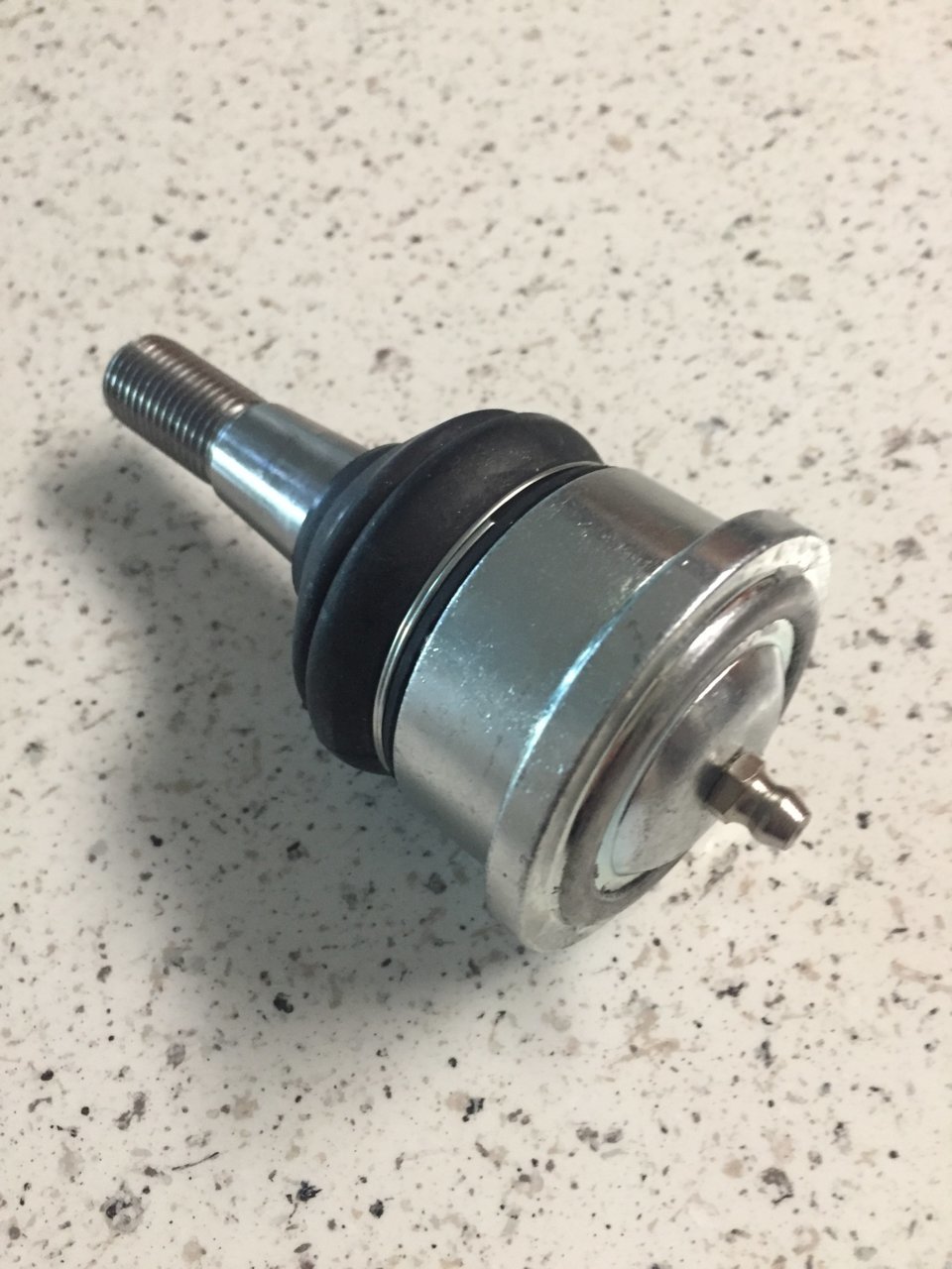

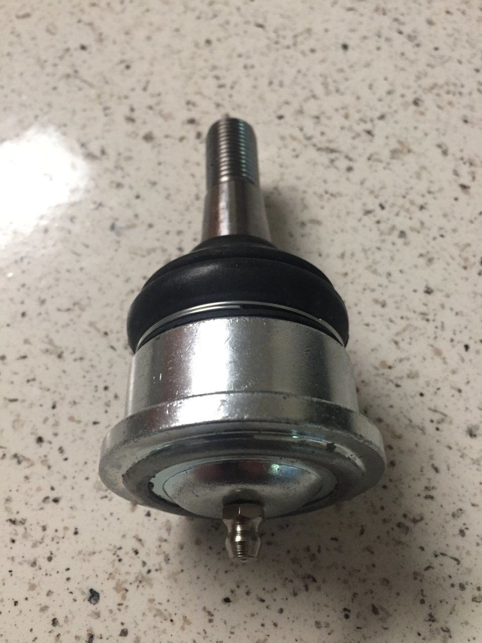

    Here’s the replacement ball joints. By the way they are only lifetime warrantied against defects not normal wear and tear.
    I don’t see any part numbers and at first glance they appear proprietary. If anyone recognizes these as factory style or otherwise feel free to chime in.
