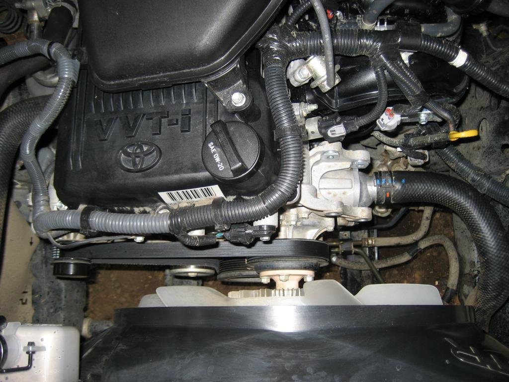

    I had no choice but to take the unwanted added options when I got my 2012, and so I set to work on removing them today.
    With the power steering and the AC removed, a smaller simpler non serpentine belt now only drives the alternator and water pump freeing up more power to move the truck. :)

    It's just a personal preference. AC is only dead weight as I neither need it or use it, and I've never liked squishy power steering because you can't feel road resistance in curves. It's just a small light vehicle and doesn't really need power steering anyways. From what I've read on racing forums, the consensus is power steering losses run from 5-7 whp on a dyno.
    I like to have a simple uncluttered engine compartment. :)

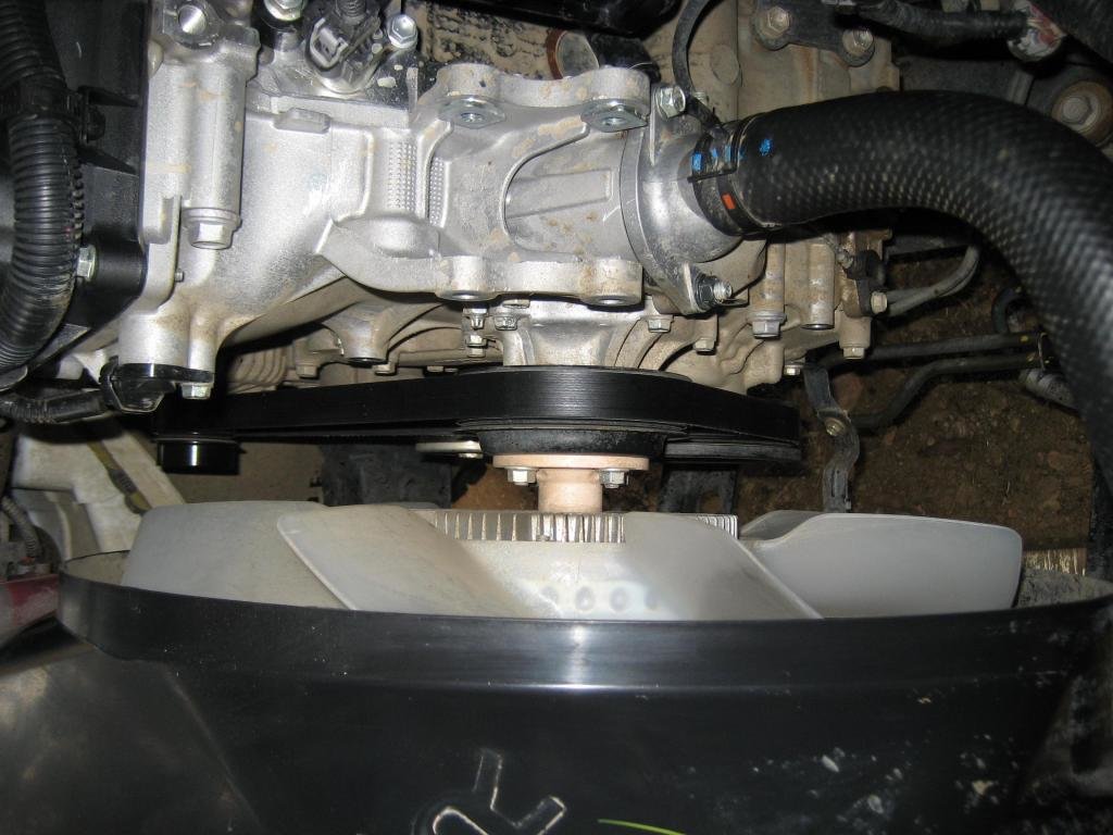

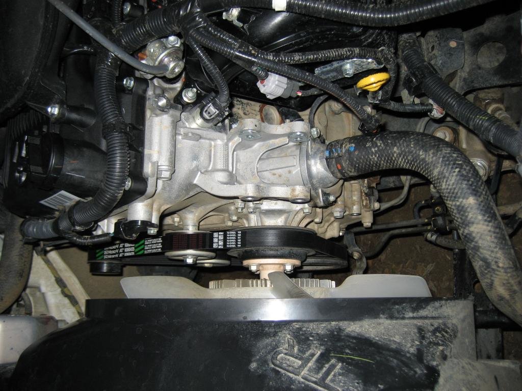

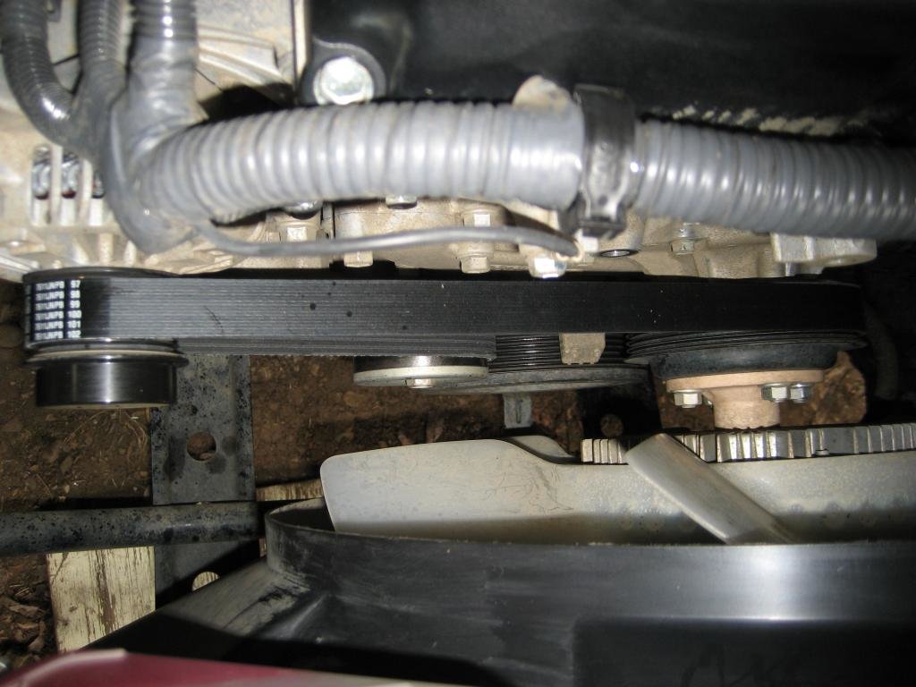

    I further refined the idea with a slightly longer belt to go around the belt tensioning idler which eliminated another idler pulley.
    So instead of the engine crankshaft working to turn 4 pulleys and 3 idlers, now it only turns 2 pulleys and 1 idler. :)
    The belt is 6 groove instead of 7 because they don't make a 7 groove that small. It doesn't need to be 7 because it's driving so few accessories.
    It took a little trial and error to find the right belt. The one that's just the right length to put the tensioner idler square in the middle of it's travel is a Gates:
    K060458
    or
    6PK1165
