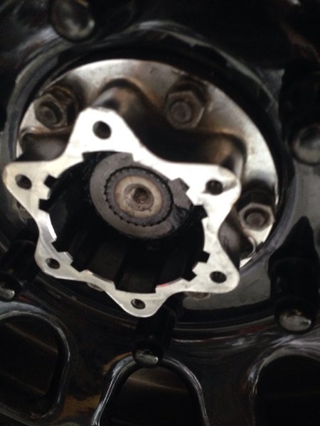

    Ok so I have all my front end parts ready to put on this weekend but I have one thing I'm unsure about. I've been watching videos on people dissassembling manual hubs and for all of theirs there was a little c clip that snapped into the end of the cv axle inside the hub but when I put my cvs into the hubs the little notch for the clip doesn't stick out at all and the cv is all the way in so did toyota just do this for their early models?

    Bummer, for some reason I didn't see this post till now.
    Mine uses the c clip. Do u have a picture?
    Is there a notch on the CV but you're saying it isn't visible when fully inserted?
    Is there a hole for a washer and bolt?

    I have a pic, another guy on here said its a bolt with a washer which is the only thing that'd make sense

    Have you looked at parts diagrams? I recall seeing bolt and washer on one of the parts diagrams I went through.
    I can't help out much since mine had the clip. But like I said I do remember seeing bolt and washer in one of the diagrams I saw while i was searching for hub stuff.

    I looked at a few schematics but I couldn't see anything pertaining to retaining (lol) the axle but it has to be that bolt and washer because the axle doesn't stick out enough for a clip

    I can't remember exactly why its needed. I mean I don't think the CV can actually slide out. I saw somewhere someone said it was to not screw up the hub. Wish I had more memory because I did look into this issue for a while as well. Keep searching the internet.

    I'm sure I could drive it and it'd be fine but I have other cars I can drive so I'm not gonna chance it. It's kinda funny reading this thread and the advice you gave me in hindsight, and is pretty true especially the part about getting all the little nuts and bolts haha. You sure were right tho I had a great time doing it and feel even more proud about my truck
