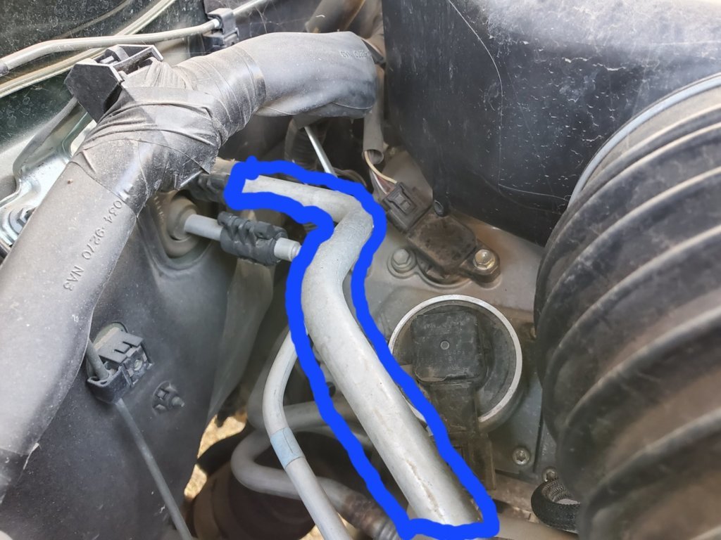

    Any shop that's gona do a proper A/C diagnosis is gona wana evacuate the system to see if it has a full charge then recharge it so they will likely charge an hour for it plus any refrigerant that is needed.
    See if your suction line is cold with the A/C running on high, if it is then your probably fine but if it's barely cool or not cold at all it's likely low.
