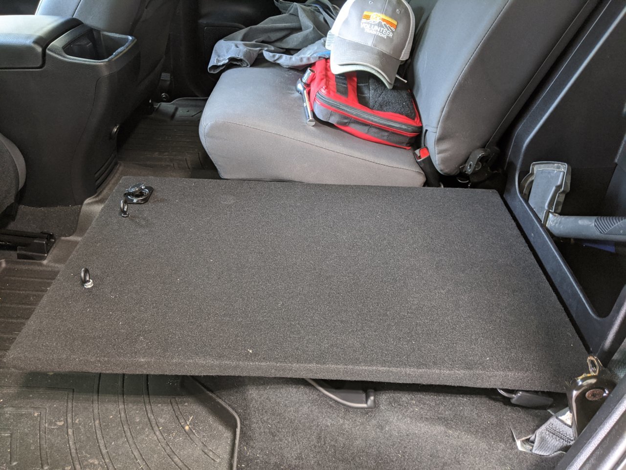

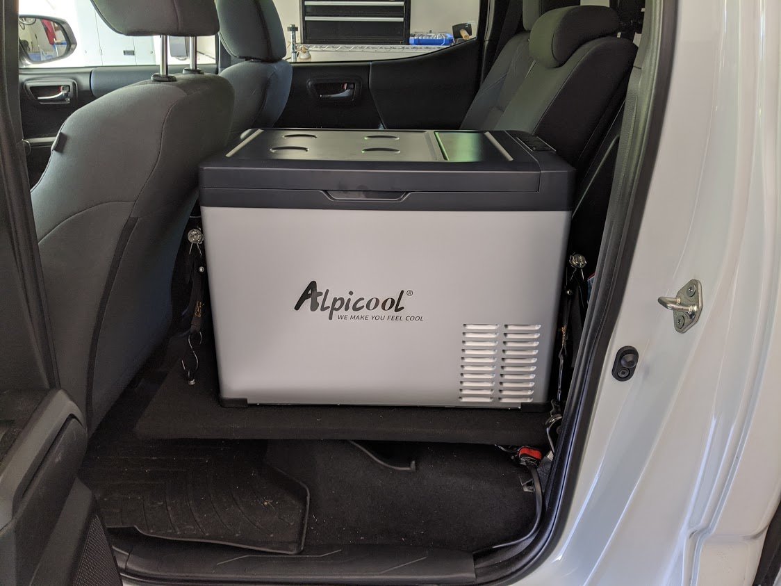

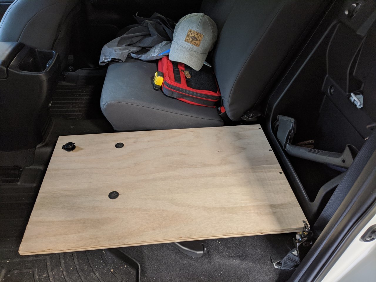

    I've got a 2017 TRD OR DC and I've decided to remove the rear driver side seat and build a custom platform for a fridge. I've got an RCI rack w/ RTT and need to use my bed frequently to haul things so putting one in there is out of the question.
    I get out to camp at least one weekend a month and when I'm not there I'm out coaching soccer so the fridge will be used almost every weekend. I've got a couple questions to make sure I'm going about this right...
    With the ARB wiring kit and stock battery how long could an Alpicool CF45 run before draining the battery? I plan on going to a 27F Northstar in the future... any other recommendations that are a little cheaper?
    Can somebody help me out with installing a switch to turn power on/off to the fridge? A recommended video or build thread would be awesome.
    I'm going to replace my cig outlet with a voltmeter gauge. Anything else you all would recommend?
    Oh, and I won't be freezing anything so the fridge won't be set too low. Cold enough to keep some drinks where I want and our veggies fresh.
    Thanks!
    *Edit*
    Here are some pics of my build:

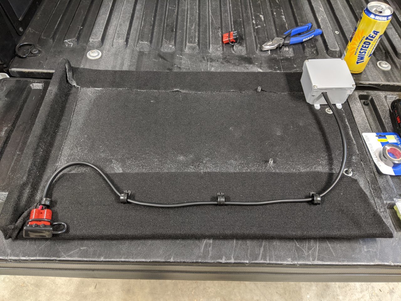

    The glue has since dried on the bottom and doesn't show. I have zero intentions as of now to drill a hole in my Tacoma so I opted to mount my BlueSea socket under the platform.

    I used the arb wiring kit. You want to go direct to the battery. It also has the screw plug so it won’t come out of the socket.
    bhayes423[QUOTED][OP] likes this.

    You can also just buy some marine wire and blue sea socket. I got the arb wiring kit free with my fridge

    Removed the back seat and taking some measurements now before I head to Lowes. I ordered some marine grade carpet and the ARB wiring kit to simplify the wiring, but I'm not using the socket it comes with. It'll only accept an ARB plugin right? Ordered a Blue Sea 12v socket to use with it since I'm not going with an ARB fridge ( Alpicool ). If I find out I'm using the fridge a lot I'll upgrade to an ARB and use the Alpicool in the shop or the GFs new 4Runner.
    Still haven't quite decided on which battery to use at this point but I'll make my mind up by the time I get done building the platform. And a NOCO Boost to keep in the car...

    Platform is built and fridge works. Now for a battery... I've decided on going with X2Power but not sure which one will be best for me. Right now all I've got that will be running when the truck is turned off will be the fridge. I plan doing a 100w Renogy setup once my Prinsu rack comes in.
    Group 31, 27 or 24?
    Is it worth the extra $100 / plus new battery tray for the 31 compared to the 24?
