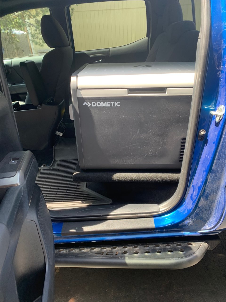

    Made a platform and installed a Dometic CFX3 55IM in the back seat. Previously had a Pelican 70QT cooler. No more dealing with buying and replacing ice!0516CCF3-8BAA-4440-B2FD-B43F5797AB05.jpg
    sbl23 and jrcuevasv like this.

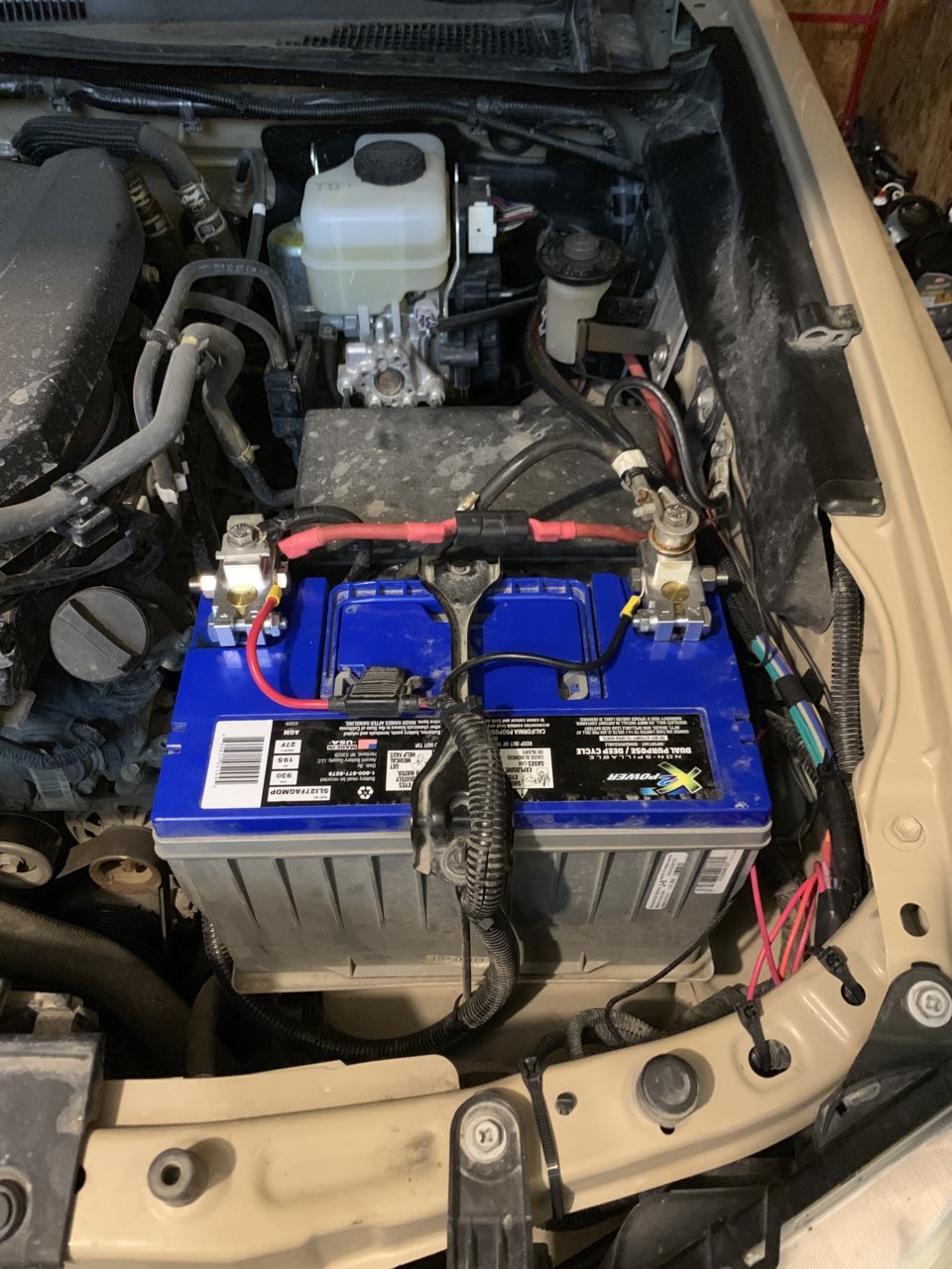

    At the very least replace your battery with a hybrid one like Optima Yellow Top. It will start your car and can take deeper discharges than a regular (starting) battery. I would also consider a foldable solar panel suitcase type and when you're parked place the panels out (usually there are two 50 watt panels) and the alligator clips on the battery and i believe you will be good!

    I went with the X2 Power 27F and it's been awesome so far. Over next couple weeks I plan on getting a Prinsu rack and mounting a 100w solar on top of it. It's never ending....
