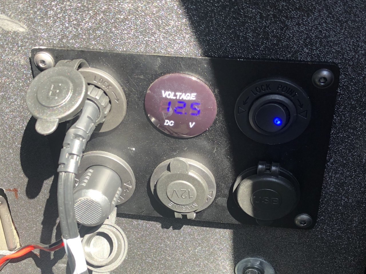

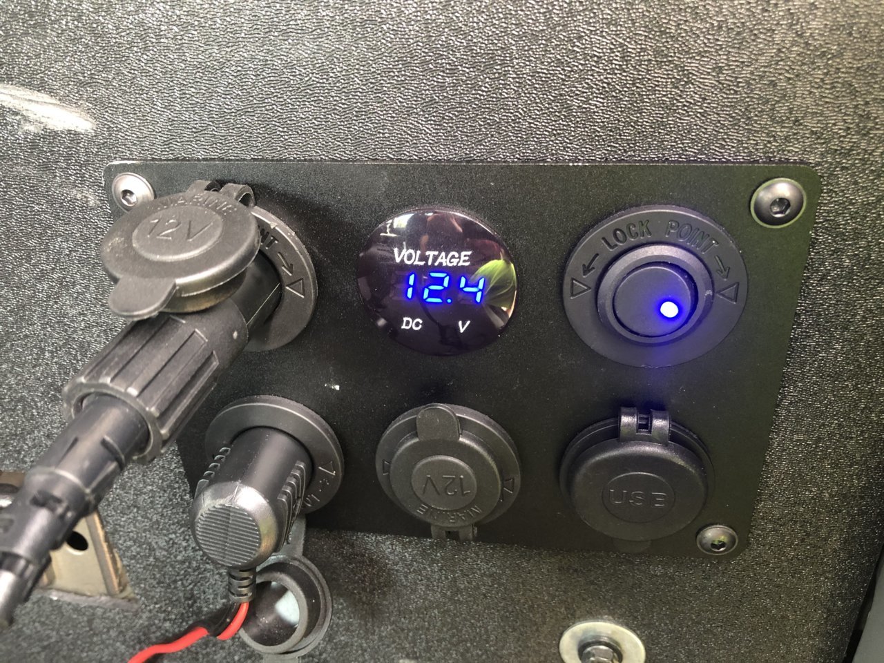

    I know many of us make our own plug panels for our rigs, and the fridge is often an important part of that. My @Dometic shipped with a really long plug to fit into a standard 12v cigarette lighter type socket. Unfortunately, it stuck out really far.
    Luckily, you can unscrew it and use a threaded connector, but you have to have the socket for it.
    Here’s the socket: https://www.frontrunneroutfitters.com/en/us/engel-socket-panel-insert.html
    (It’s also on Amazon for a similar price, don’t pay more than a couple dollars for it.)
    Check out how much shorter it is:
    Good luck!
