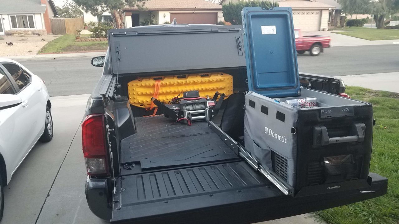

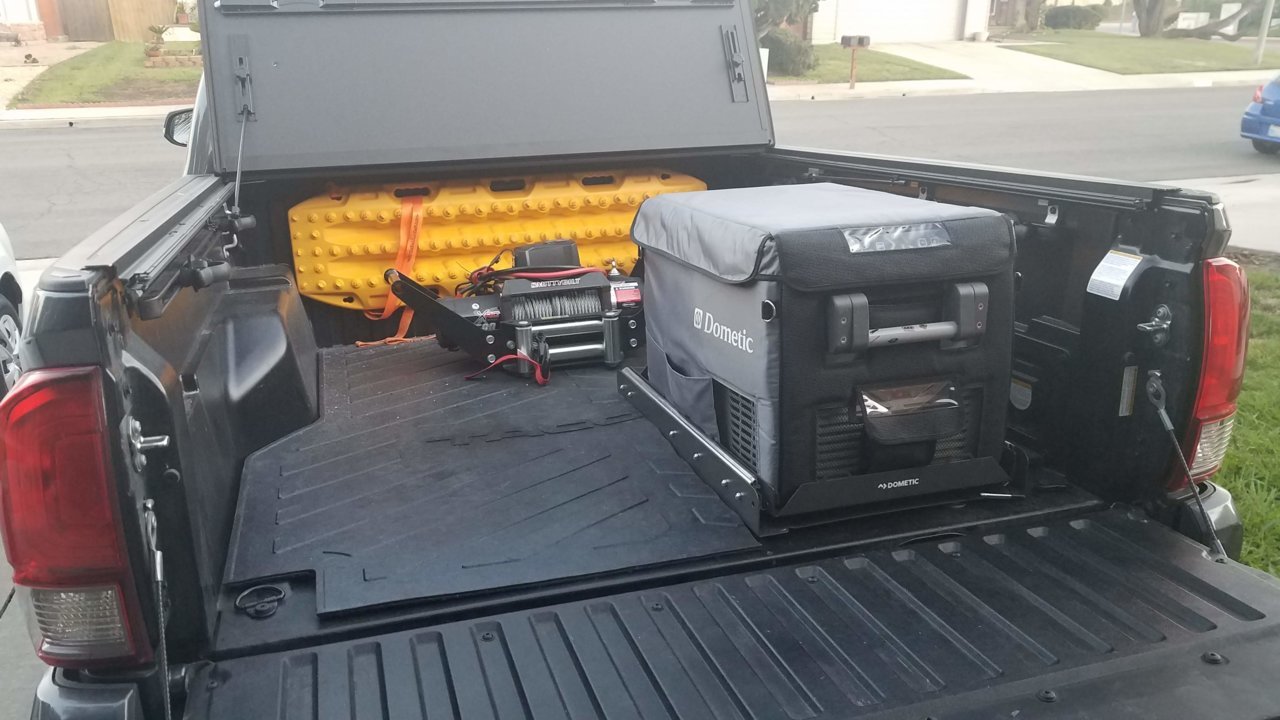

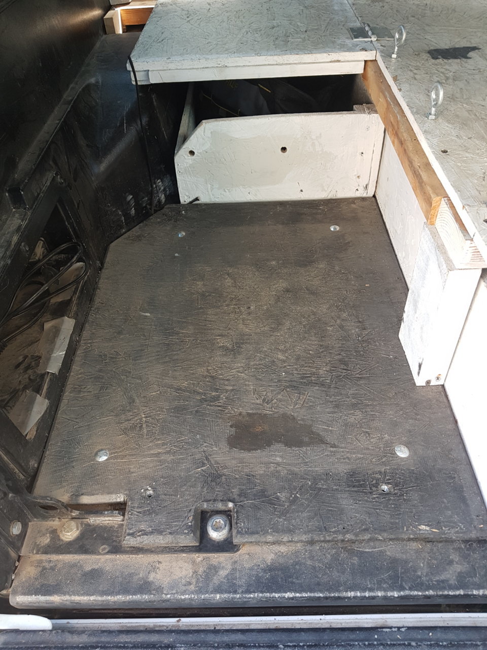

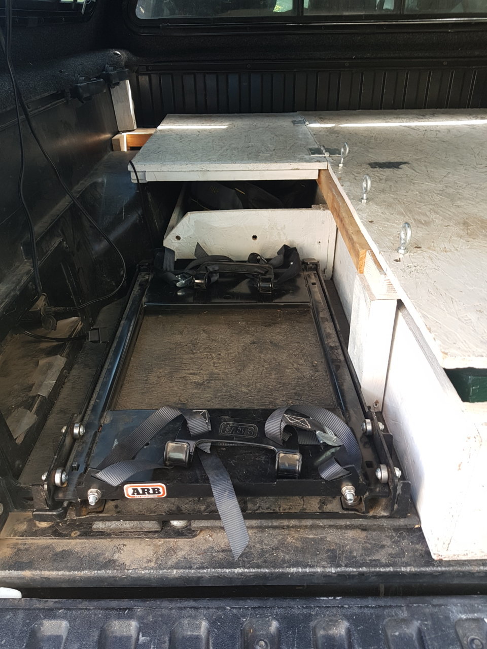

    Since many of you bolted directly to the bed I decided to do the same. The BAKflip cover actually closes firmly against the top of the fridge providing some some downward pressure but still closing all the way. I used 7 bolts total with large fender and lock washers. I used a couple of well nuts where I couldn't get a large washer to work. Dropping the spare tire made it easy to get to all the bolts. I doubt it will ever move or be an issue but I will report back if anything changes.

    Forgot to mention this in previous posts but the bolts that hold the bed to the frame have tons of extra thread that just hangs down below, inside the frame. There is plenty of room to bolt 3/4" ply or something even thicker than that on top of the bed using the factory bolts and then you're bolted to the frame. Id wager its nearly 2" you have to work with. You can see in the pics how much thread there is and how much extra room there is under the one bolt that is partially threaded in. That is 1/4" thick steel plate. This is how Four Wheel Campers mounts campers to the 2nd and 3rd gen Tacoma. I made a knockoff version of their mounts for about $100 for my last FWC and it worked like a charm, even with decently hard offroading.

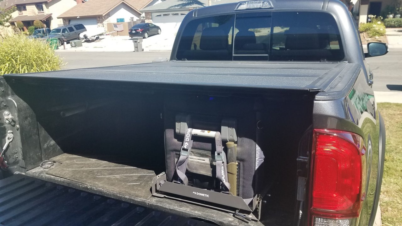

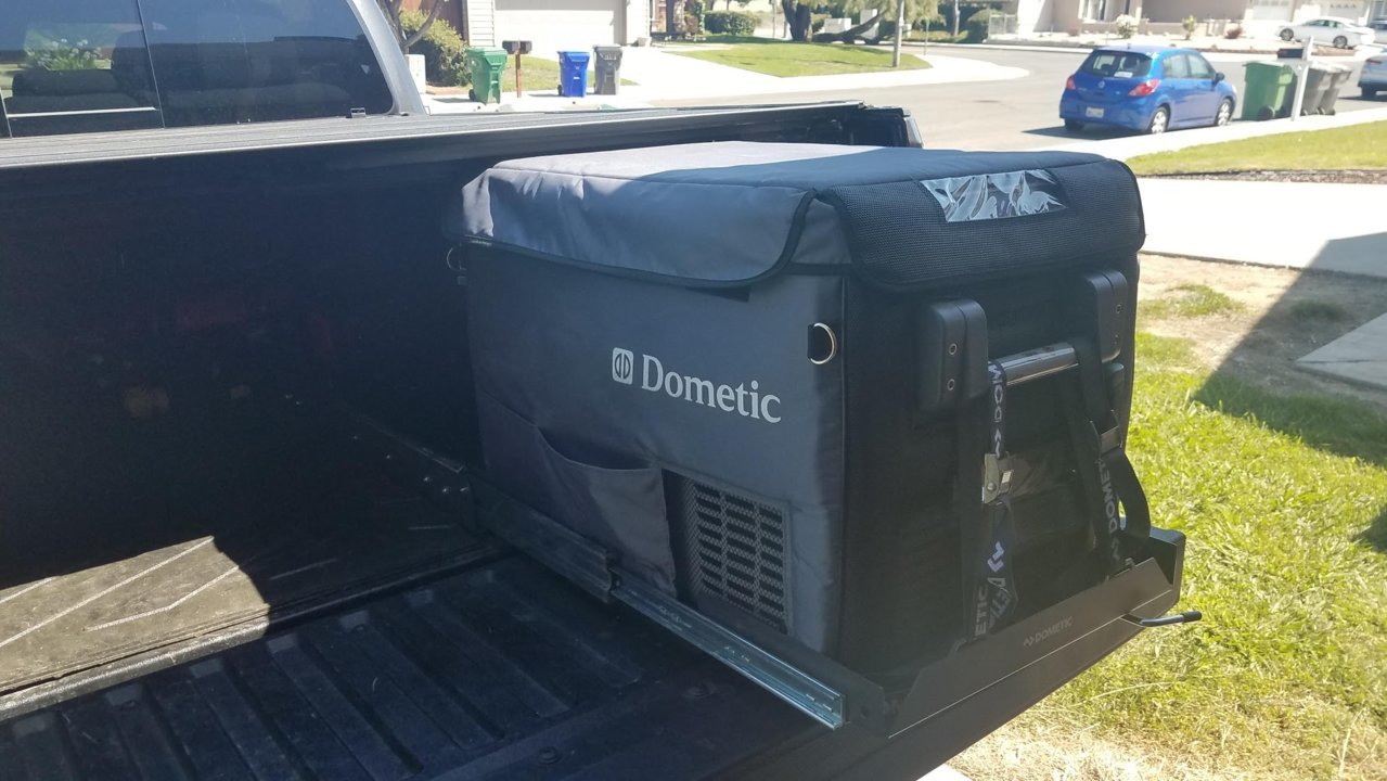

    Its an older Dometic CFX 35. it rubs with the cover all the way down. If I took the fridge cover off it probably wouldn't rub. the rubbing isn't bad enough to bother me. The backflip closes all the way and seals fine.
    0l_-5g06ddlcIKFmgJJ4LRRUAkwk_rPW3Bu0UXbs_8c470045e3b0eab18024ae28e5cb6cb03c68359d.jpg
    jyWZv_HuyfKtruk4meVRRByav6mJSFQz6ER8foTZ_5f20a036a0954e6899b34bbf9009ef16553f83cc.jpg
