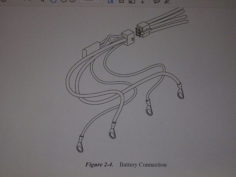

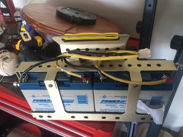

    Hey all, I have a wiring question for anyone well versed in electrical circuits and such. This is regarding a Hemacool refrigerator. Looks like this, a 2 cu ft fridge in a Hardigg case.
    So here's the deal, I bought this unit on ebay because I heard they were pretty stout and efficient if a bit big and heavy. The unit has on board 2 small 12V batteries so that it can run independently of a power source for up to 24 hours. This is the main feature I liked because it kept me from having to invest in a dual battery setup.
    The problem is that the wiring harness that connects the batteries to the fridge was missing. The part is called the "Fusible Link Assembly" in the manual. Here's a pic from the manual. I wanna make my own harness.

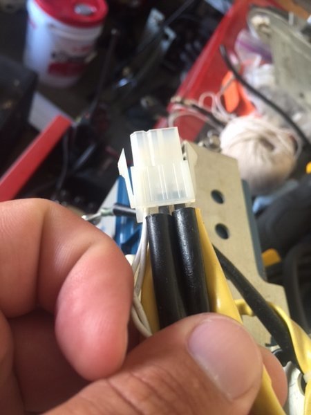

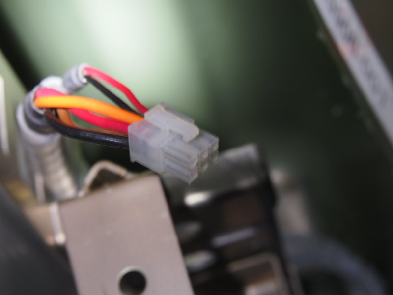

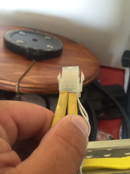

    Here's a pic of the plug on the fridge that this harness plugs into
    and some detailed pics of the plug so I can figure out wire placement. I already found the connector I need and ring terminals are no big deal.
    I'd expect the positive wires to be red and negative to be black but they all look black in the pics. That makes me think the wire is a fusible wire like this stuff.
    So the first question, Would the negative wires have to be fusible or just the positive? Instead of using fusible wire I'd like to put an ATC fuse holder inline and I don't know if the negative wires need one or not. I can guess the capacity because the manual says the unit draws 55W or less on start up. At 12V that's about 4.5A, so I'd guess a 5A fuse would be perfect.

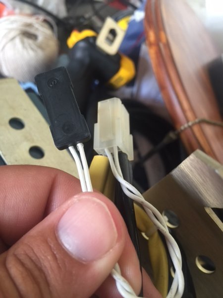

    The next mystery is this little black box. I have no idea what it's for or what it does. Anyone ever see something like it before?
    I know these are pretty specific questions, just wondering if anyone has any experience with something like this.
    Thanks for reading guys!

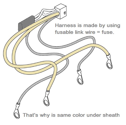

    "(3) Connect the battery power harness to the fusible link assembly (Figure 2-4)."
    Apparently the fusible link wire is on the harness going towards the batteries. No need to assemble the missing part of the harness with said wire.

    I think that black box is your fusible link. I don't think its 5A though, as thats on smaller control signal wire, not the heavy stuff moving power.
    You'll have to get a volt meter and confirm which pins have power (positive terminal), and which are ground (negative terminal). Your fuze seems to be on a separate wire, so you need to know the rating.

    I'm guessing it's a diode.
    So you are creating the harness towards the batteries, correct? If so then use the fusible wire.
    Can you trace where the pins to from the connector run to? the top ones coming from the missing black box...I see red & black.

    This: I'd wager the "little black box" is the fusible link.

    That is correct. I need to fabricate the harness from the plug in the third picture to the batteries. The plug in the third pic goes to the "motherboard" which is the main control for fridge functions. I do agree that the 2 wires going to the black box are much smaller like signal wires. According to this chart though, even a 22ga AWG wire could carry 5A.
    http://www.engineeringtoolbox.com/wire-gauges-d_419.html
    I'm curious about the diode idea.
    My original plan was to wire up the batteries with the plug just like the pictures using 16ga wire. 16 is the largest gauge the pins used with the connector will accept. Then for the black box thing I was gonna use an ATC fuse holder with a 5A fuse. Then I started second guessing myself.
    The guy who sent me the pictures asked me if I was sure the black box was a fuse. He said there were no markings on it. I assumed since the part was called "fusible link" and i couldn't see any fuses, the black box must be some kind of fuse. But if it was it would certainly be labeled somehow. Then I started thinking, "What if the wires were fusible wires?" Then what the hell is the black box?!

    Black box is likely a zener diode used for voltage regulation.

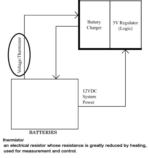

    This what I found after reading the operating manual...it's a thermistor. Maybe the unit might function without it, since there's no info on it's specifications.

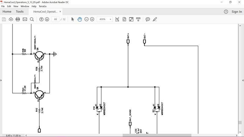

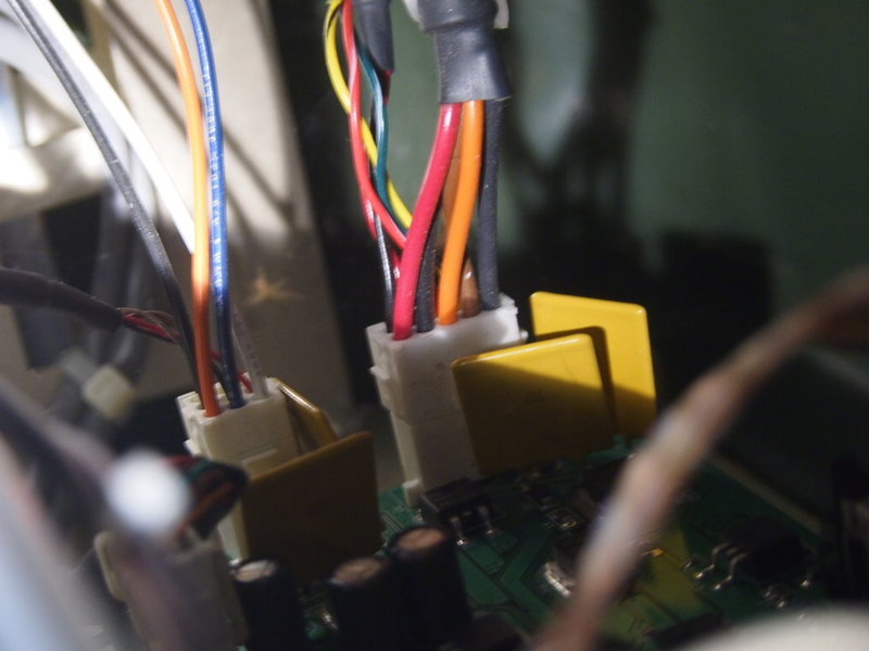

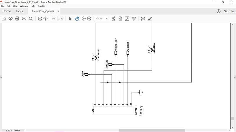

    Here's a pic of where the wires go into the motherboard
    And here's the wiring diagram zoomed into that plug
    Numbers 2, 4, 7 go to "BAT -" and numbers 1, 3, go to "BAT +"
    Battery positive wires are red and orange, number 1 and 3 on the plug. Battery negative are black and brown, numbers 2 and 4 on the plug. The small black and red signal wires going to the black box seem to be numbers 6 and 7 on the plug. Number 7 shares a ground and number 6 goes to "THERM_BAT". Perhaps a battery temp sensor.
    A google search found this that looks very similar. It sends battery temp info to whatever controls the charging circuit.
    I think I'm getting close here.
    Sandman614 likes this.

    Cool, man! I never saw that diagram in the manual I have.

    Thanks dude! The one I have doesn't have that block diagram. I wonder if that Blue Sea thing is the same thing? It's a small black thermal sensor with 2 same colored wires. It's the closest I've come so far in searching for things that look like the picture.

    Ok, so here's the thing with the thermistor; they are not all the same. There are literally THOUSANDS of different variations. Differences in the power they can dissipate, differences in the temperature/resistance curves -- and not just by a small margin. You could be looking at a 10 ohm thermistor, or a 10 MILLION ohm, or anything in between. You can also get ones that operate in opposite directions -- ones that resist more as they get hot, or ones that resist more as they get cold. Without knowing the specifications, you can't just throw in some random thing and hope that it works. BUT, you can *probably* leave it out and have the thing work. By leave it out, either have it disconnected, or connected. However, it is also possible that the circuit board is expecting a resistance that is in some RANGE, in which case, you need to replace it with an appropriate resistor.
    Note that taking this thermistor out of the circuit will leave something unprotected, which is potentially dangerous. Batteries can and do explode in the wrong conditions.

    When I do an image search for "battery temperature sensor" the blue sea part looks the most similar to the original part I'm missing. It's got 2 like colored wires and the info says it can be wired either polarity. It can be mounted to the battery box or zip tied to the battery terminal. All this is consistent with what I know about the original part. The original has 2 white wires which leads me to think that polarity doesn't matter, and it has no mounting screws. The manual says to zip tie it to the battery cage.
    Here's the page with the info.
    https://www.bluesea.com/products/1820/Battery_Temperature_Sensor_for_VSM_422
    I know going strictly on looks is probably a bad idea, but I've got little else to go on. That is until I searched for the symbol for "thermsistor" and got this
    I have this symbol on the wiring diagram here with some numbers. Anyone know what they tell me?
    The thermsistors are shown in the wires that lead to the batteries' positives at terminals 1 and 3. But the small signal wires leading to the part in question are at terminals 6 and 7.
    I should state that I'm not the best at interpreting wiring diagrams... I'll try to post up the whole thing.
